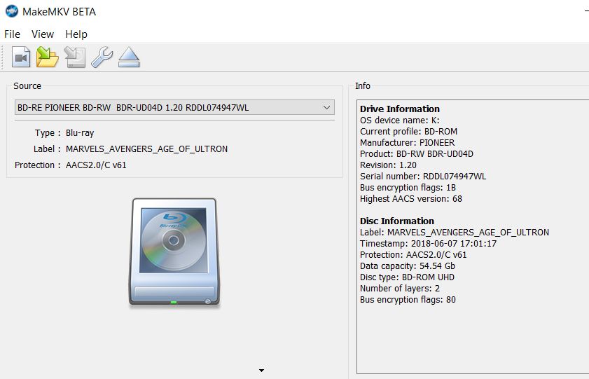

CNCisRobot wrote:
Mon Mar 20, 2023 2:13 pm
Please can someone help me I have posted 2 posts and no one has responded with help. I bought a Pioneer 4k drive BDR-UD04 with firmware 1.2 and it does not read to copy or play discs. I have seen on ebay someone selling this drive with firmware 1.14 is there a brute force flasher and bin for this version that I can flash to this drive? Otherwise it is just a slim paper weight!
Darren.
Please post a screenshot of MakeMKV when you 1st open. What country are you located in?
Asmcom :mrgreen:

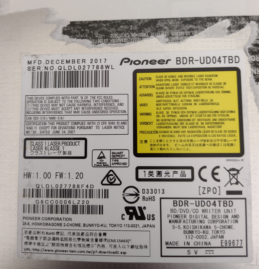

asmcom wrote:
Mon Mar 20, 2023 11:28 pm
Darren.
Asmcom :mrgreen:
I am in the UK,
Here is the screen shot you asked for, and I have dissambled the drive and it had 2 strange labels with not much information on. I pulled them off to reveal the real label and drive details. It actually states PIONEEER BDR-UD04TBD.
I was supprised at the date of manufacture 2017 considering I just purchased this drive. But I did get it from Aliexpress.....
Darren.

Somebody must have flashed it to the newest firmware. Either return it or wait patiently for a fix for the newest firmwares.
CNCisRobot
Joined: Thu Mar 09, 2023 2:41 pm
Post by CNCisRobot »
I bought it from Aliexpress so no option to return. I can wait for a fix as otherwise it is just no good for 4K.

Send it back, I feel very sorry you have been scammed and probably sold an old drive that has been flashed with the latest firmware. As a gesture of goodwill and feeling sorry for you, I will sell you a drive for £70.00, most recent model either 2022 or 2023 model in an enclosure.
I normally sell these at £119.99 on ebay. Another lesson learned, cheap is not always better.
