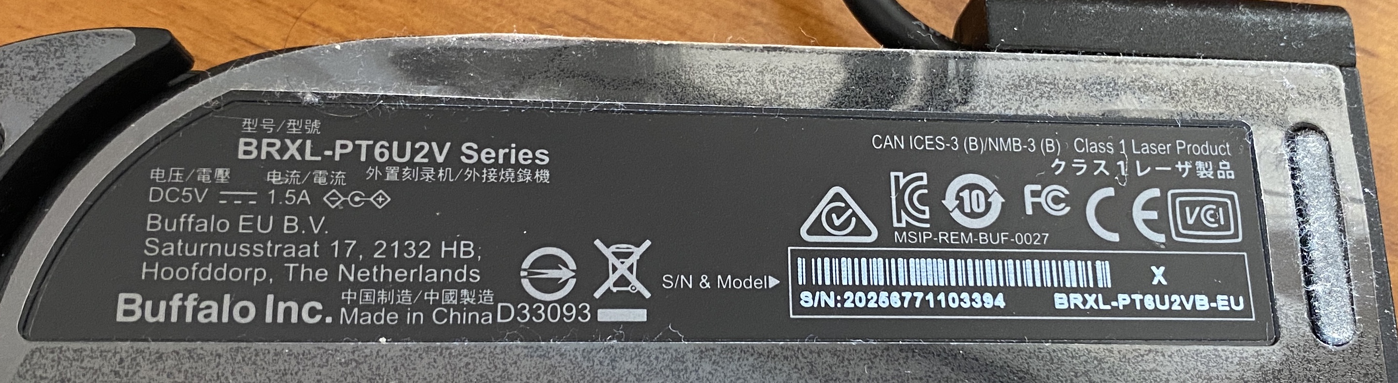

Post by bigozbear »
took a photo of the model details on its base... easier than describing it

Re: Enable LibreDrive
bigozbear wrote:
Tue Nov 19, 2019 1:41 pm
I'm not sure what actual manufacturer/model drive is inside that Buffalo enclosure.
However, from your previous post:
OS device name: /dev/rdisk9
Manufacturer: BUFFALO
Product: Optical Drive
Revision: BN10
Serial number: KZ8H92J1011
Firmware date: 2117-05-30 17:24
Bus encryption flags: 1F
Highest AACS version: 68
Since the drive platform is MT1959, you could try flashing the BU40N Buffalo BU10 firmware to the drive using the modified ASUS flasher. By using this firmware, your drive will be identified as a BUFFALO BRUHD-PU3-BK "Official" UHD drive with libredrive enabled.
Please let us know if this works for you.
Cheers.
