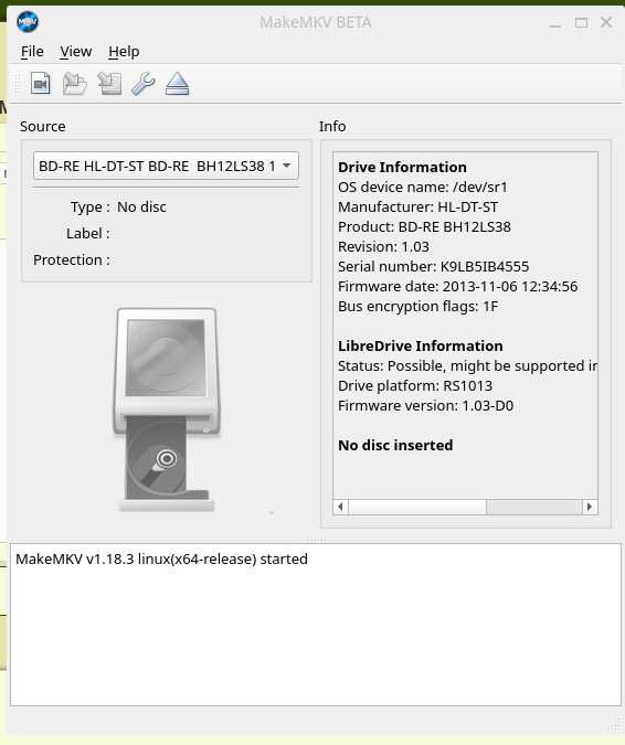

If I leave a disc out of the drive and startup MakeMKV it loads fine (Screenshot From 2026-04-20 23-11-22)

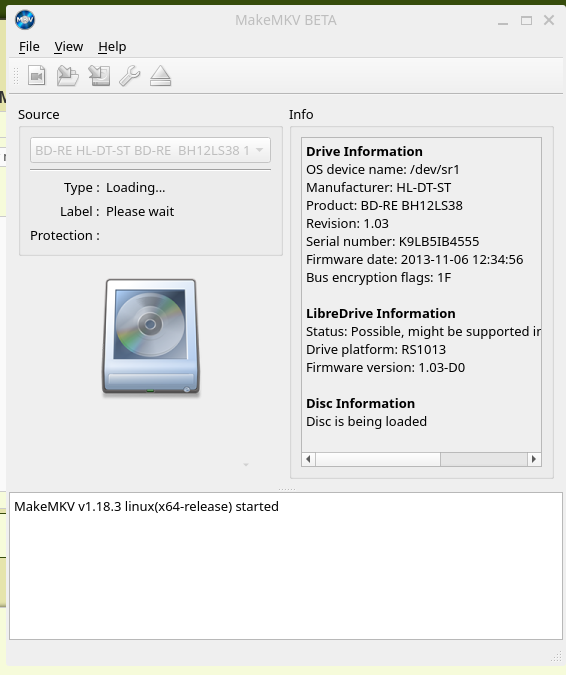

When I insert a disc it gets stuck on Disc is being loaded (Screenshot From 2026-04-20 23-12-44)
this is what I see in the log file
Debug log started at Tue Apr 21 03:29:43 2026 , written by MakeMKV v1.18.3 linux(x64-release)
001005:0000 MakeMKV v1.18.3 linux(x64-release) started
001004:0000 Debug logging enabled, log will be saved as file:///home/user/MakeMKV_log.txt
Using 768KB for read cache.
001003:0020 DEBUG: Code 0 at `BLLaJX7%0; ?J)zOB:`KC:29393631
No SDF v0a5: TSSTcorp_CDDVDW_SH-S223C_SB01_&_V___________T
SDF id v0a5: TSSTcorp_CDDVDW_SH-S223C_SB01_&_V___________T
No SDF v0a5: HL-DT-ST_BD-RE__BH12LS38_1.03_20131106123456_K9LB5IB4555
SDF id v0a5: HL-DT-ST_BD-RE__BH12LS38_1.03_20131106123456_K9LB5IB4555
SDF auto v0a5: HL-DT-ST_BD-RE__BH12LS38_1.03_20131106123456_K9LB5IB4555

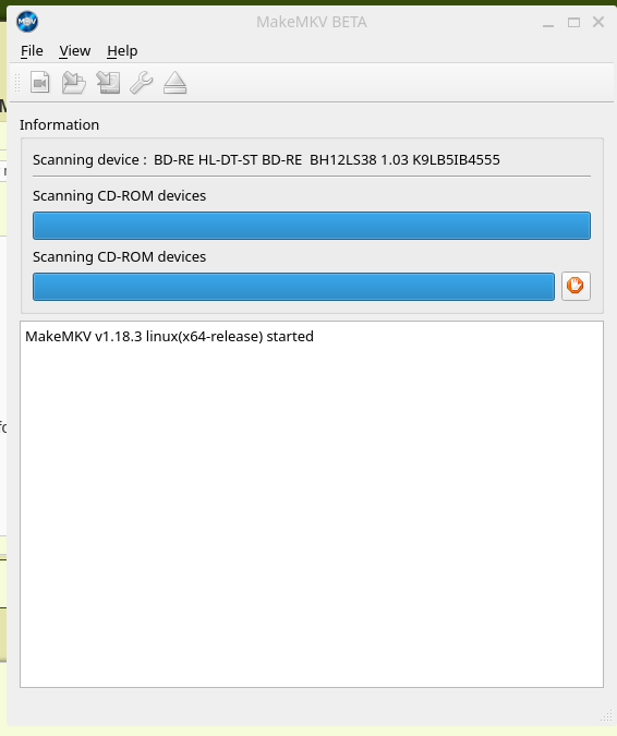

If I remove the disc close down MakeMKV, load the disc in and wait for it to mount in debian, then startup MakeMKV this is what I get (Screenshot From 2026-04-20 23-15-12)
This is what is captured in the logs
Debug log started at Tue Apr 21 03:32:13 2026 , written by MakeMKV v1.18.3 linux(x64-release)

Re: LG HL-DT-ST BD-RE BH12LS38 suddenly not working with MakeMKV
There have been reports that the latest version doesn't work or work well with non-LibreDrive. Try an older version of MakeMKV such as 1.17.7 and/or 1.17.6 and see if it makes a difference.
