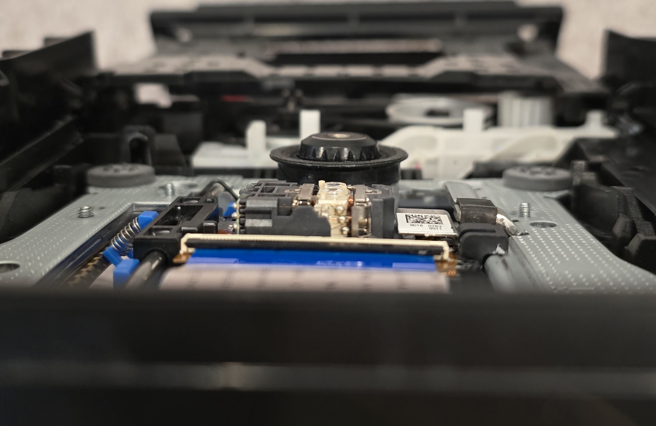

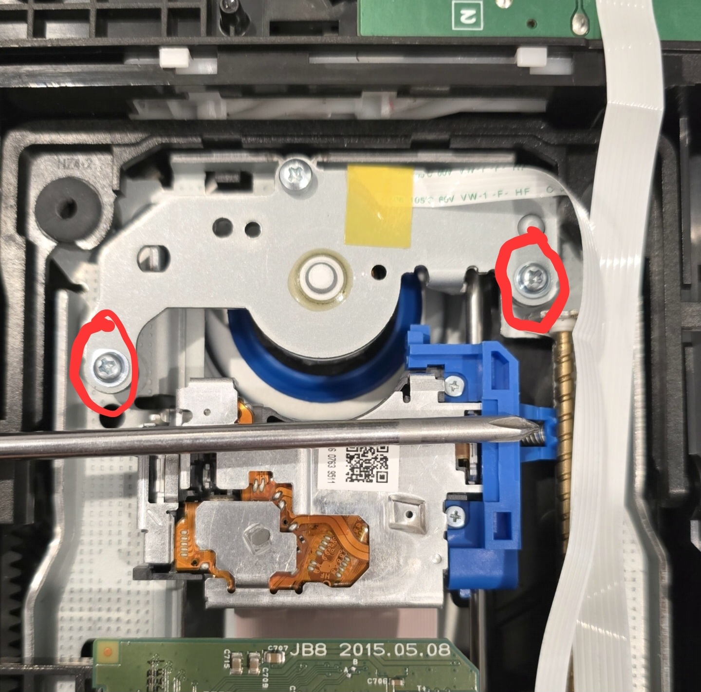

Re: "No Disc" when trying to read Blu-Rays
I bought a LG WH16NS60 off of ebay with the same issue. "No Disc" when trying to read Blu-Rays. How I fixed my issue was adjusting the height of the motor spindle mount where the discs spins on. There are two screws on both sides of the motor spindle mount. You will need to remove the bottom of the drive. Now look for the motor spindle mount. There you will see three screws. The ones to adjust are the ones on the both sides. Tighten the screws 1/4 turn and see of the blu ray is read. Keeping tightening it until the drive starts reading the blu ray. Before I forget. Used a scratched up blu ray that you don't mind scratching up. This way if you over adjust and start scrapping the disc it will not matter. Good luck.

- Posts: 5464
no this is not for adjustment im tired of seeing thisOneDay wrote: ↑Thu Mar 05, 2026 7:16 amI bought a LG WH16NS60 off of ebay with the same issue. "No Disc" when trying to read Blu-Rays. How I fixed my issue was adjusting the height of the motor spindle mount where the discs spins on. There are two screws on both sides of the motor spindle mount. You will need to remove the bottom of the drive. Now look for the motor spindle mount. There you will see three screws. The ones to adjust are the ones on the both sides. Tighten the screws 1/4 turn and see of the blu ray is read. Keeping tightening it until the drive starts reading the blu ray. Before I forget. Used a scratched up blu ray that you don't mind scratching up. This way if you over adjust and start scrapping the disc it will not matter. Good luck.
