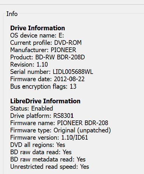

Re: Is Pioneer BDR-208D LibreDrive compatible?
Sorry to resurrect a dead thread. I have one of these drives. Is this the information needed?
Thanks,
EmVee
EmVee
