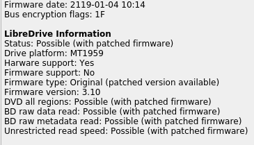

Hi, I'm trying to flash an Asus BW-16D1HT Revision 3.10 on Linux (I do not have Windows) and sdftool seems to work:
sdftool -d /dev/sr0 -i ASUS-BW-16D1HT-3.10-WM01601-211901041014.bin rawflash full,enc
Reading input file ASUS-BW-16D1HT-3.10-WM01601-211901041014.bin
Flashing flags = 0x1 : 0 0 0 1 : ---- ---- ---- BOOT
Current Drive ID: ASUS_BW-16D1HT_3.10_211901041014_<SERIAL_NUMBER>
yes
100% Operation finished
Done successfully
But when opening MakeMKV again it seems to still have the original firmware.
Screen Shot 2021-03-01 at 16.32.46.png (27.25 KiB) Viewed 9165 times
Any ideas?

The ASUS firmware is not encrypted. Don't use "enc".

Thank you sir, it wasn't clear to me when reading the various posts but that indeed did the trick!
