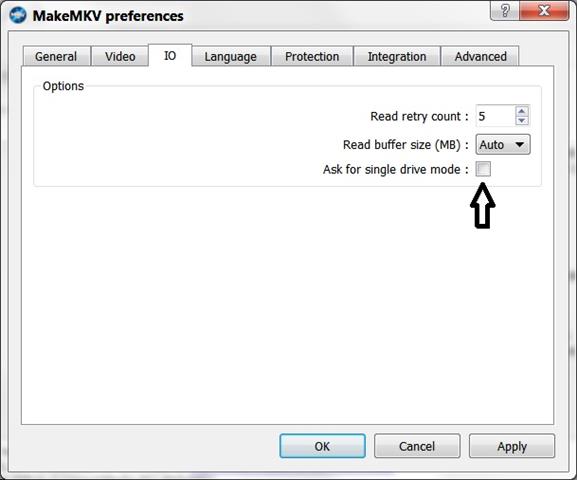

Have you tried 'single drive' mode'?
Untitled (Small).jpg (27.1 KiB) Viewed 7852 times

I use single drive mode all the time and have successfully ripped 3 discs at high speed at the same time.
Thank you so much :D , I never noticed this option. Hahaha I just made a big joke.
thanks, single drive mode does work :D
