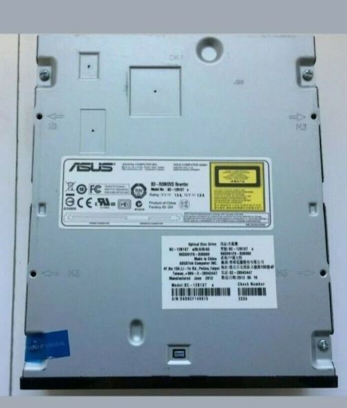

Curent rev stickers are on the top, and one is circular. These are on the bottom, and no circular sticker. Fail #1

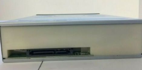

First clue this is a down rev box, current revision the plastic rear is made of black plastic, this is white. Fail #2

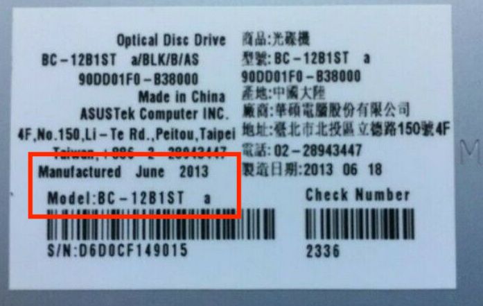

The money shot, easiest clue you'll spot is manufacturing date of year 2013, err, fail #3

Please clarify what you mean by "2014 and below"
Do you mean 2014 and newer (2014, 2015, 2016, etc.) or 2014 and older (2014, 2013, 2012, etc.)?
I have an LG WH14NS40 dated 2014-09-18.
Posts: 10903
Re: PSA: Important details to be aware of when shopping for your first drive. New pepole read this!
For UHD-capability, 2014 and earlier won't work. Even 2015 drives are unlikely to be UHD-capable unless they were made in the latter part of the year.
