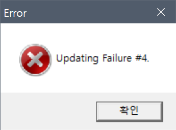

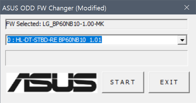

Hello.
Downgrading firmware to version 1.00 using ASUS flashing tool failed.
What should I do ?
ASUS_ODD_FW_Changer_(Modified) (24.08.2019)
HL-DT-ST-BD-RE_BP60NB10-1.00-NM00200-211711211720

Is that drive in an external enclosure? Then that might be the reason. Some enclosures don't support all necessary commands via USB.

Please try and contact Mike (mike admin) and see if he can extract 1.01 from your drive. If he is able to extract it, he will be able to make a MK firmware.

I Use USB external ODD
Posts: 4503
Re: BP60NB10 Firmware Downgrade Error
I guess your enclosure doesn't support the necessary command via USB. If you can take it out and attach it directly to the SATA port of yor PC it will most likely work to flash it.
After that you can put it back into the enclosure and you are all set.

I just picked up one of these drives. MakeMKV recognizes the disk title but, when I try to open the drive, I get a LOT of "Key Exchange" errors and eventually get the error "LibreDrive compatible drive is required to open this disc - video can't be decrypted." Apparently the 1.01 firmware on this drive needs to be downgraded.
When I use the ASUS tool to downgrade from the 1.01 firmware to the 1.0 firmware, I receive the error "Updating error #5".
What's needed to allow this drive to rip a UHD disk?

The software file I downloaded was "ASUS_ODD_FW_Changer_(Modified) (24.08.2019).zip"
The Firmware file I downloaded was "Hybrid_Firmware_for_BP50NB40_to_BP60NB10.zip"
I used the firmware file "DE_LG_BP60NB10_1.00_MK_HBD.bin"

Those with 1.01 cannot currently be downgraded. Please contact mike admin and see if he can extract a copy of the firmware from your drive.
