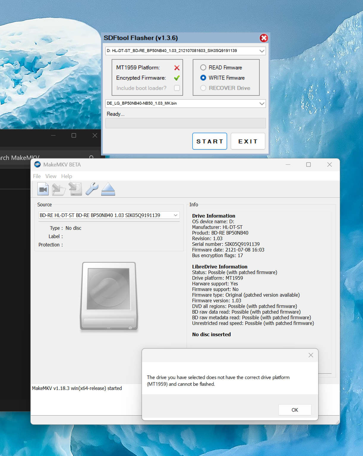

Why am I getting this error? How can I resolve this?
Screenshot 2026-04-01 005015.png (1.14 MiB) Viewed 5532 times
Posts: 4890
Re: SDFtool Flasher
mfann6619 wrote:
Wed Apr 01, 2026 4:52 am
Are you using a real windows 11 64 bit PC or some sort of VM?
I am on a real Windows 11 64 bit PC. A Minisforum MS-01.
Posts: 4890
Re: SDFtool Flasher
mfann6619 wrote:
Wed Apr 01, 2026 11:25 pm
MartyMcNuts wrote:
Wed Apr 01, 2026 10:37 pm

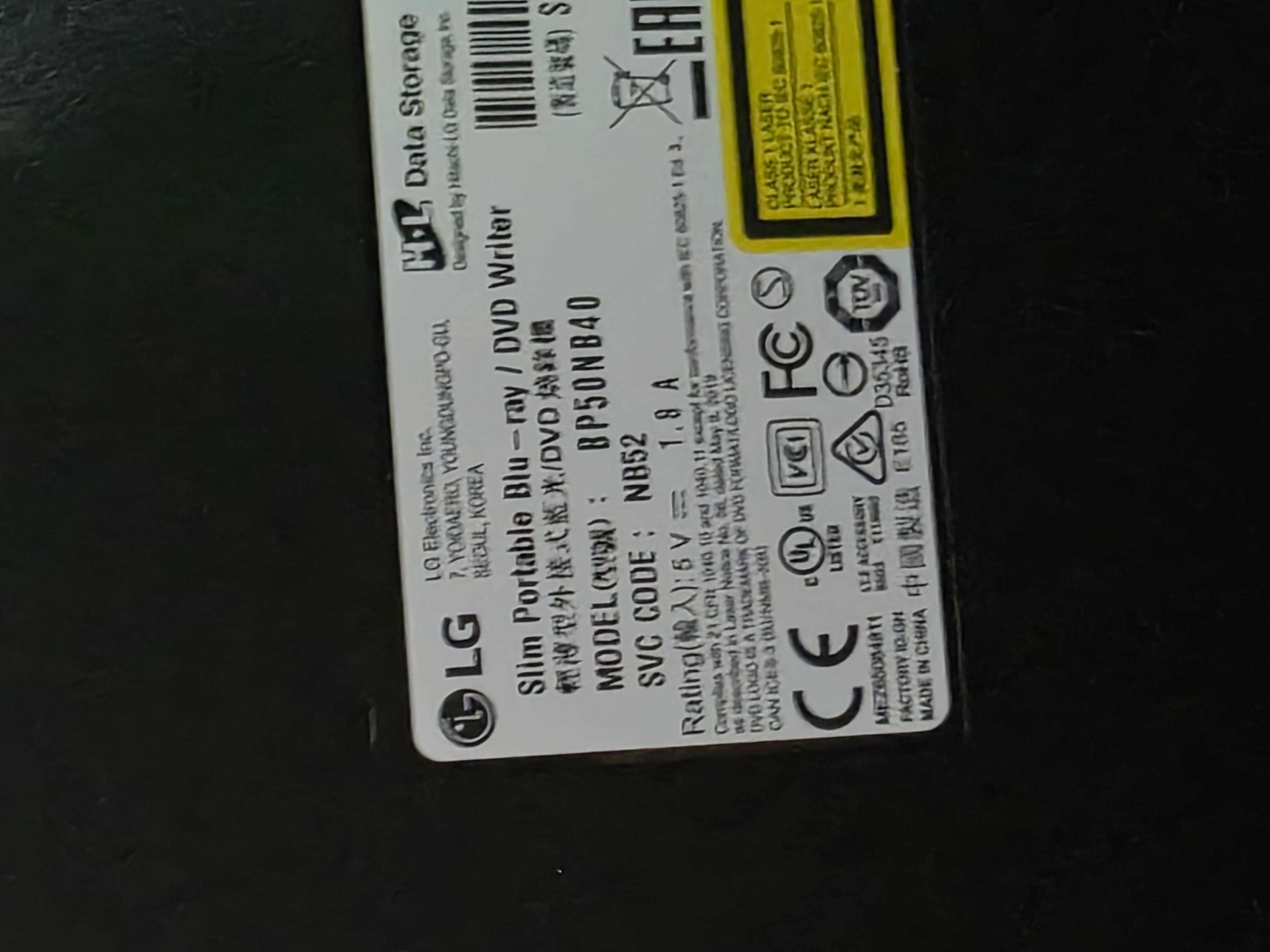

What is the SVC code of your drive? It will be written on the label on the side of the box and also underneath the drive. If it is SVC NB72, it is not compatible.
It is SVC NB52.

run the flasher as admin
some windows 11 pcs hide drive info from stuff
seen this with the pioneer flasher

Still no good.
