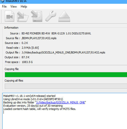

I have to be quick to "Catch" anything, as I get the BSoD when it says it is copying files, 1/2 way thru..

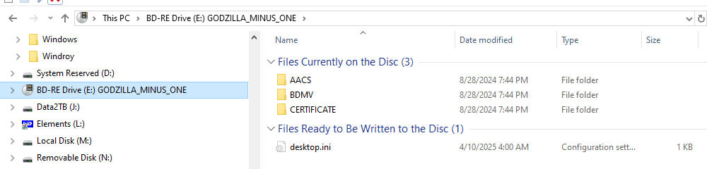

GODz drive info.jpg (42.82 KiB) Viewed 14151 times

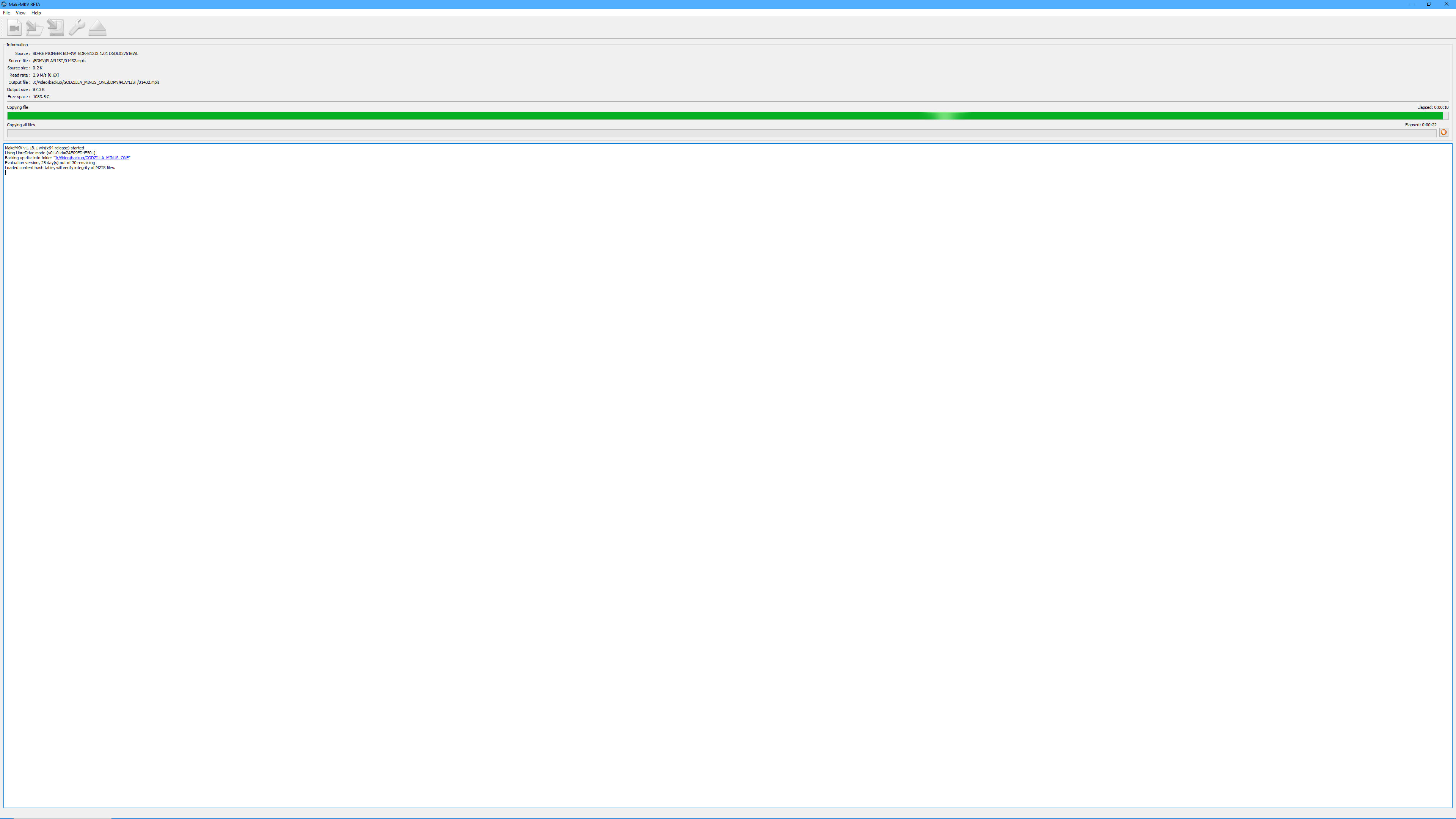

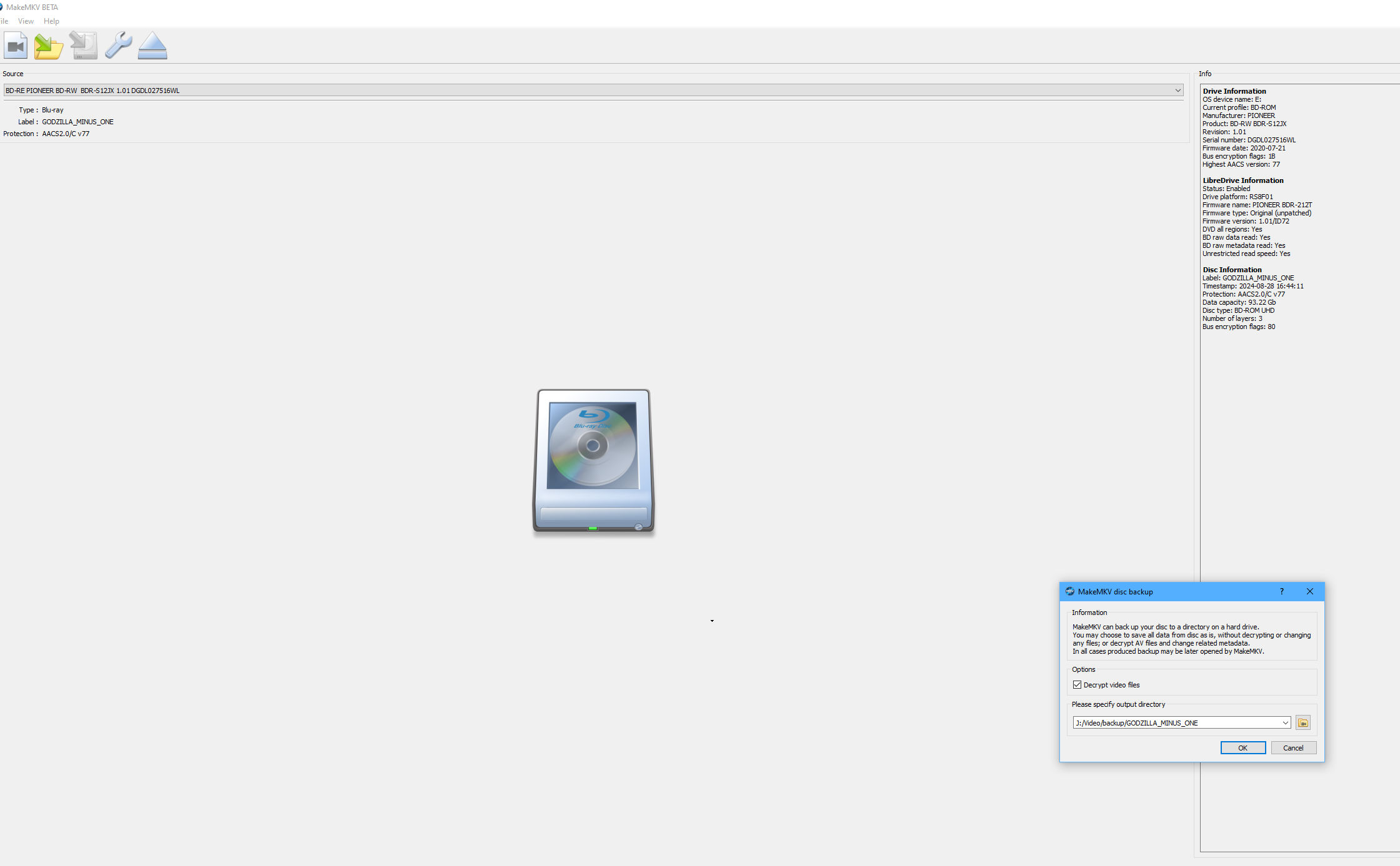

I had to "Capture" this, and within seconds (saying it is copying, and after it Decrypts..) I get the BSoD, and the computer restarts. On the full screen, if You can't see, it says Elapsed 10sec. and on the bottom bar, 22sec
MKV Godz Back Up bef BSoD Info1.jpg (52.21 KiB) Viewed 14145 times
MKV Godz Back Up bef BSoD Info.jpg (225.36 KiB) Viewed 14145 times

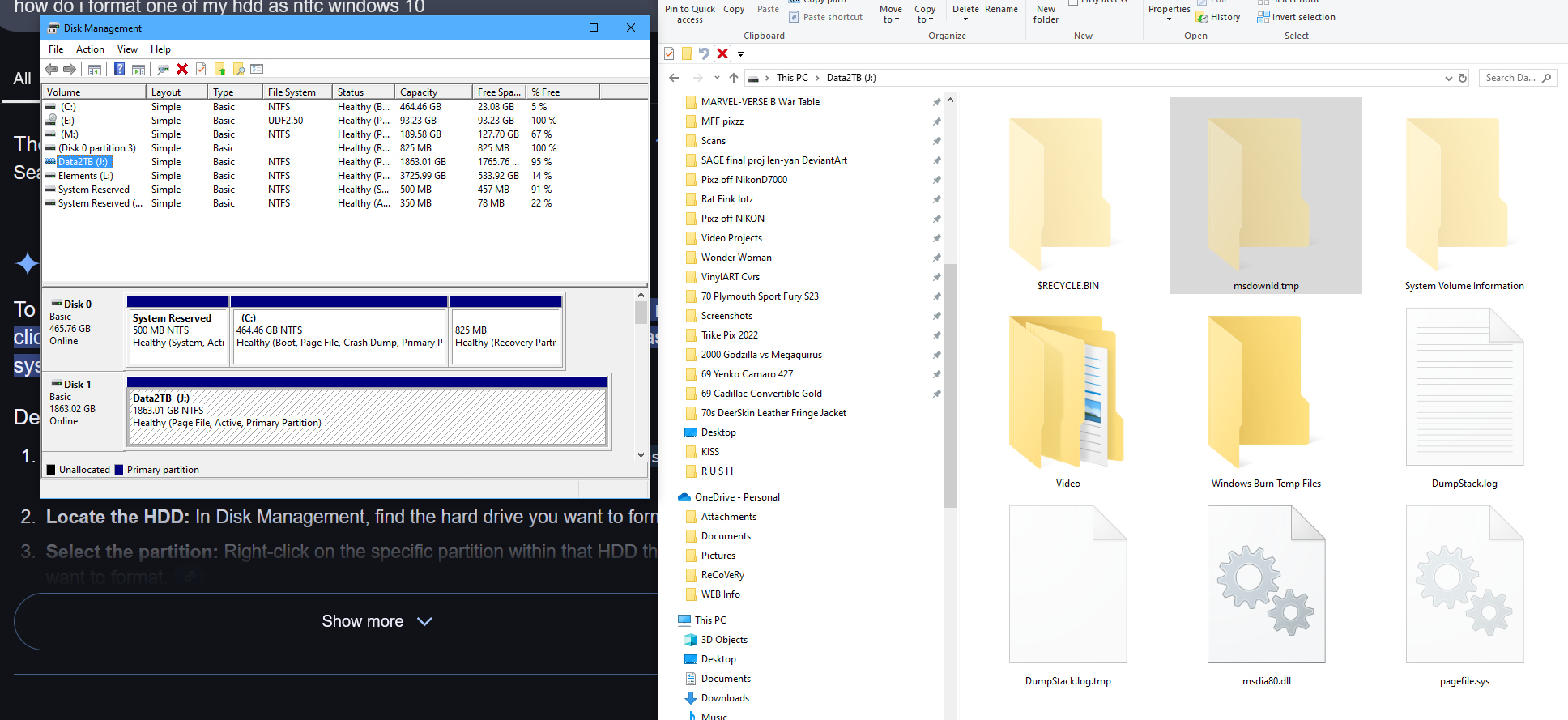

I killed All that is on my "J:" drive, and looks to already be formatted as NTFC (would I still need to Format?), so What/Why am I Still getting the BSOD this time, when I opened up MKV, it completed the Decrypt/Copying, and as soon as I tagged the MakeMKV button, screen went all 'KaBLUEy' on me!?
H E L P > >
J drive is NTFC.jpg (652.58 KiB) Viewed 14101 times

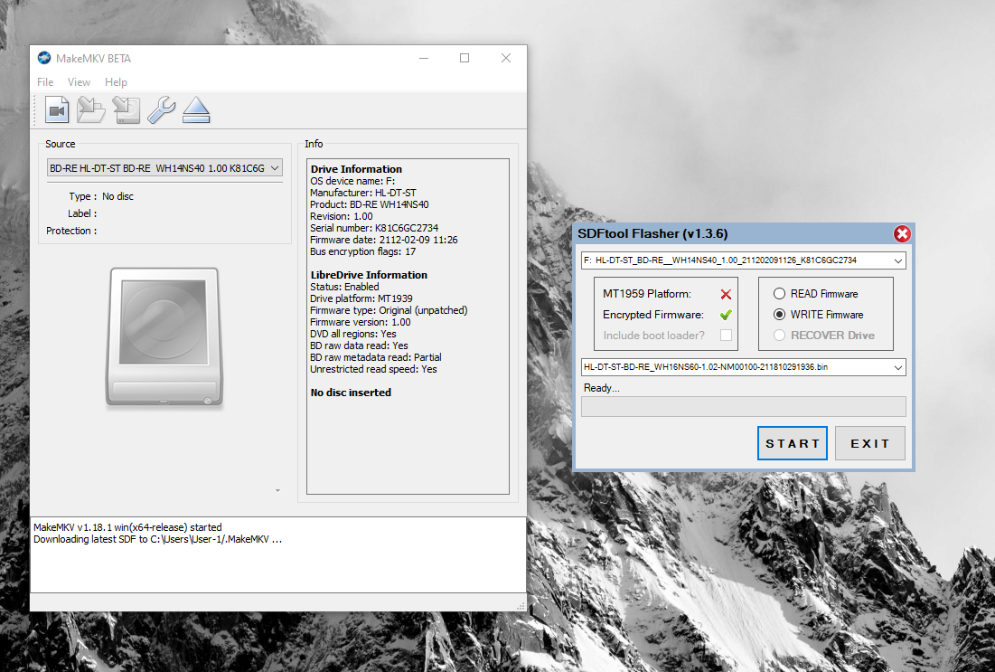

Hoping that I can pick someones brain as I've just purchased an LG WH14NS40 - checked on MakeMKV that it's MT1939 which it is, but when using the tool, it states that it isn't a MT1939 platform, see screenshot below, any ideas on the best way to get around this to get the correct firmware on it?
Drive Info.png (445.21 KiB) Viewed 12884 times
Any help will be greatly helpful!
If you look at the Ultimate UHD Drives Flashing Guide you'll notice right at the top is says your drive platform needs to be MT1959. SDFtool Flasher isn't flashing your drive because it is NOT the MT1959 platform; it is saving your from yourself. If you do flash your drive, you'll brick it and it'll be unusable.
