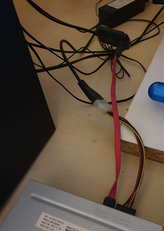

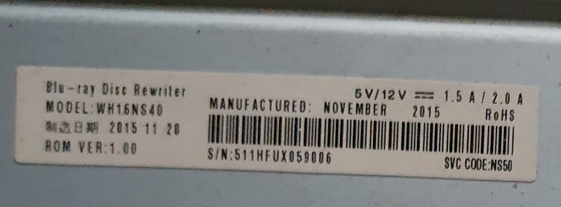

Hello guys, i need some help.
I have an LG Blu-Ray Disc Re Writer WH16NS40 SVC: NS50
I was with the firmware 1.00, from the LG website, i download the F 1.03 and after i did the update, the problems started.
So, after the updated, the LG didn't read originals BluRays.
A non original CD yes, a non Original DVD yes.
Then i found your video and try to downgrade to the 1.02 firmware.
No still read a regular CD, but nothing else, and after i try to put a DVD or BR the LG just stops working and i need to reset my PC.
I try to use this:
"NS40 Recovery Image:
Flashed an NS50 firmware to an NS40 drive and can no longer read disks this IMG has all the NS40 FW you need to recover your drive just follow my dos flash video guide linked above"
But i can't do the first step ( i boot with the USB Drive but when i open the first tool dosn't work, i read in the info that it's means that my driver is not instaled good or somthing like that) so i don't know what to do.
If it helps, this is how i use my LG (when i bougth my new NZXT Source 340 Matte Black Razer Edition i didn't see that is no space for the LG :( ) so i use like this (i don't know if is a problem or not really)
So, someone can help me?
What can i do to recover my LG?
Thanks from the Help :-)

Post by omk1980 »
jonghotti wrote:
Wed May 13, 2020 6:26 pm
Yes if you've got room for a 9.5mm drive the BU40N will work for you. Feel free to drop me a line if you'd like one my info is the link in my signature. Thank you!
very cool. I've also got a windows laptop that has a 12.5mm blu-ray drive. Are any of the supported UHD drives compatible for a 12.5mm bay in a laptop?
