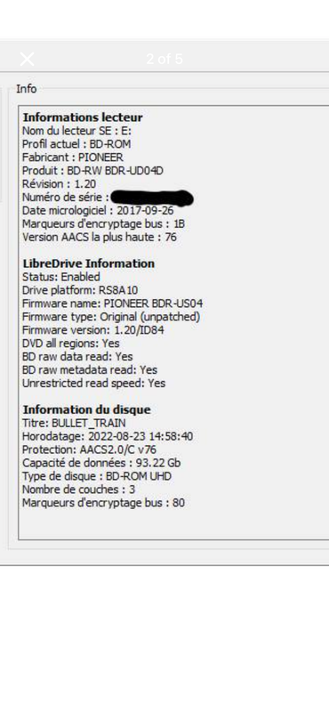

is there a patched firmware around for the Pioneer UD04 to make it fully libredrive compatible?
Manufacturer: PIONEER
Product: BD-RW BDR-UD04
Revision: 1.14
Serial number: DHDL158984WL
Firmware date: 2020-06-15
Highest AACS version: 82
Drive platform: RS8A10
Firmware version: 1.14
Unrestricted read speed: Yes-
- Posts: 5450
Should work as iswhswede wrote: ↑Thu Dec 18, 2025 8:16 pmis there a patched firmware around for the Pioneer UD04 to make it fully libredrive compatible?Code: Select all
