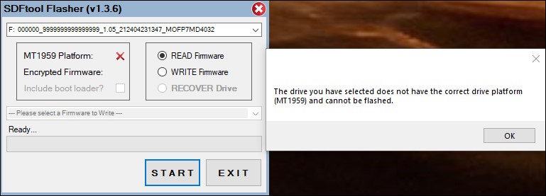

First time trying this with a UHD drive (my old bluray still works like a champ)
The PC looks like it recognises discs ok, but in MakeMKV it doesn't look right.
It sees the drive as:
OS device name: F:
Manufacturer: 000000
Product: 9999999999999999
Revision: 1.05
Serial number: MOFP7MD4032
Highest AACS version: 81
The drive label says : Hitachi-LG BU40N
Manufactured: July 2025
Firmware Version 1.05
The SDFTool pops up an error when I tried to backup the fimware:
"The drive you have selected does not have the correct drive platform (MT 1959) and cannot be flashed"
Screenshot 2025-12-06 211101.jpg (46.29 KiB) Viewed 8837 times
Would I be right in thinking the problem is the cable I'm got for it?
It's SATA > USB
Drive: https://www.amazon.co.uk/dp/B071CPRK74
Cable: https://www.amazon.co.uk/dp/B073QNN1C5
Posts: 5498
Re: SDFtool Flasher
callumw wrote:
Sat Dec 06, 2025 9:12 pm
OS device name: F:
Revision: 1.05
It's SATA > USB
Your case is junk get a recommend adapter from the guide below and a sata to slim sata adapter and it will work

callumw
Joined: Thu Aug 07, 2025 10:34 am
Re: SDFtool Flasher
Post by callumw »
Returned the drive and replaced it with a Verbatim 43888 ( https://www.amazon.co.uk/dp/B07MTP9VKX )
Much much nicer drive and comes with the cables and adapter options.
Easy firmware backup then install of DE_LG_BU40N_1.03_MK.bin
Currently testing with our Apollo11 UHD disk and it's doing its thing.
Thanks @Billycar11 for the nudge in the right direction

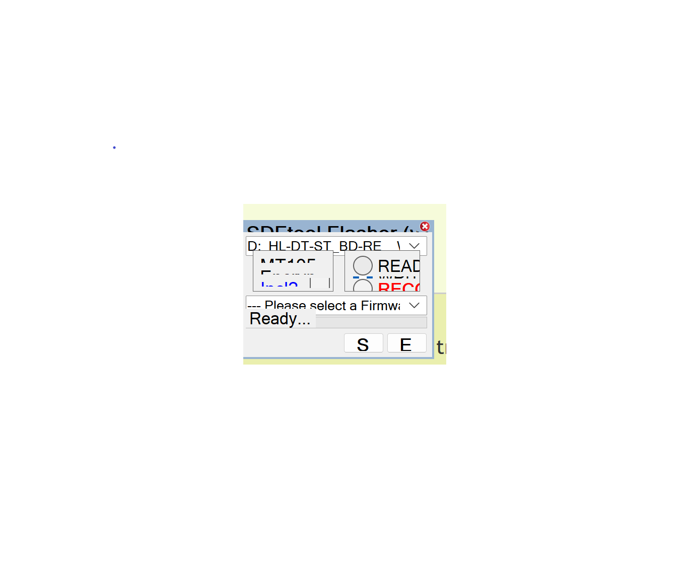

I downloaded the sdftool flasher for my PC to try and use it for my Blu-Ray player, but when I open the tool, the box opens like this and I can't resize it to use it I have a Windows 11 PC.
sdftool weird size.png (22.05 KiB) Viewed 8464 times
blind-s33r
Posts: 28
Joined: Thu Jul 25, 2019 1:29 am
Re: SDFtool Flasher
Post by blind-s33r »
RFAurora wrote:
Wed Dec 10, 2025 12:51 am
Cough
NOTE: If the GUI looks a bit deformed (happens on a 4k monitor), you can right click the exe and select properties. In the compatibility tab, click "Change high DPI settings" then under "High DPI scaling override" tick the box and select "System (Enhanced)" in the dropbox.
Cough
RFAurora
Posts: 10
Joined: Wed Jan 06, 2021 5:53 pm
Re: SDFtool Flasher
Post by RFAurora »
blind-s33r wrote:
Wed Dec 10, 2025 1:11 am
Cough
Cough
Thank you.
