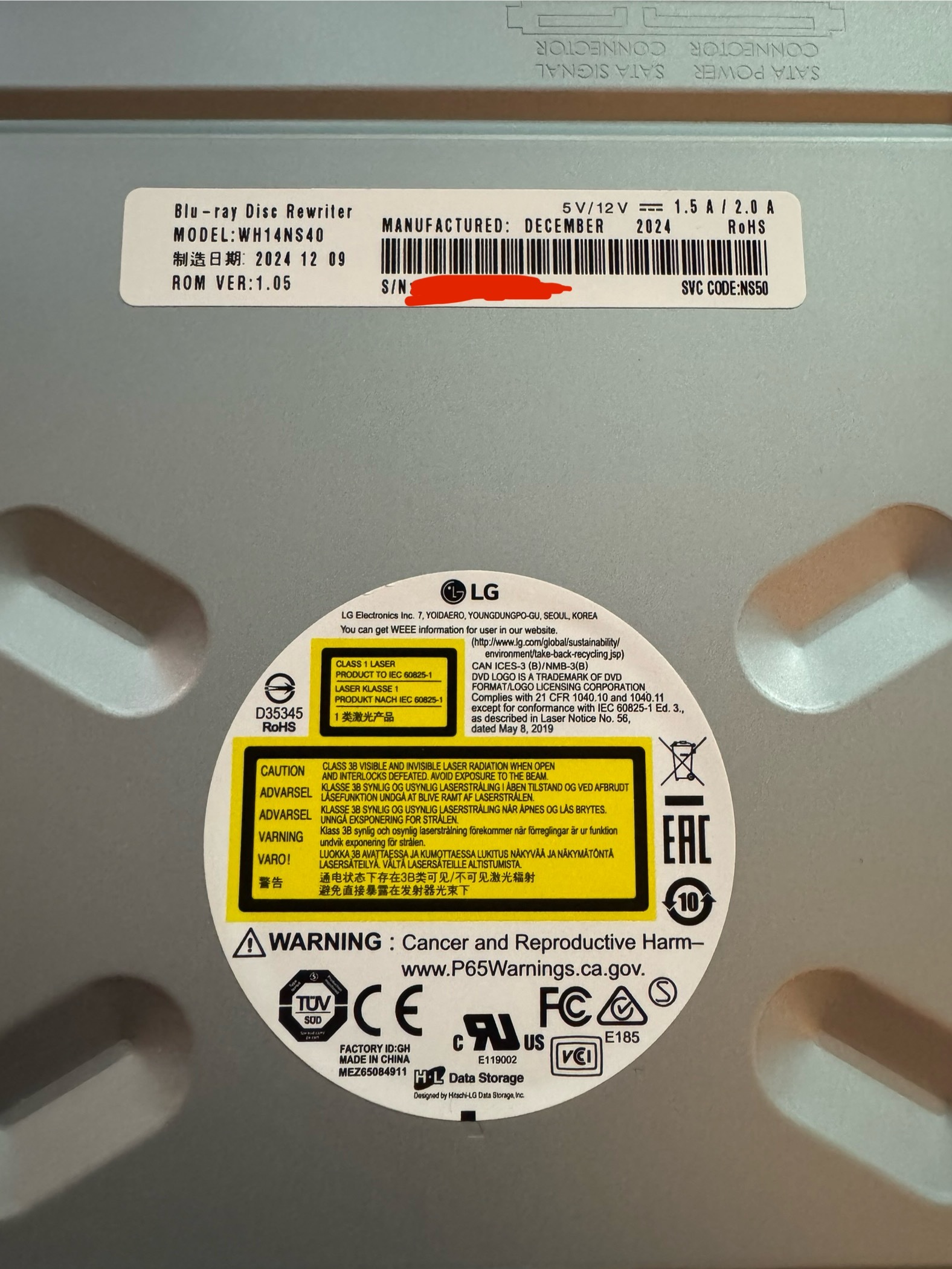

Been using this drive with stock firmware for a little bit. I didn't have any issues with rips and it didn't seem to slow so flashing firmware felt unnecessary. Well, I finally hit a movie that won't rip - I think it has to do with region locking?
As far as I can tell this drive is okay to flash but would like someone smarter than me to verify.
Manufacture date looks good, SVC code is NS50. The one thing I wasn't sure about is the drive platform, but maybe I'm just misunderstanding that line in the guide, "2. Drive Platform MT1959<Most important in makemkv" viewtopic.php?f=16&t=19634
Any tips for flashing would be appreciated too!
Below is the drive info from MKV and a picture of the label on the drive.
Thank you!

Per the 1st post of the Ultimate UHD Drives Flashing Guide Updated 2025:
(HL-DT-ST-BD-RE_WH16NS60-1.02-NM00100-211810291936.bin)
Current v1.05 FW is encrypted. Use the SDFtool Flasher.
That said, knowing the type of disc & how it failed (log output) would go a long way to determining the issue.
