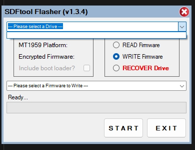

I am new user of SDF tool. I had succeed to flash my SATA BD drive LG BH16NS55 with ASUS flasher.
I tried to flash my USB drive BP60NB10 with it, but it failed.
After I am trying tout it seems that cannot find USB drive.
It cannot show both of BD drive, SATA nor USB.
What did I missing?
Thank you.
not found drive
not found drive
not found drv.jpg (57.42 KiB) Viewed 17263 times
Posts: 4757
Re: SDFtool Flasher
dooyoung wrote:
Wed Nov 09, 2022 9:20 pm
What did I missing?
Thank you.
Do you have MakeMKV installed in the default location (C:\Program Files (x86)\MakeMKV)?
