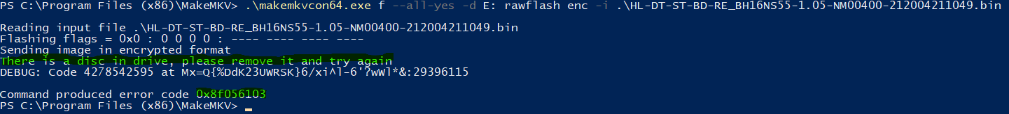

I got the same error with SDFTool 1.2.3 and didn't know how to proceed.SteelBookCollector wrote: Fri Aug 20, 2021 1:47 pm Got a brand new WH16NS40 with 1.05 Firmware.
SDFTool v1.2.0, trying to flash to WH16NS60 v1.02 from the old folder, check the enc box.
Getting error code 0x8f056103
On Windows 10 X64. dotNet newer then 4.7.2
What am I doing wrong?
Since the SDFTool is just a wrapper for the commandline utility, i dared to execute the command in the PowerShell like in 'ye olden days'.
Turns out I get the same error, but with a better description:
You need to remove any disc in the drive before flashing firmware!

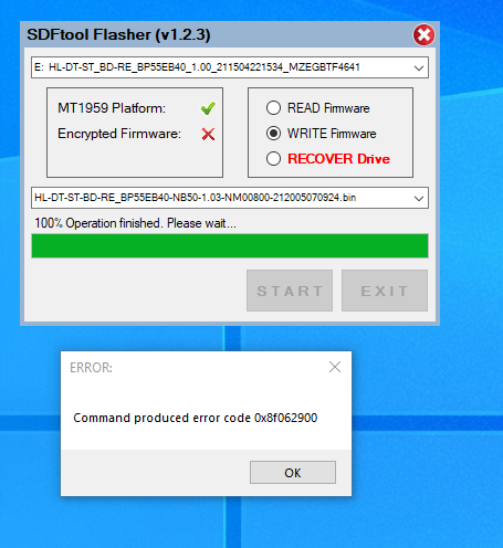

nearly same here:boiledsnowman wrote: Fri Nov 26, 2021 9:08 pm Hello! I acquired a BP50NB40 that's been sitting in someone's closet for a while, and long story short, I didn't realize it was an older revision. It has the SVC code NB40, not NB50. So despite the fact that it was on 1.00 firmware (which I did dump before doing anything, and I have that file still), after flashing, it no longer functions. (I was wanting to get UHD support). When I press the eject button, the LED flashes a bunch but then nothing happens. Tried unplugging/replugging, same deal, it looks like I have a dead drive. I tried using the RECOVER option to go back to the file I dumped, but it doesn't seem to do anything. It "finishes" instantly and the behavior of the drive stays the same.Code: Select all
DE_LG_BP60NB10_1.00_MK_HBD.bin
Is there anything I can do? Thanks!
tried to flash an BP55EB40 SVC: EB40 1.00 from November 2016
as there is no EB40 firmware, i tried the NB50 1.03 like i read in another thread:
it seems to have worked out (100% finished), allthough i got the error 0x8f062900 (only at this very first attempt) But now i have similar problems:PeterRatgen wrote: Sat May 16, 2020 8:09 am One last update. I flashed the BP60NB10 1.00 Hybrid firmware to my BP55EB40 SVC: EB40 running the LG BP50NB40-NB50 1.02-MK. This made the drive UHD Friendly! I couldn't be more happy! All the firmware and the ASUS flasher used i found at: https://makemkv.com/forum/viewtopic.php?f=16&t=18933.
eject button on drive, softeject from windows or makemkv only produces led flashing and animation in makemkv but the drive doesn't open
opened with a pin manually it will not recognise or play any dvd,bd or uhd
i tried different other 20200720-firmwares, "old" ones and recoveries but nothing solved the problem so far (allways flashing without any errors/problems)
current version:
OS device name: E:
Product: BD-RE BP60NB10
Revision: 1.02
Serial number: MZEGBTF4641
Firmware date: 2120-05-07 09:35
Highest AACS version: 68
Firmware version: 1.02
No disc inserted-

Yes, it helps if you read the instructions! This is clearly mentioned in the first post.epipremnum wrote: Tue Nov 30, 2021 4:16 pmI got the same error with SDFTool 1.2.3 and didn't know how to proceed.SteelBookCollector wrote: Fri Aug 20, 2021 1:47 pm Got a brand new WH16NS40 with 1.05 Firmware.

Oh gosh it really does..MartyMcNuts wrote: Thu Dec 02, 2021 3:09 amYes, it helps if you read the instructions! This is clearly mentioned in the first post.epipremnum wrote: Tue Nov 30, 2021 4:16 pmI got the same error with SDFTool 1.2.3 and didn't know how to proceed.SteelBookCollector wrote: Fri Aug 20, 2021 1:47 pm Got a brand new WH16NS40 with 1.05 Firmware.
I must have skipped it twice!
I feel dumb now, but maybe it helps anyone still..

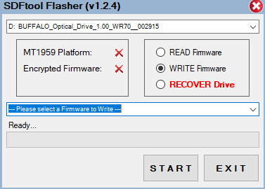

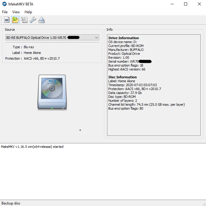

New user, first post - I recently bought a UHD blu ray disc so I can watch it on my external Blu-ray drive and this where the rabbit hole started. The UHD disc was not recognised.
The device is Buffalo BRXL-PT6U2VB-US which supposedly can read and write BDXL discs. I tried to read as much information on the forum as possible and found other people with similar drives have success to make it possible to read UHD discs but this hasn't been the case for me.
Looking at Make MKV this is what I see:
No mention of Libre and the Revision: 1.00 seems odd (as in - I didn't find posts on the forum with the same revision
Further more opening SDFTool Flasher I am greeting with the bad news that the device is not on the MT1959 platform:
And this where my brain is getting contradictory thoughts - how can it be that the drive is listed as supporting BDXL (triple and quad layer) and not be able to read UHD movie discs?

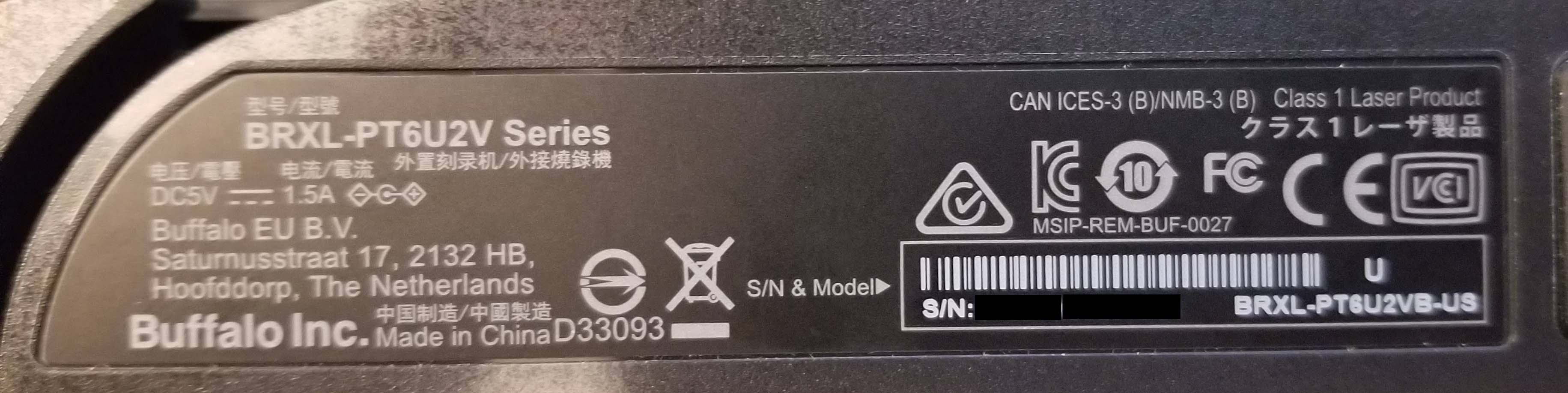

Here's a photo of the label on the back of the drive:
Would you say that I have a chance of making this drive being able to read and play UHD discs or is this just a wishful thinking on my side?

BDXL capability does not automatically mean UHD readability. There are a lot of other drives that can read/write BDXL that can't read UHD.freespace wrote: Sun Dec 19, 2021 4:59 am New user, first post - I recently bought a UHD blu ray disc so I can watch it on my external Blu-ray drive and this where the rabbit hole started. The UHD disc was not recognised.
No mention of Libre and the Revision: 1.00 seems odd (as in - I didn't find posts on the forum with the same revision)
P.S. apologies if I messed up the correct place to ask this question - feel free to point/push/throw me in the proper area.
A couple of questions for you...
1. How old is your drive?
2. Are you able to open it up and see what the actual drive model is?

sadly there are 2 versions of that drive and this is why i left it out of the guide the eu version is not a BU40N and cant do UHD only the US version can another case of same model number different drivefreespace wrote: Sun Dec 19, 2021 4:59 am New user, first post - I recently bought a UHD blu ray disc so I can watch it on my external Blu-ray drive and this where the rabbit hole started. The UHD disc was not recognised.

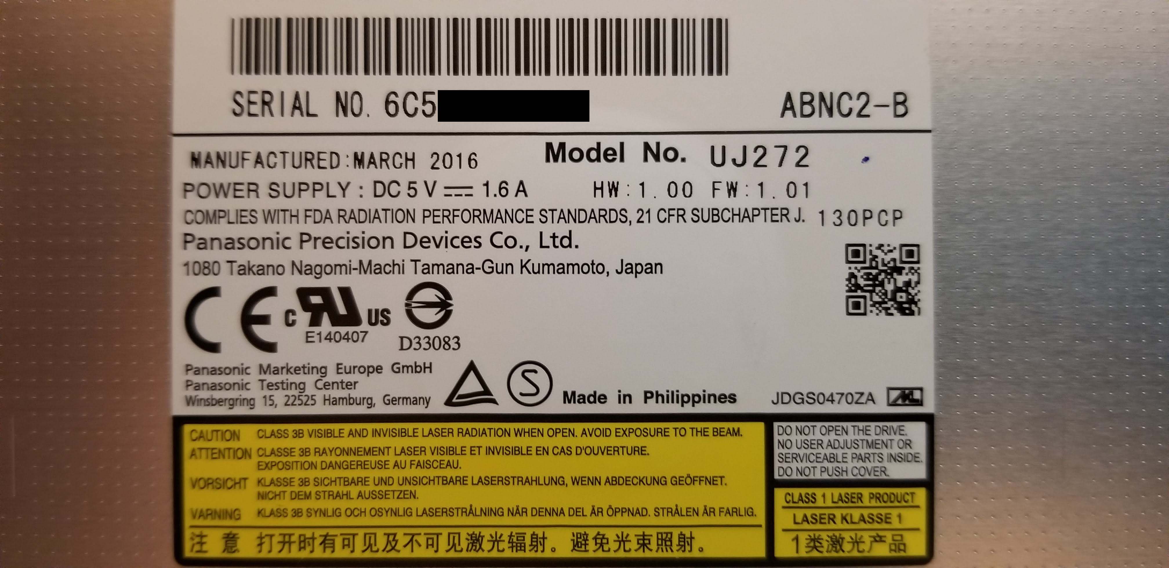

@MartyMcNuts - here's a photo of the drive inside the enclosure. According to the label it is manufactured March 2016. Does the photo gives you more insight? I don't see a reference to LG nowhere - only to Panasonic.
@Billycar11 - according the photo of the external enclosure this is a US drive (which makes sense since I bought it on the other side of the pond - in Canada).
- Posts: 4918
Re: SDFtool Flasher
Yeah, out of luck with this drive. It's a Panasonic.freespace wrote: Sun Dec 19, 2021 11:35 pm @MartyMcNuts - here's a photo of the drive inside the enclosure. According to the label it is manufactured March 2016. Does the photo gives you more insight? I don't see a reference to LG nowhere - only to Panasonic.
