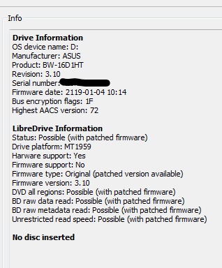

As a follow-up to my questions, I was going to do the Asus first. Here's the MKV info. Do I need to check the enc box?
- ASUS.jpg (171.37 KiB) Viewed 27782 times

Ok, so I went back through the pages and got the answer to my question about enc (I figured it was in there and I missed it), and so took the plunge and it seems to have worked perfect. I'm testing it now.
You guys are awesome, by the way.

So, silly question time ... I used the SDF tool to install the Asus 16D1 MK Firmware. It took less than 20 seconds to load, and I've already ripped 2 4K discs. Do I still need to "side load" something else? I'm always "cautious" when it comes to upgrading/downgrading firmware . . . it's one of those you kinda look away and clench press the "go" button. Tomorrow I'll probably do the same for the LG drive.
- Posts: 5796
Re: Ultimate UHD Drives Flashing Guide Updated 2021
you should be good thats the point of the guide as few steps as possible to get to a firmware that works with makemkvdlharper007 wrote: ↑Tue Apr 13, 2021 1:14 amSo, silly question time ... I used the SDF tool to install the Asus 16D1 MK Firmware. It took less than 20 seconds to load, and I've already ripped 2 4K discs. Do I still need to "side load" something else? I'm always "cautious" when it comes to upgrading/downgrading firmware . . . it's one of those you kinda look away and clench press the "go" button. Tomorrow I'll probably do the same for the LG drive.
