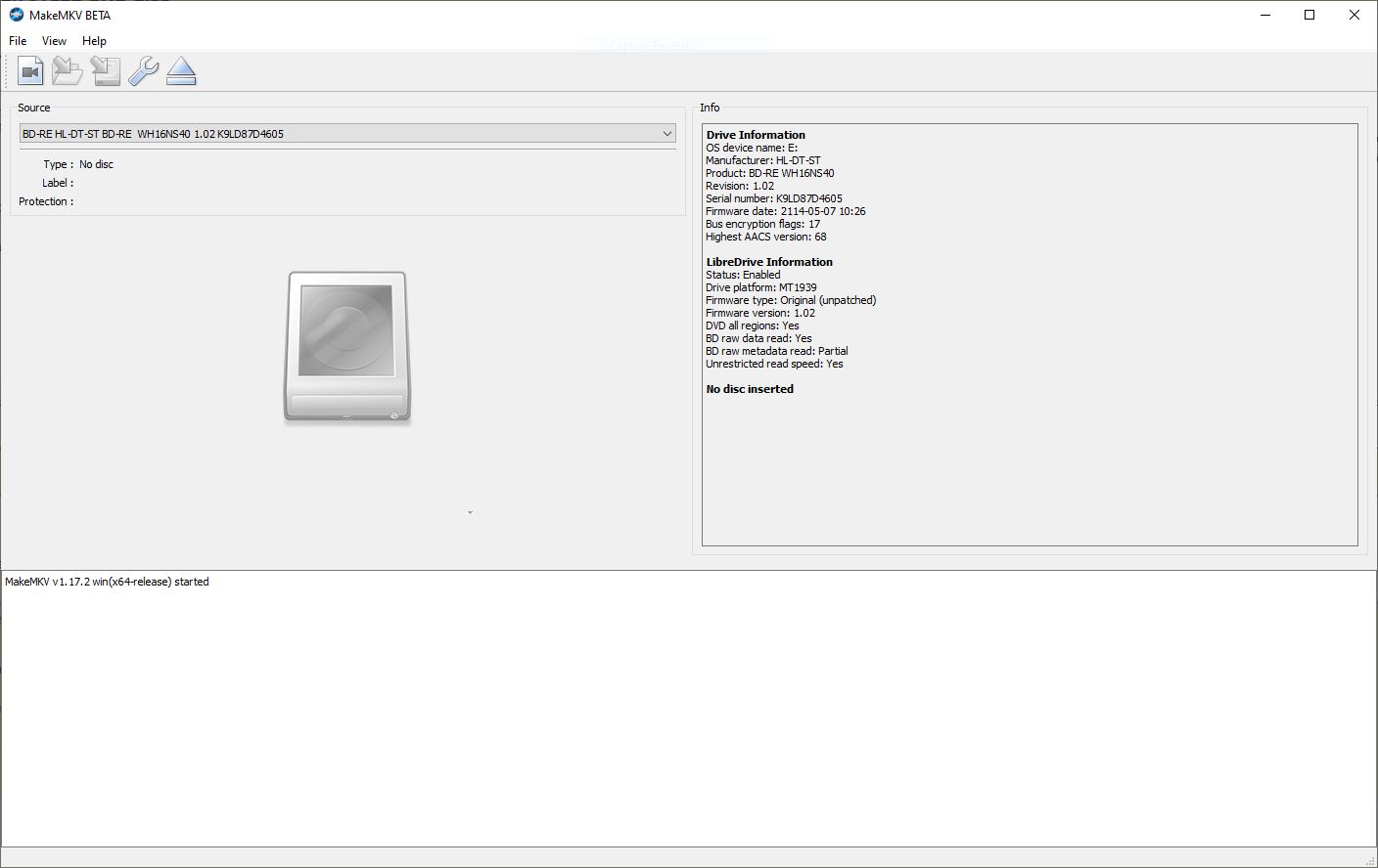

I bought it few years back, don't remember when, firmware was at 1.01 and I update to 1.02 when it was released at the time. Everywhere I read that it is supposed to be able to rip UHD discs if the drive firmware is at 1.02.
The SVC Code is indeed NS50. I didn't update the firmware to a newer version because it look like the 4K capabilities are gone after the flash.

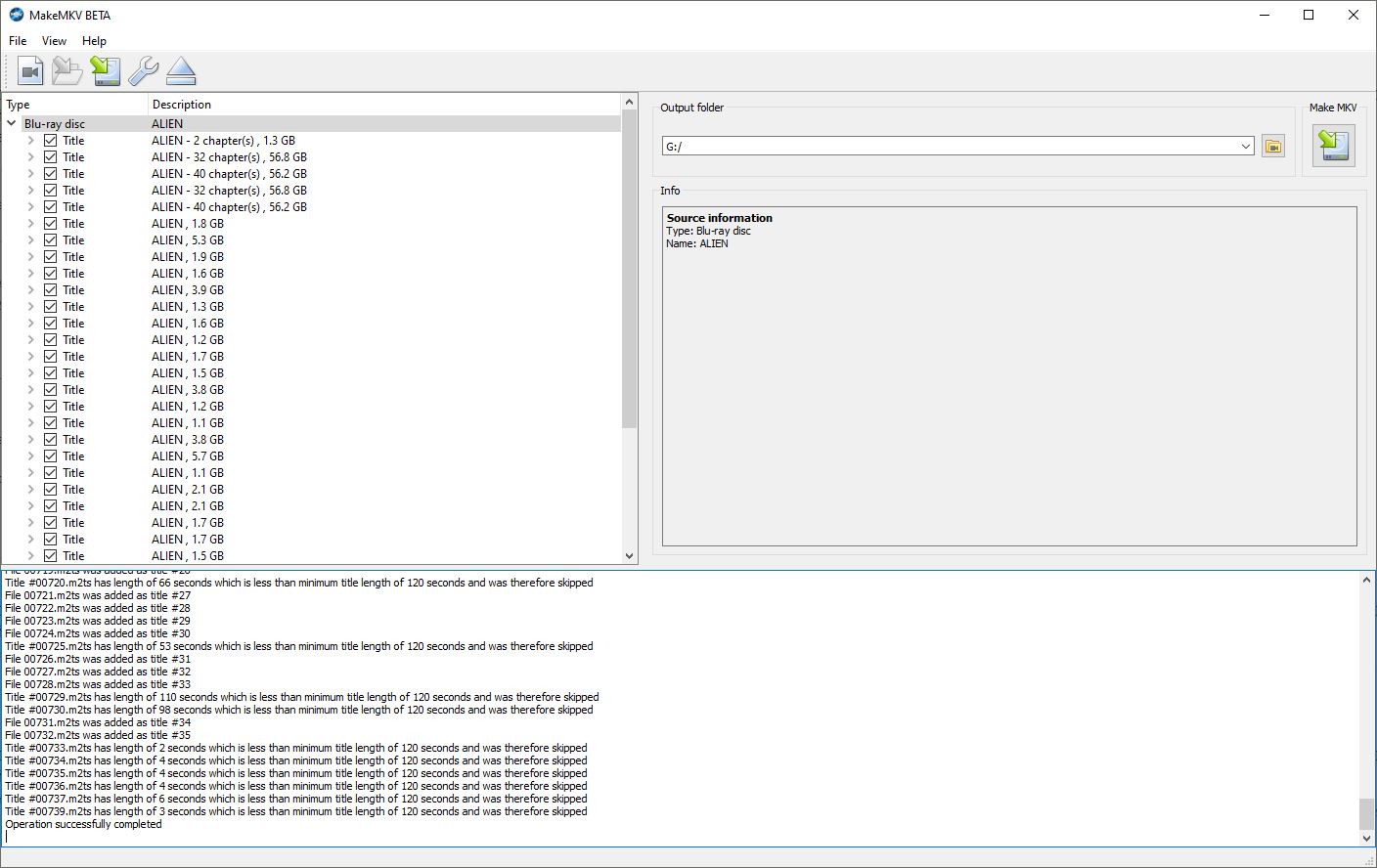

Makemkv just try to read the disc but can't do it apparently. I get no error at all.
Alien is the first UHD disc I'm trying to rip and it's a brand new disc. The box set come with a HD disc and the UHD disc. I ripped the HD disc, no problem.
I've attach the file so you can see what I see in makemkv.

Sorry I just seen it is too and does not support UHD discs as it is MT1939
This drive must be dated 2015 onward model and say SVC: NS50 on the drive label to support UHD discs
If your firmware was in 2014 it was to old. If you flashed the drive it will be bricked and the only way to recover it now is dos flash or use the SDF Flasher to recover the drive.

Yep, your drive is too old (it's a 2014 drive with MT1939 drive platform) and will never be capable of ripping UHD. You need a drive that is no older than October 2015 and has MT1959 drive platform.Stevelois wrote: ↑Sat Oct 22, 2022 5:50 pmI answered Marty but my post is awaiting to be checked by a moderator?

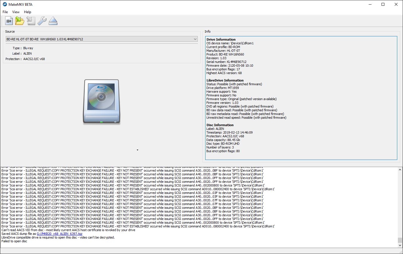

I've received my new LG WH16NS60, install it and loaded the UHD Alien disc. As expected, the disc is fine, it is the drive that is to old.
But now when clicking the big icon at the left, it get stuck and can't decrypt the disc. I presume I must flash the firmware to the latest version for what I understand?

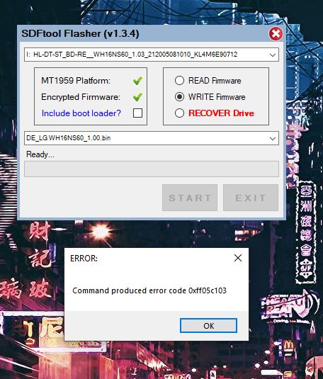

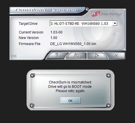

I followed the instruction in this post (viewtopic.php?f=16&t=18873#p70284) to flash the firmware to the 1.0 version but couldn't do, I receive this error :
- error.JPG (33.54 KiB) Viewed 28842 times

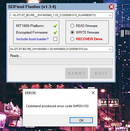

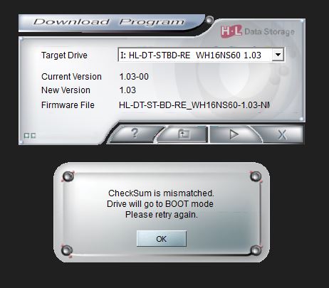

I also tried to update the firmware with the already 1.03 MK version (viewtopic.php?t=19928) but again, I get an error :
- error2.JPG (35.28 KiB) Viewed 28847 times

Trying to flash using SDFtool Flasher 1.3.4 with 1.0 MK file that is included in the pack from this post (viewtopic.php?f=16&t=18873#p70284), don't work neither damn it! It look like the 1.03 version from LG as changed since all error I get look related to command queuing. At least, I could make a dump of the actual firmware if anyone can look at it and fix it. The drive as been produced in July 2022 so it's very recent.
- error4.JPG (65.73 KiB) Viewed 28839 times

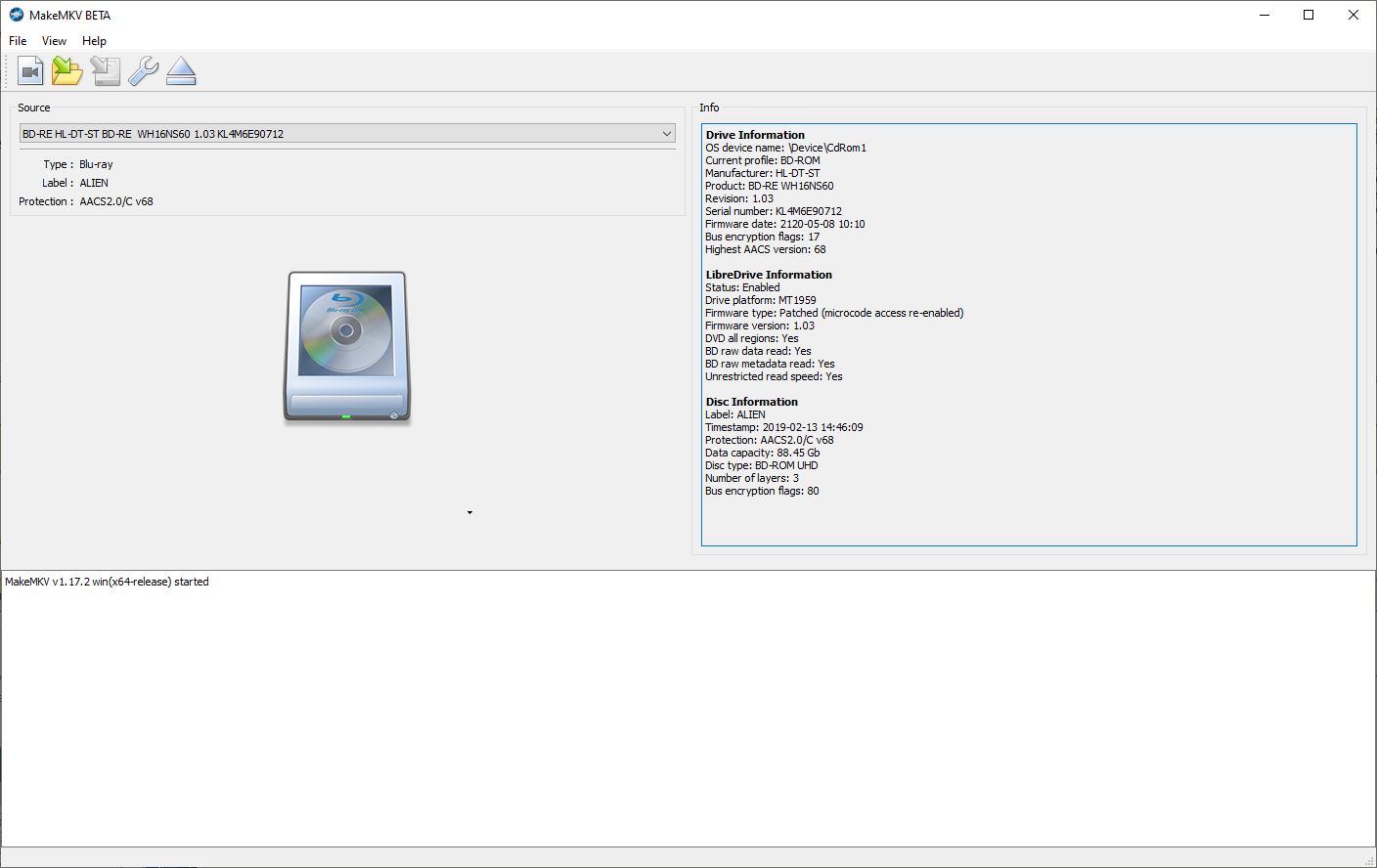

Flashed with SDFtool Flasher 1.3.4 worked finally!!!!! I use the same 1.03 MK version from my previous post.
Only reason why it worked that time is because the tray was closed. I didn't close it when I eject the UHD disc from my previous flashing attempts, didn't think it mattered! Now, I'm ripping but those pics will show the concluant steps before I start the rip.

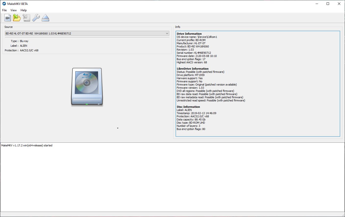

- uhd.JPG (85.16 KiB) Viewed 28836 times
- uhd1.JPG (98.53 KiB) Viewed 28836 times
- uhd2.JPG (167.51 KiB) Viewed 28836 times
Re: LG internal WH16NS40 Blu-Ray drive can't read UHD disc
Alien as been ripped successfully, file is playing well as expected in VLC
