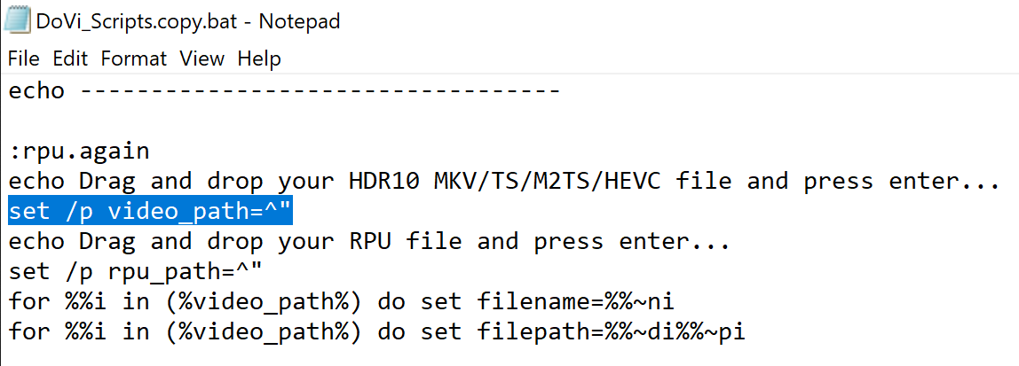

I updated the scripts, input with special characters/ no space should work now. Thanks!

Hmmm Which option would I select from your .bat going from bdmv, or even mkv dv that's already dv, to a dv format the lg c9 can handle?

from BDMV: Mode P7 (3) ---> Mode 1 (1) ---> Workflow 1 (1)
from MKV P7: Mode P7 (3) ---> Mode 2 (2) ---> Workflow 2 (2)
then tsmuxer nightly to mux the output files. There are also the same workflows in the mp4muxer modes.
