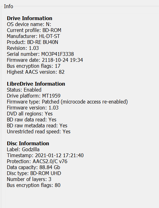

Unfortunately, every single one of your TGZ dump files has the same problem:
SDF v0a5: HL-DT-ST_BD-RE_BU40N_1.03_211810241934_MO3P41F3338
001011:0000 Using LibreDrive mode (v06.3 id=866A98CB9C4E)
002004:0000 Error 'Scsi error - ILLEGAL REQUEST:COPY PROTECTION KEY EXCHANGE FAILURE - KEY NOT ESTABLISHED' occurred while issuing SCSI command AD010..080002400 to device 'SPTI:\Device\CdRom0'
DEBUG: Code 0 at 2U{2<P"^ib0vfW}i5:213130306
DEBUG: Code 0 at ek0A`ekmmj7(oPSno;:121264395
DEBUG: Code 4 at ek0A`ekmmj7(oPSno;:213130789
003306:0000 Can't read AACS VID from disc - most likely current AACS host certificate is revoked by your drivePerhaps you need to wait until the disk has appeared in Windows File Explorer before launching MakeMKV?
Happily for you, all of your disks except for "Godzilla x Kong: The New Empire" already has a complete entry in KEYDB. So once you have managed to enable LibreDrive correctly, could you validate this disk using SamuriHL's KeyDB Helper Utility please? That should complete this final entry.

Well that's just F***in bizarre. I've never had this problem with Libredrive before. It's enabled on the drive (see attached screenshot), but I got that error for every one and assumed it was a missing key. I didn't have this problem a few days ago when I ripped two other UHD discs.

Did you clean the discs? This resolves most read errors unless the drive isn't getting enough power. Use UBS-C if possible and ports direct from the motherboard (not case ports) or an AC self-powered USB hub of at least 24w.BulldogK9 wrote: ↑Thu Apr 02, 2026 3:14 amTried a different computer. Same symptoms.
