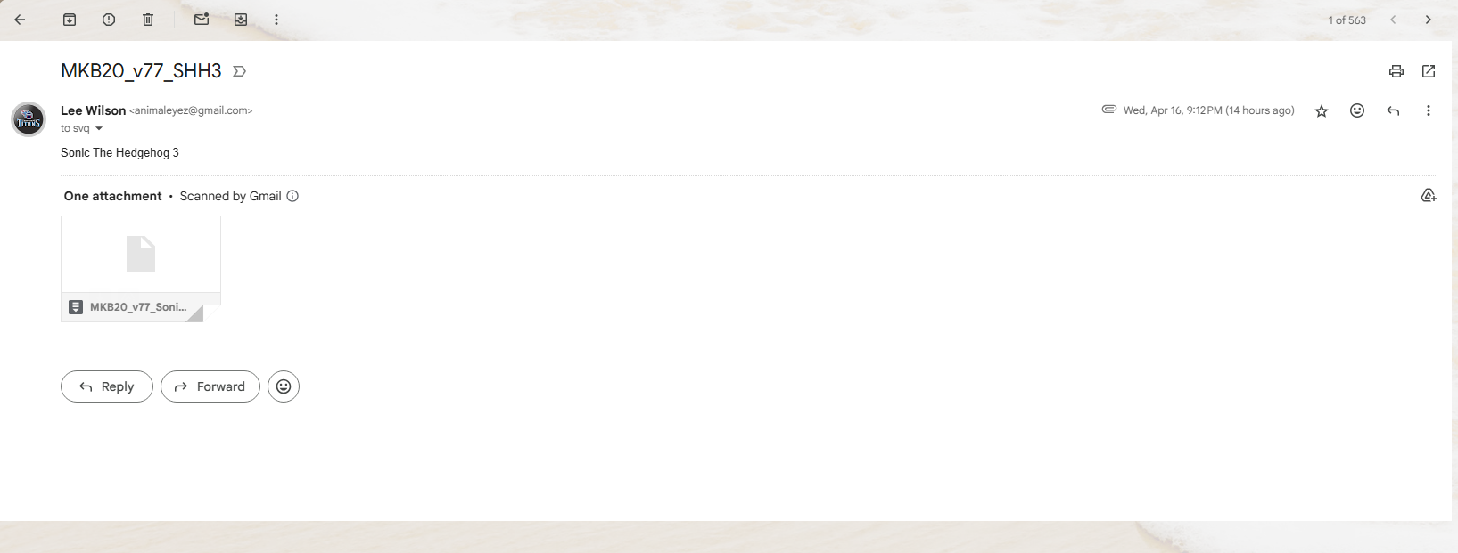

I sent the dump file to the email address you requested me to. My email is animalyez@gmail if that helps. I don't know exactly where I'm supposed to put the KEYDB.cfg. I've attached a screen shot of the sent email. Please let me know how else I can be of assistance to resolve this.
There are two different key mechanisms. One is built into MakeMKV. When a new disc comes out, users submit the MakeMKV generated dump files to svq@makemkv.com and eventually, once the key is generated, MakeMKV will automatically download the key and use it.
The second key mechanism is the public KEYDB.cfg. This is separate from MakeMKV, but they can use the same dumps MakeMKV generates to create keys that get included in a big public database. You have to either attach the dump to a post here or put the file on the internet somewhere and post a download link here so the good folks who contribute to KEYDB.cfg can get your dump and process it into a key that gets included in the big public database.
MakeMKV, in addition to its built-in key mechanism, can also use the public KEYDB.cfg, but you have to set it up manually. You have to download KEYDB.cfg and put it into the right spot for MakeMKV to see it and also use it. And you'll have to occasionally update it manually as well. The upside to KEYDB.cfg is it is often updated with new keys faster than the built-in mechanism that MakeMKV uses by default.

Thank you for this explanation, however with this explanation I'm still left with the question of how? More so where. I don't know where to put the KEYDB.cfg to complete the process. This is what I'm asking for specifically. I have MakeMKV, I have the KEYDB.cfg. Now the question is where do I put the KEYDB.cfg to complete the process of updating that allows MakeMKV to work with this movie. This is the part that is shrouded in mystery for the novice. I have the components and I don't know how to combine them to finish this project.
