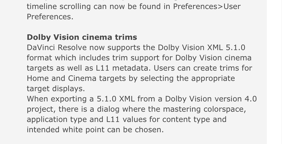

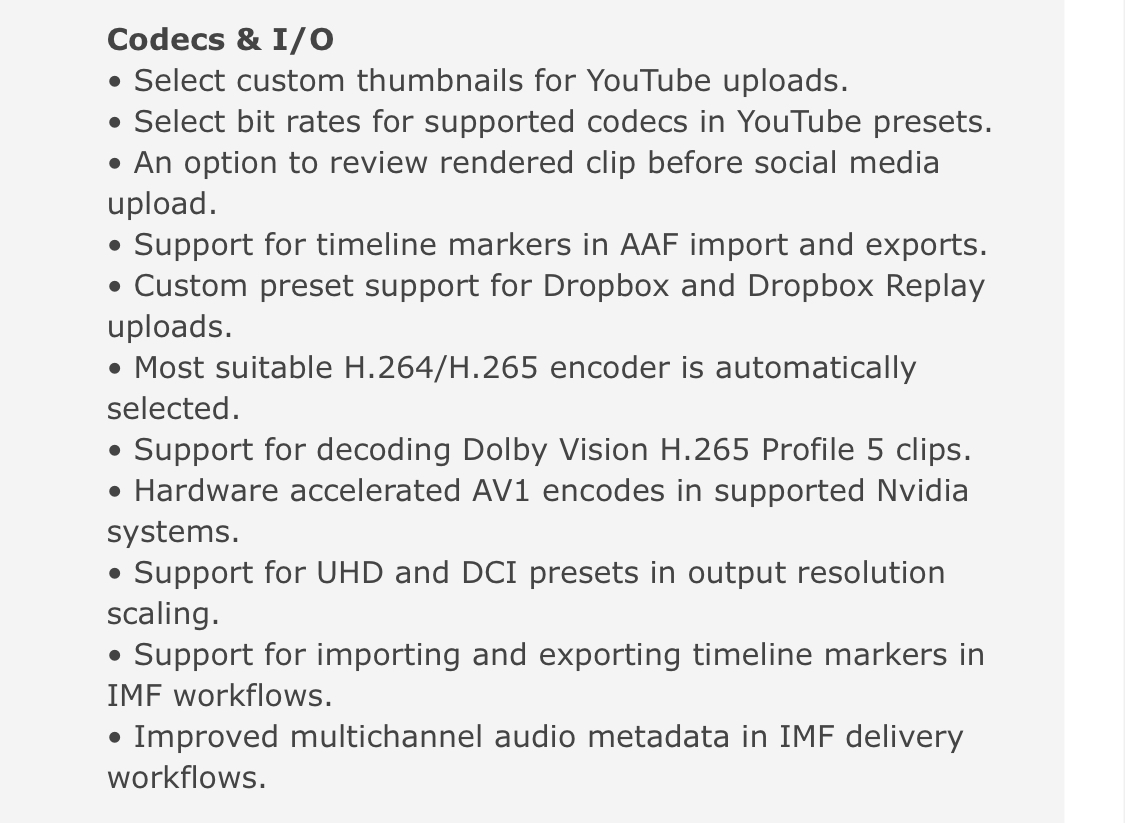

mattmarsden wrote:
Wed Nov 02, 2022 3:09 pm
Would someone be able to give me a quick run down of how to convert HDR10 mkvs to Dovi mkv using MadVR? Thanks very much.
If you haven't already, you might want to look into using DaVinci Resolve. It uses the actual Dolby Vision algorithm and creates correct min_pq values, which will give you a better viewing experience.
