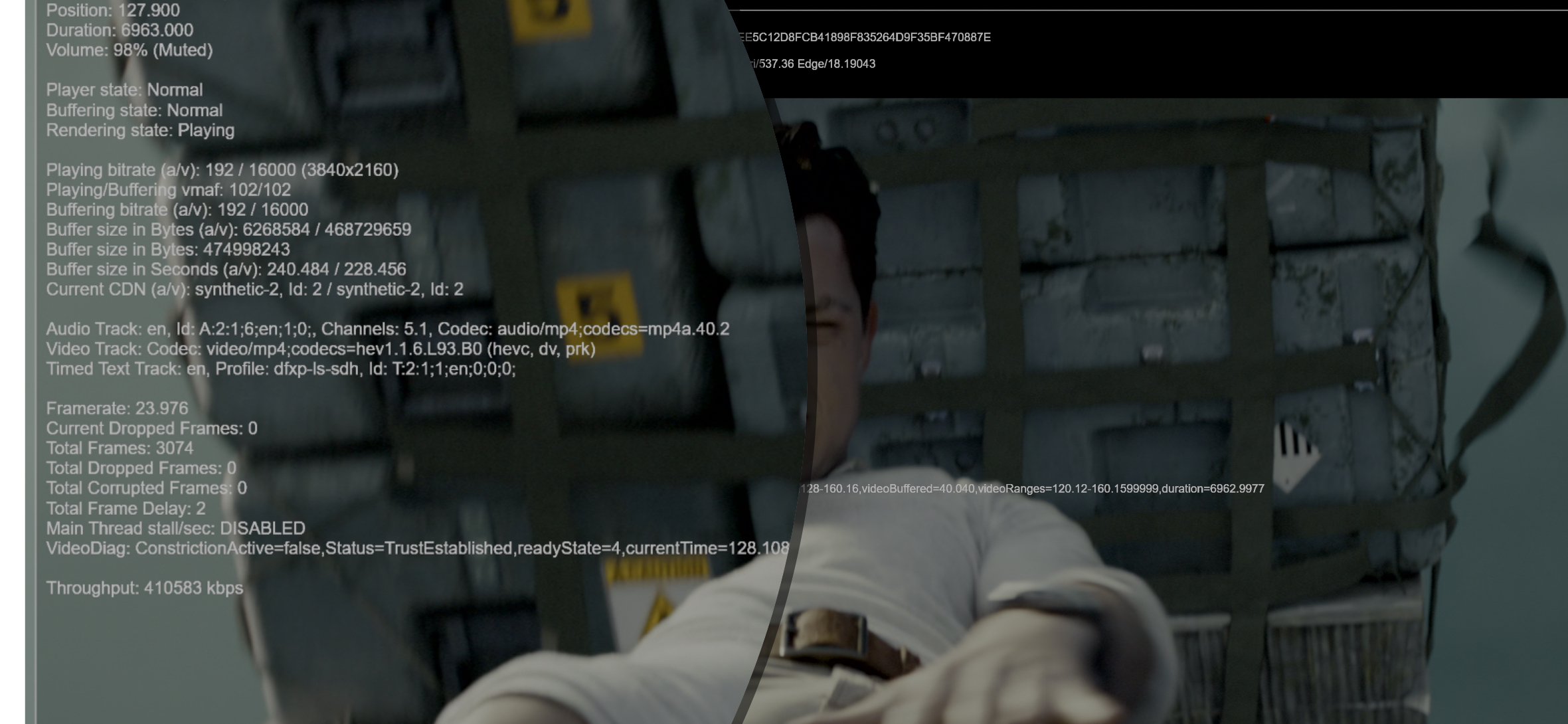

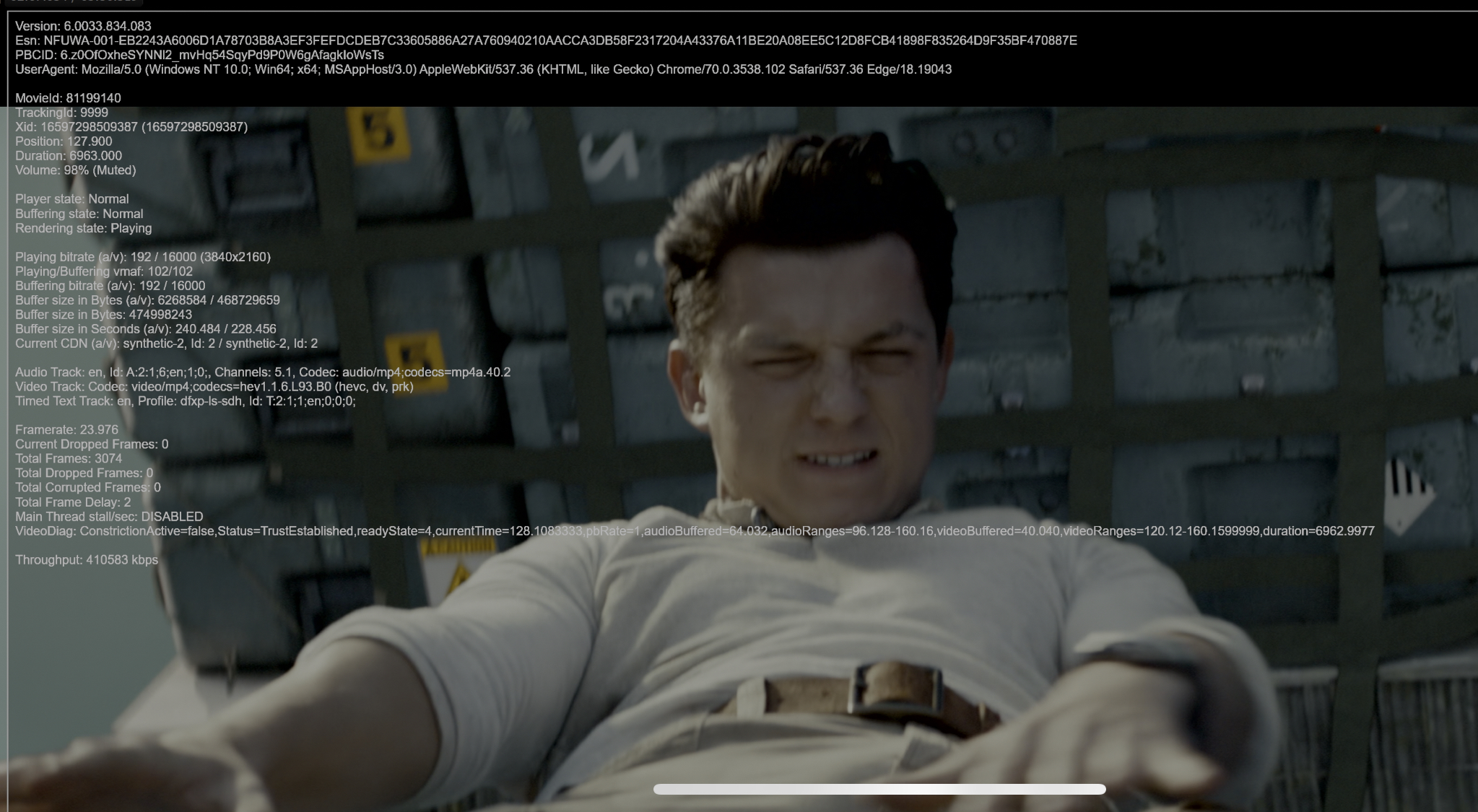

Manixx2020beyound wrote:
Sun Jul 17, 2022 5:21 pm
RESET_9999 wrote:
Sun Jul 17, 2022 3:20 pm
Sun Jul 17, 2022 2:59 pm
I use a dv tv as monitor & widows app this is the playback I get from windows app
This is probably as close to dv on a pc with mp4, pc is in hdr mode when dv kicks in.
https://drive.google.com/file/d/1bEHAjx ... p=drivesdk
you forgot to mention that you have to use the Vertex to trick windows into thinking you have a DV monitor. :)
True lol
A bit off topic,
Getting playback from external apps as well
Just tested Netflix,vudu,Disney on my PC with this config all apps playback in doblyvision with corresponding dv tittles
(Doblyvision logo) is present apon playback as well in both doblyvision & atmos,
Tested Grayman
Bitrate from the PC version vs x700 version
Huge diff:)
Netflix pc dv clip
https://drive.google.com/file/d/1hcejmh ... p=drivesdk
