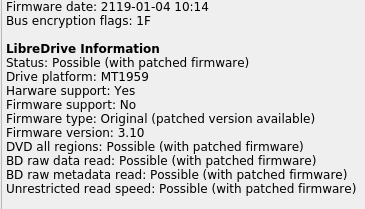

Hi, I'm trying to flash an Asus BW-16D1HT Revision 3.10 on Linux (I do not have Windows) and sdftool seems to work:
sdftool -d /dev/sr0 -i ASUS-BW-16D1HT-3.10-WM01601-211901041014.bin rawflash full,enc
Reading input file ASUS-BW-16D1HT-3.10-WM01601-211901041014.bin
Flashing flags = 0x1 : 0 0 0 1 : ---- ---- ---- BOOT
Current Drive ID: ASUS_BW-16D1HT_3.10_211901041014_<SERIAL_NUMBER>
yes
100% Operation finished
Done successfully
But when opening MakeMKV again it seems to still have the original firmware.
Screen Shot 2021-03-01 at 16.32.46.png (27.25 KiB) Viewed 9374 times
Any ideas?

The ASUS firmware is not encrypted. Don't use "enc".

#3 Post by bas303 » Tue Mar 02, 2021 11:29 am
Thank you sir, it wasn't clear to me when reading the various posts but that indeed did the trick!
