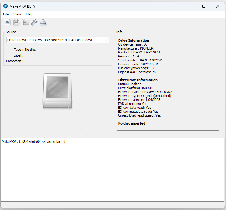

trev.bot flash is a desktop app by Trevor (trevbot here on the forum) that gets LG and Pioneer Blu-ray drives ready for 4K UHD discs. It checks your drive, downloads the right firmware for it and walks you through the flash. No command line and no hunting for firmware files.

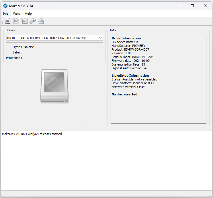

I own several Pioneer drives that had firmware from after December 2022, and for a long time there was no practical way to downgrade or crossflash them. When I saw Trevor's post on the cdrinfo forum, I contacted him and sent MakeMKV screenshots of my drives. He prepared a test build for me, and I went from BDR-XD05T 1.22 straight to BDR-XD06U 1.11 in one step. My BDR-XD07TB and BDR-211UBK followed. Since then, other people in this thread have done XD07, XD08 and 212EBK drives too.
Before:
After:

Another Pioneer drive has been successfully downgraded thanks to Trevor.
This time it's the BDR‑XD07TB, which landed in my hands with the latest firmware already installed.
It is now fully ready to read 4K UHD discs.
Before:
After:

Another success story.
Flashed Pioneer BD-RW BDR-XD07 to BDR-XD07U. In now can read UHD disks.
Before:
OS device name: /dev/sr0
Manufacturer: PIONEER
Product: BD-RW BDR-XD07
Revision: 1.06
Serial number: TIDL004642UC
Firmware date: 2024-10-09
Bus encryption flags: 13
Highest AACS version: 57
Drive platform: Pioneer RS8D30
Firmware version: GENE
After
Product: BD-RW BDR-XD07U
Revision: 1.04
Firmware date: 2022-05-31
Highest AACS version: 72
Drive platform: RS8D31
Firmware version: 1.04/ID05
Many thanks to the author!
