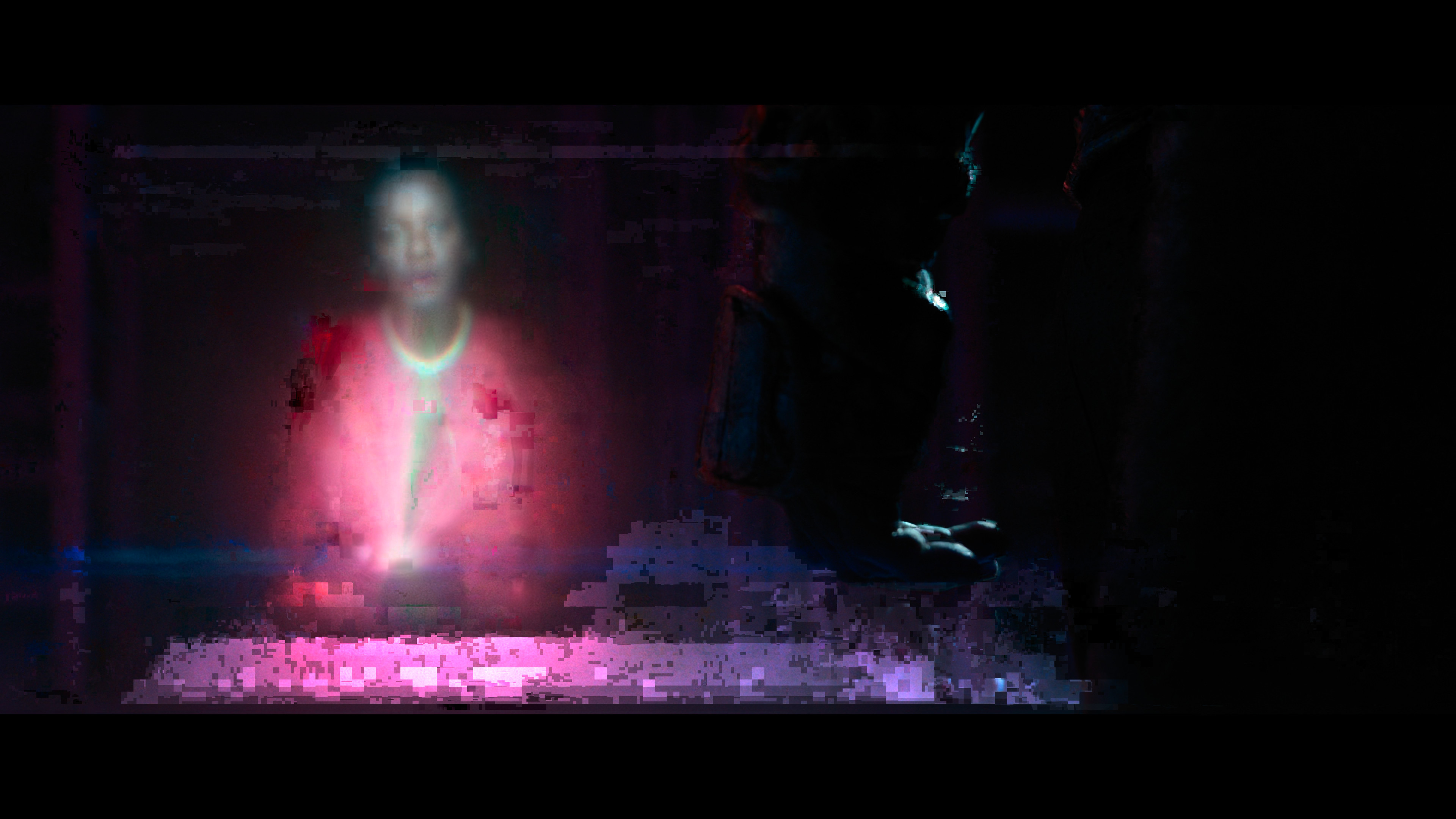

I´m having a weird issue. I recently imported my first Shout!Factory UHD Bluray (Happy Death Day 2U) from the US to remux it with the dubbed track of my local bluray. Luckily both rips are the same length so no change is required there on the audio side, just a simple remux, which I do from time to time. I never had an issue but this time is was weird. Well, the remux process did not yield anything wrong - no error - nothing. (Remux process: rip file with makemkv and the use mkvtoolnix to combine the files) Yesterday I watched my remux through Plex and noticed some extreme gibberish. (1:23:40/45)
First I thought it is the player software (Plex HTPC based on mpv) but then I tried it on all of my clients (Lg TV, Android Phone, Ipad, Nvidia Shield, mpv) and all of them showed this mangled image. (Some players even crashed) I did some further investigation with the cli player of mpv with software decoding, it showed a "ffmpeg error" message.
The cu_qp_delta 34 is outside the valid range [-32, 31].
I never had this one and I´m having no idea what it really means - all I know is it leads to an image error. I also suspected this could be an encoding issue on Shout!Factories side but that was negated relatively quickly after playing back the file with my UHD Bluray player. (no glitching there)
Then I googled the error message and found a post on the FFmpeg bug tracker side that mentioned this could be a remuxing problem, so I ripped the disc and remuxed it again with mkvtoolnix. I checked the file after the rip and after the remux - both files showed no glitching anymore at this spot.
Is this an issue someone else also had? Is there an explanation of how this could happen and/or whether this is an issue with makemkv or mkvtoonix? How could someone prevent this in the future? Is there a tool that could sanity check an hevc video stream? I tried hbbatchbeast but this did not help and showed no error.

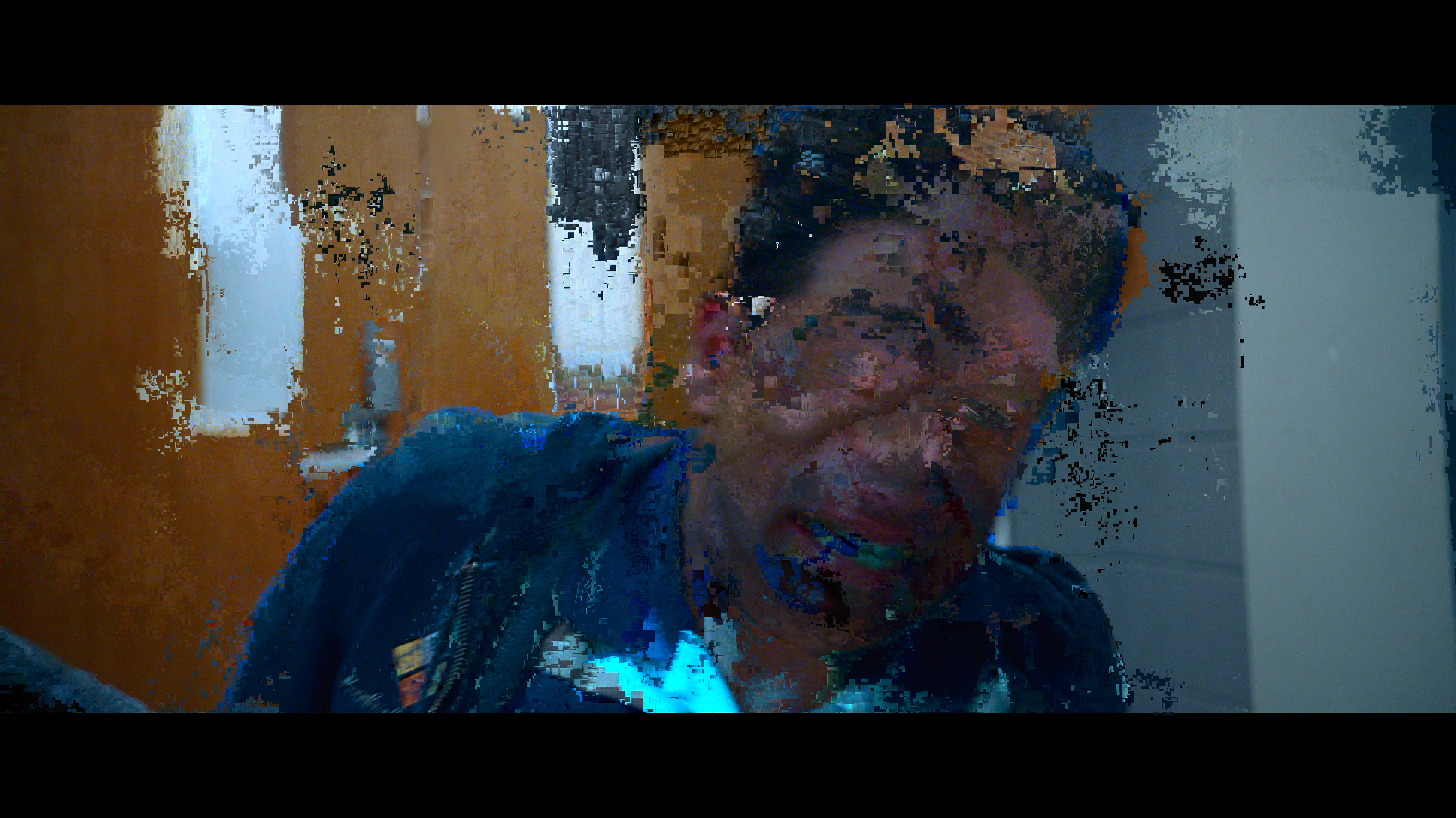

I just ripped Black Adam and while watching I noticed similar glitching as seen with HPDD2U...
After some file diagnostics, I got the almost same cu_qp_delta error...
The cu_qp_delta 113 is outside the valid range [-32, 31].
The only difference this time is, I have not remuxed the file with mkvtoolnix. It was a basic rip with makemkv. (load the disc -> select the title -> set preferences on audio tracks and then hit "make mkv") So I guess the issue comes from makeMKV?
I have no idea what is going on. Could this also be slow or "buffer overflown" storage? All of my rips are created/copied to a nvme drive so I can leverage my 10gbit network when copying the file to my server...
I guess for now I will check all of my files with ffmpeg for cu_qp_delta errors and hash-check before and after transferring them to my storage box...
