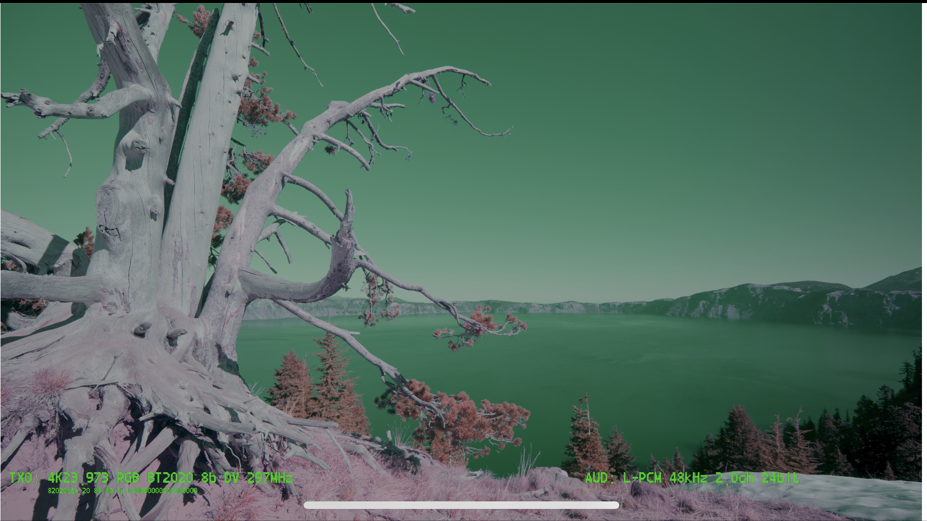

FubbAyH wrote: Sun Aug 22, 2021 9:27 pm Thank you! I've tried that now and the fake profile 5 file plays as DV in Plex and Infuse, but I don't see a brightness change in either of them, unfortunately. So that's disappointing.
wow, in the past years we've seen a lot of people commenting here on how they don't see anything wrong about profile 5 uhd bluray rip played on the appleTV 4K. They are actually watching fake DV !!!

#5362 Post by RESET_9999 » Sun Aug 22, 2021 11:50 pm
FubbAyH wrote: Sun Aug 22, 2021 11:20 pm It has frustrated me that the players seem to be ignoring the RPU in my P5 test files, because I was assuming that P5 was the one thing that would work reliably. I'm wondering if it's just an Infuse bug causing that, so I'll investigate that.
just because the file mediainfo says profile 5 DV doesn't mean the actual RPU is profile 5. The rpu is still p7 or p8 regardless of the profile it's muxed because the dv-tool doesn't support p7(or p8) to p5. And an actual true p5 rpu probably wouldn't work with an HDR10 BL

#5363 Post by FubbAyH » Mon Aug 23, 2021 12:35 am
Ah, I see what you mean. I didn't realise that the RPU data includes which profile it is for. So it's actually reasonable that Infuse would ignore the RPU in my hacked-together file because it's for the wrong profile. So we don't have any evidence that Infuse is playing profile 5 files incorrectly. I'll keep investigating. Thanks again for all your help!
