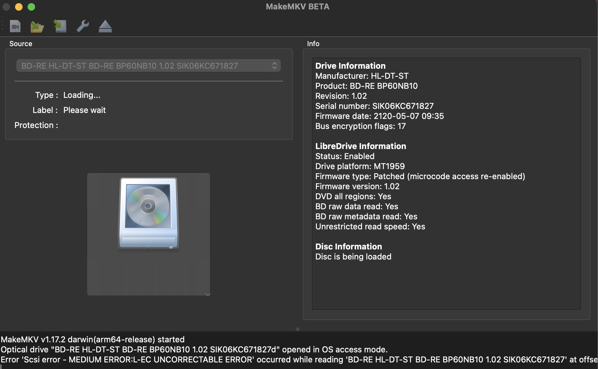

Coopervid wrote: Thu Nov 03, 2022 7:21 pm
aerandir92 wrote: Thu Nov 03, 2022 7:13 pm My ASUS drive just won't read any discs anymore after the first attempt of reading Maverick failed at around 70%. I've powercycled it, let it be unplugged from power for a while, rebooted the PC etc. The drive shows up in Windows, MakeMKV sees it, but when I enter a disc it just makes a few noises and never spins up properly :(
The blue laser might have failed. Try first a CD. Then a DVD. And at last a regular BD. If all still work all the lasers are still OK. Which leads to subsequent tests / measures.
Think you might be on to something there, DVD worked just find, BD does not. The unit is 4-5 years old, or something like that, so not that surprised if it failed now.
Posts: 4553
Re: Top Gun: Maverick
Most likely the blue laser died. These drives don't last very long.

Try WH16NS60 1.03 but I'm not confident. It should read with a Pioneer UHD drive. Let me know by PM if you want to consider tht route.
thirdgen89gta
Posts: 20
Joined: Tue Sep 02, 2014 2:54 am
Post by thirdgen89gta »
Coopervid wrote: Fri Nov 04, 2022 9:29 pm Try WH16NS60 1.03 but I'm not confident. It should read with a Pioneer UHD drive. Let me know by PM if you want to consider tht route.
The 2nd disc did eventually rip via Backup > then Rip individual MKV out of the backup. But still a bunch of AV sync errors on the same m2ts's. Haven't watched the output yet, so don't know if its actually good.
I originally had a ASUS drive, but that died, and I replaced it with this WH16NS60. I tried to look for the most current MK firmware, but found 1.02 in one of the packs on this forum.
Using LibreDrive mode (v06.3 id=7FA2657C7667)
Backing up disc into folder "/Volumes/RipStorage/TOP_GUN_MAVERICK"
File "/dummy_f.dat" was skipped
Hash check failed for file 00294.m2ts at offset 31798388736, file is corrupt.
Hash check failed for file 00294.m2ts at offset 31798781952, file is corrupt.
Hash check failed for file 00294.m2ts at offset 31799175168, file is corrupt.
Hash check failed for file 00294.m2ts at offset 31799371776, file is corrupt.
Hash check failed for file 00294.m2ts at offset 31799764992, file is corrupt.
Too many hash check errors in file 00294.m2ts.
Hash check for /BDMV/STREAM/00294.m2ts : 0.00% corrupt, 99.99% correct, 99.99% checked.
Encountered 5 errors of type 'HashCheck Error' - see http://www.makemkv.com/errors/hashcheck/...
Backup done but 1 files failed hash check
Screenshot 2022-11-16 at 11.05.14 PM.png (307.93 KiB) Viewed 19740 times
Been trying to rip the Maverick 4kUHD and disk cannot be loaded each time with different computers. Get this error each time. Using flashed LG BP50NB40, and had never had any issues with 4k blu-rays in the past. Any help? Disk has been cleaned multiple times.
Posts: 5842
richpanda wrote: Thu Nov 17, 2022 7:13 am Screenshot 2022-11-16 at 11.05.14 PM.png
Exchange the disc
