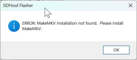

I have looked through the forums can I can't find the KEYDB.cgf.
Also when I run SDFtool Flasher.exe I get this error and I have MakeMKV running.
Posts: 1716
Post by d00zah »
Username:0000 wrote:
Sun Dec 28, 2025 12:45 pm
The SDFtool Flasher (GUI front-end for native MakeMKV CLI flasher) expects MakeMKV to be installed in its default location.
LInk(s) to KeyDB.cfg in 1st post of Public KeyDB Disc Submissions.
