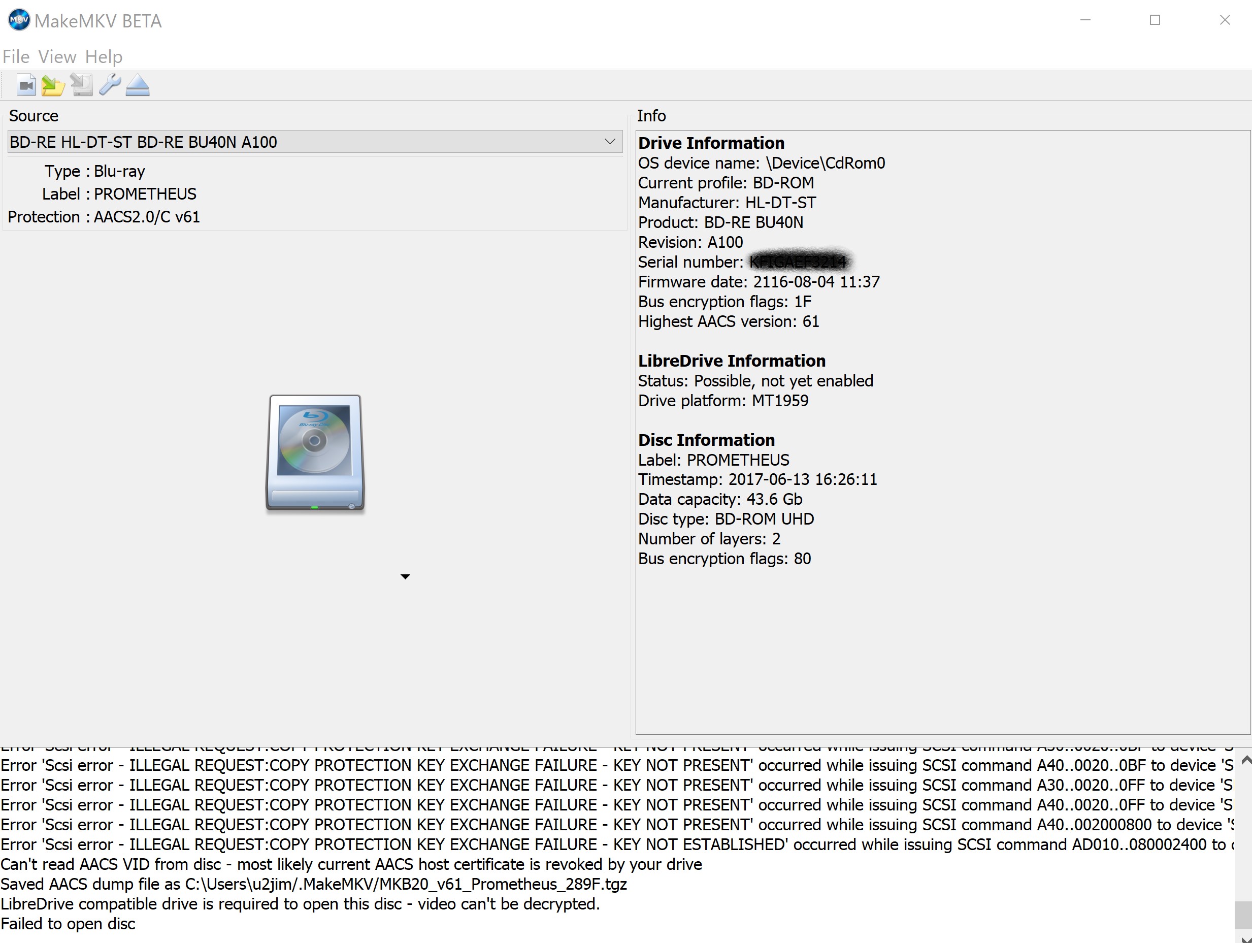

This is my first post on your forum. Please excuse me if I am posting this inappropriately.
I have a large library of DVD's and Blu Rays sitting on shelves. I thought it would be straight forward to rip them so I could stream them to my TV.
I have zero experience with computer code. I found HandBrake and all went smoothly ripping DVD's. I tried the Blu Ray's and found I needed your MakeMKV program. However, in using it, I find it can't rip. It tells me my optical drive is LibreDrive possible but not enabled. I have attached a screen shot of MakeMKV trying to rip Prometheus. It provides the make and model of my drive but I can't find what firmware version it is. On other posts there are serious cautions about flashing this drive with the wrong firmware version.
From the information provided in the screen shot, can someone inform me of:
1. whether this drive can be LibreDrive enabled;
2. what firmware I need (if it can be enabled); and
3. a link to a youtube video describing the process.
Thanks in advance for any help / guidance you can offer.

Yeah flash de bu40n 1.00 or 1.03mku2jimbo wrote: Fri May 01, 2020 3:57 am This is my first post on your forum. Please excuse me if I am posting this inappropriately.
Look at pined UHD guide in UHD drives for my videos

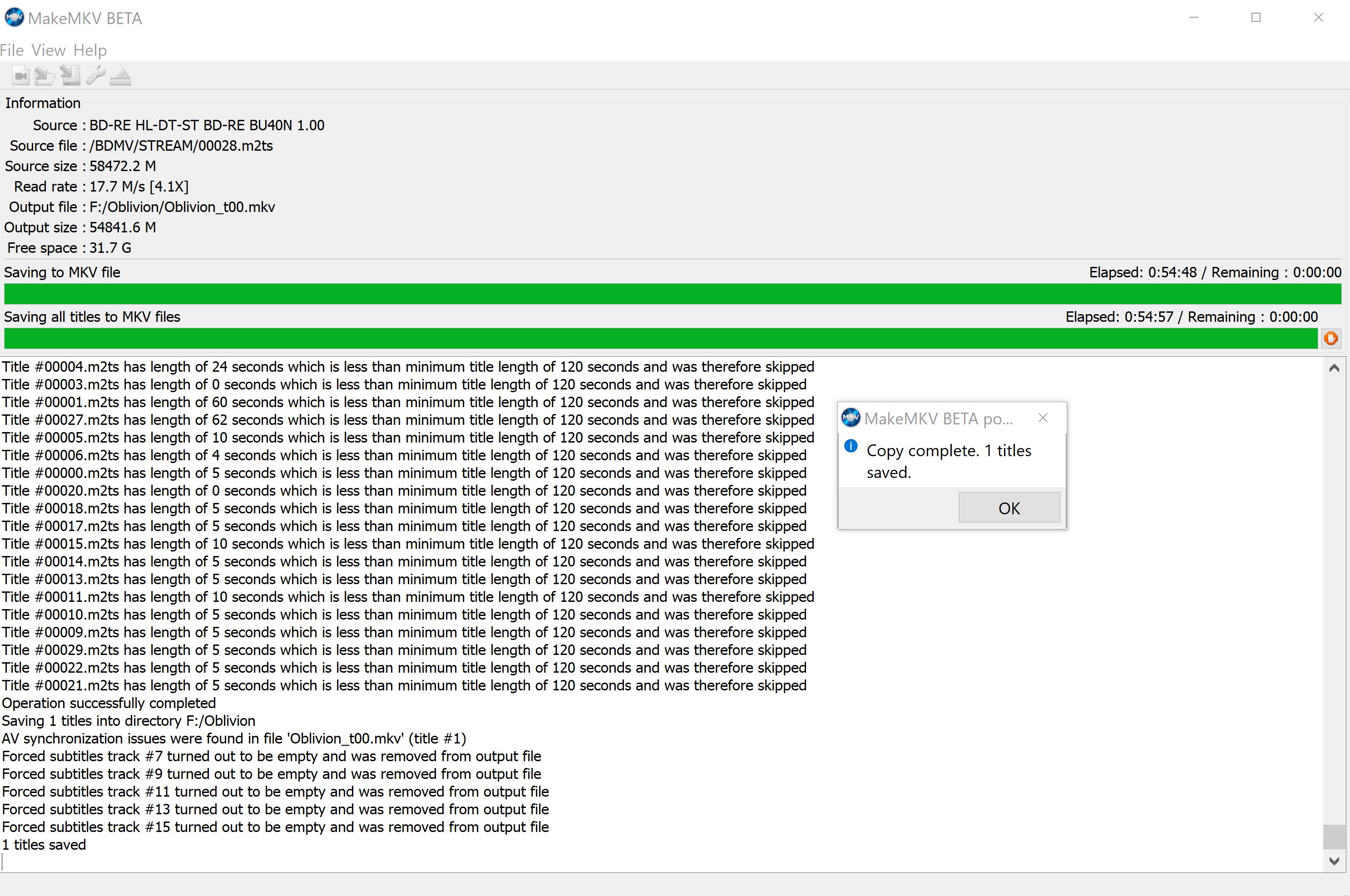

I wanted to let you know that I followed your guidance and have been successful in flashing my drive. I watched your YouTube video a few times; downloaded the bin file off Google; used the included flasher app and a few heart palpitations later finished the flash.
The proof is in the pudding. I have ripped three blu rays so far. Each has played perfectly on Plex. See attached snapshot of completed rip of Oblivion.
Thank-you very much for your guidance! And thanks to all of your buddies that sustain this website with your group expertise. People like me with expertise in other areas would truly flounder. The MakeMKV and LibreDrive apps are true works of art - so simple to use but (I imagine) so complex to create.
- Oblivion Saved w AV Synch issues.jpg (1.04 MiB) Viewed 47058 times

nice glad it worked out for you.u2jimbo wrote: Tue May 05, 2020 11:42 pm BillyCar11:
