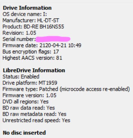

Re: SDFtool Flasher
I just got my BH16NS55 in...
Flasher tools don't seem to work at all. Any help would be appreciated.
OS device name: E:
Product: BD-RE BH16NS55
Revision: 1.05
Serial number: [redacted]
Firmware date: 2120-06-18 13:42
zittrig
- Posts: 442
- Joined: Sat Jan 09, 2021 5:45 pm
Re: SDFtool Flasher
Which firmware you want flash?
- Posts: 1722
Re: SDFtool Flasher
The guide says"daemon9 wrote: Tue Dec 17, 2024 1:57 pm I just got my BH16NS55 in...
Flasher tools don't seem to work at all. Any help would be appreciated.Code: Select all
Drive Information OS device name: E: Manufacturer: HL-DT-ST Product: BD-RE BH16NS55 Revision: 1.05 Serial number: [redacted] Firmware date: 2120-06-18 13:42 Bus encryption flags: 17 LibreDrive Information Status: Possible, not yet enabled Drive platform: MT1959 No disc inserted
Revision: 1.05 FW is encrypted, so make sure 'Enc' is checked. No disc in tray. Tray closed.BH16NS55 on any Firmware directly to > WH16NS60 1.02MK
