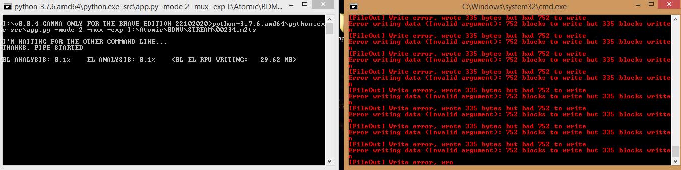

@Yusesope
I am trying to use your command for chapters in gamma tool without success.
First command:
python-3.7.6.amd64\python.exe src\app.py -mode 2 -mux -exp I:\Atomic\BDMV\STREAM\00234.m2ts
Second command:
src\Gpac\gpac.exe -i pipe://video:ext=hevc:audelim=true -o stdout:ext=ts:pes_pack=none | src\FFmpeg\ffmpeg_win_x64.exe -hide_banner -y -i - -i bluray: I:\Atomic -map 0:0 -map 1:2 -map 1:6 -map 1:11 -map_chapters 1 -c copy -bsf:v hevc_metadata=aud=insert -metadata title="Atomic_____________________________________" D:\Atomic.mkv
And I get this:
Of course my mistake, But "where?"
kws53

ragico wrote: Wed Nov 04, 2020 2:09 pm @Yusesope
First command:
Second command:
And I get this:
I had the same problem, so I tried (using my files but extending your example):
python-3.7.6.amd64\python.exe src\app.py -mode 2 -mux -exp bluray:\I:\Atomic
While this revised 1st command executed as expected, the 2nd command exited with a "Pipe" input error. I believe that the 2nd command needs to be reworked for a different input file type.
kws53 wrote: Wed Nov 04, 2020 4:48 pm
I just realized that the version of FFmpeg I have attached to my tool does not implement the bluray protocol.
To solve, download the full version of FFmpeg HERE, unpack the archive, rename ffmpeg.exe (inside the "bin" folder) to ffmpeg_win_x64.exe and overwrite, with the latter, the same file that you find in the src\FFmpeg folder (inside my tool folder).
Try again and let me know.
ragico wrote: Wed Nov 04, 2020 2:09 pm First command:
Second command:
There is just one small mistake: remove the space after "bluray:" in the second command line.
kws53 wrote: Wed Nov 04, 2020 4:48 pm I had the same problem, so I tried (using my files but extending your example):
While this revised 1st command executed as expected................
I never talked about changes to the first command line.
My tool is programmed to receive a file not a folder address. Besides, he doesn't know what "bluray" is.
And finally the address of the folder written in this way does not make sense in Windows (remove the first Backslash ... \I:\Atomic).
Follow the instructions and take a cue from @ragico's commands (except for the space after "bluray:" in the second command line)
DaMacFunkin wrote: Tue Nov 03, 2020 9:18 pm If there are multiple main movie playlists, ie 0800, 0801, 0802 and you specifically know you want 0801, cut the other 2 out of the playlist folder, this way ffmpeg will choose 0801 as the only main movie playlist in the folder ;-)
There is a special switch in FFmpeg: -playlist :wink:
First command:
Second command:
And I get this:
Hi, I’m getting the same error trying to create a -mode 2 from The Hunt For Red October which I’m also having problems with in makemkv

yusesope wrote: Wed Nov 04, 2020 6:30 pm
Followed your suggestion. Now the program works but the file generated does not contain any chapter and also it does not start playing and stays at zero
@Yusesope
FYI - bluray:\C:\ and bluray:C:\ are equivalent. I use the additional "\" for clarity.
My interest in exporting the folder address (which we use in Command 2), is to handle seamless branching. By mixing and matching an exported m2ts file with a folder, I can't see how we could handle multiple m2ts files.
And Command 1 worked using the -exp bluray command. While it may not have exported the appropriate data, I received :
"I'M WAITING FOR THE OTHER COMMAND LINE..."

ragico wrote: Wed Nov 04, 2020 8:19 pm

DaMacFunkin wrote: Thu Nov 05, 2020 5:56 am
Hi, I got the program to run, my output file didn’t transfer chapters either, I haven’t had time to try on a device yet (so busy at work).

DaMacFunkin wrote: Thu Nov 05, 2020 5:58 am
I muxed in chapters using MKVtoolNix, worked fine.
