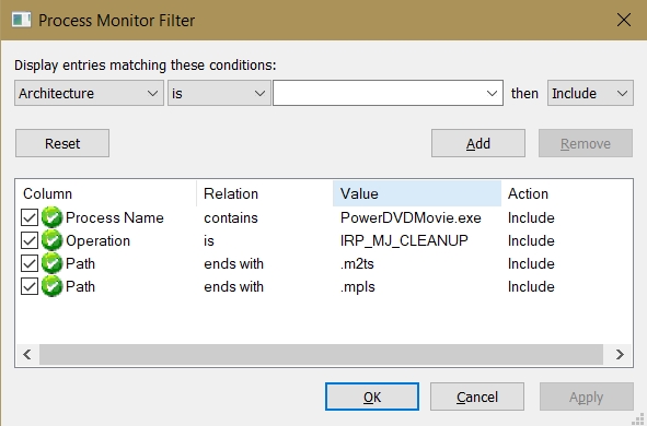

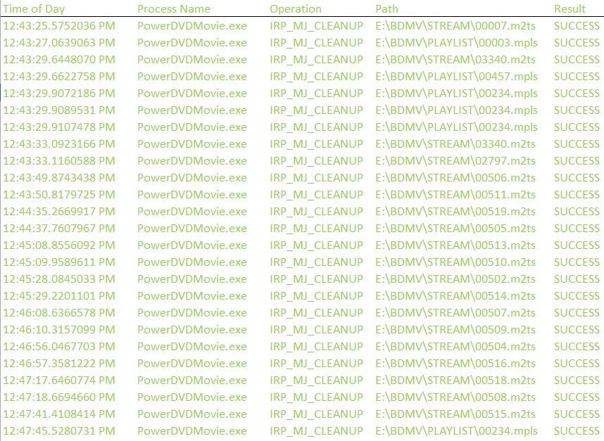

5) If you're using the latest version of procmon, the filter you want to use looks like this...
Poker354 wrote:This solution above.
I added the "path ends with .mlps" at the suggestion of another contributor.
The result was
Just like a few contributors posted.
Basically matching this MakeMKV

6:34:19.9765545 PM PowerDVDMovie.exe 6624 CloseFile G:\BDMV\STREAM\02797.m2ts SUCCESS
6:34:25.3467140 PM PowerDVDMovie.exe 6624 CloseFile G:\BDMV\STREAM\03340.m2ts SUCCESS
6:34:42.8799731 PM PowerDVDMovie.exe 6624 CloseFile G:\BDMV\STREAM\03340.m2ts SUCCESS
6:34:42.8802004 PM PowerDVDMovie.exe 6624 CloseFile G:\BDMV\STREAM\02797.m2ts SUCCESS
6:35:06.8384315 PM PowerDVDMovie.exe 6624 CloseFile G:\BDMV\STREAM\00506.m2ts SUCCESS
6:35:07.8909582 PM PowerDVDMovie.exe 6624 CloseFile G:\BDMV\STREAM\00511.m2ts SUCCESS
6:35:52.3120919 PM PowerDVDMovie.exe 6624 CloseFile G:\BDMV\STREAM\00519.m2ts SUCCESS
6:35:54.9246648 PM PowerDVDMovie.exe 6624 CloseFile G:\BDMV\STREAM\00505.m2ts SUCCESS
6:36:25.9009886 PM PowerDVDMovie.exe 6624 CloseFile G:\BDMV\STREAM\00513.m2ts SUCCESS
6:36:27.0010794 PM PowerDVDMovie.exe 6624 CloseFile G:\BDMV\STREAM\00510.m2ts SUCCESS
6:36:45.1229902 PM PowerDVDMovie.exe 6624 CloseFile G:\BDMV\STREAM\00502.m2ts SUCCESS
6:36:46.3064175 PM PowerDVDMovie.exe 6624 CloseFile G:\BDMV\STREAM\00514.m2ts SUCCESS
6:37:25.7124633 PM PowerDVDMovie.exe 6624 CloseFile G:\BDMV\STREAM\00507.m2ts SUCCESS
6:37:27.3484069 PM PowerDVDMovie.exe 6624 CloseFile G:\BDMV\STREAM\00509.m2ts SUCCESS
6:38:13.0941563 PM PowerDVDMovie.exe 6624 CloseFile G:\BDMV\STREAM\00504.m2ts SUCCESS
6:38:14.6584158 PM PowerDVDMovie.exe 6624 CloseFile G:\BDMV\STREAM\00516.m2ts SUCCESS
6:38:34.6663677 PM PowerDVDMovie.exe 6624 CloseFile G:\BDMV\STREAM\00518.m2ts SUCCESS
6:38:35.7495252 PM PowerDVDMovie.exe 6624 CloseFile G:\BDMV\STREAM\00508.m2ts SUCCESS
6:38:58.4501001 PM PowerDVDMovie.exe 6624 CloseFile G:\BDMV\STREAM\00515.m2ts SUCCESS
I still don't know why it ripped out of order, but I'll try again.
