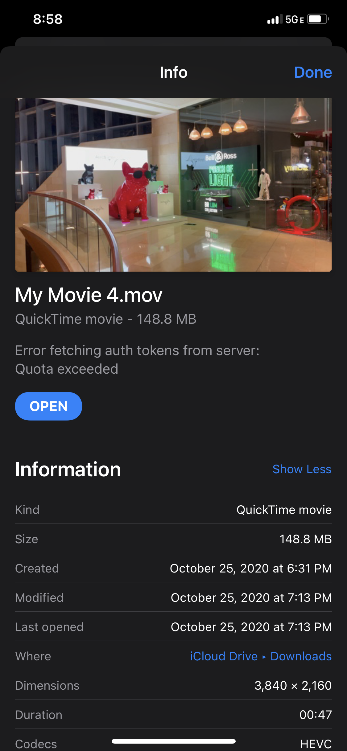

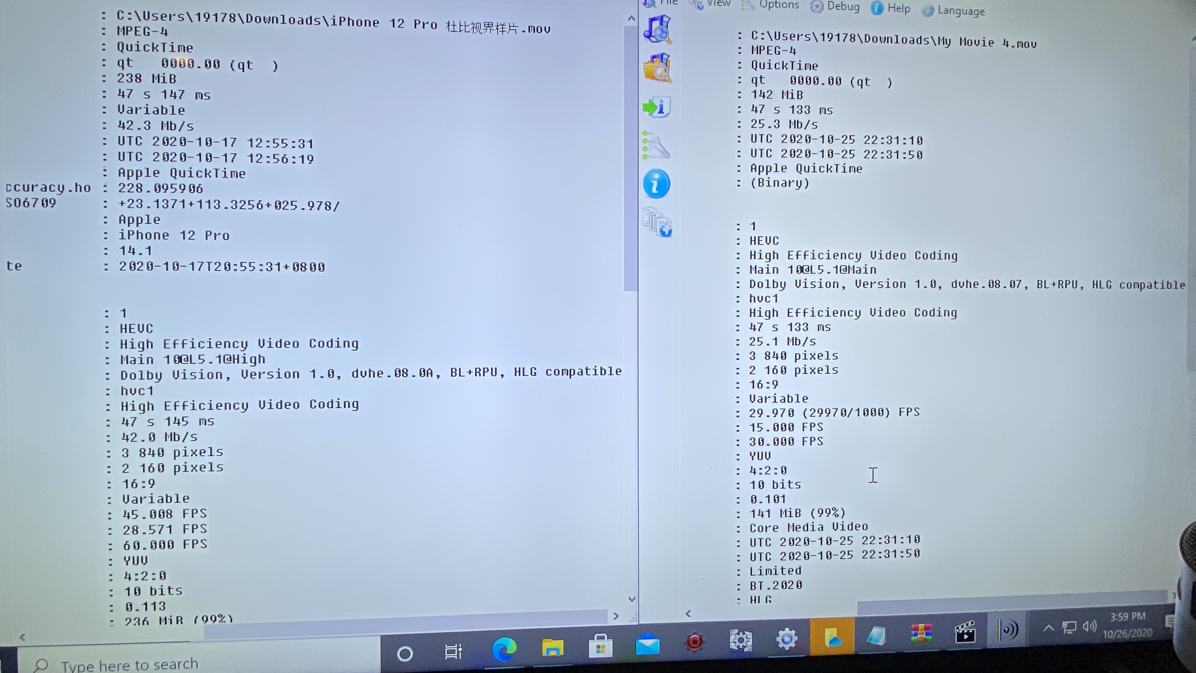

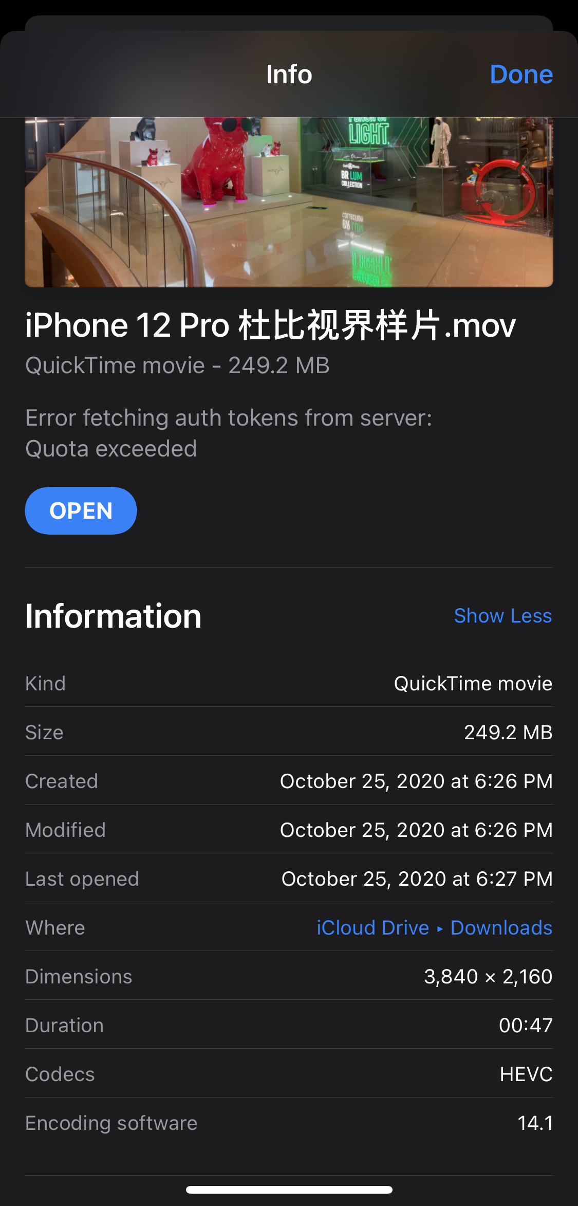

Manixx2020beyound wrote: Mon Oct 26, 2020 12:54 pm And I movie on the 11 produce a doblyvision
File slightly different from the original.
Produced an profile 8 id36 doblyvision hlg.
So I phone 11pro can encode dovi/rpu/bl
Which played in doblyvision on my dv devices.
Any iOS/iPadOS device later than iPhone 8 / iPad Pro 2017 should be able to encode and play DoVi (requires latest iOS and iMovie for iOS)
And yes, the file should be slightly different in size. Because iMovie re-encodes the base-layer and also re-calibrates the DoVi RPU.
And for further info, which @yusesope might also be interested in, iMovie re-encodes any HDR into Dolby Vision (HDR10, HLG, HLG+DoVi). I guess iMovie only generates new RPU. Old RPU data only used when decoding.

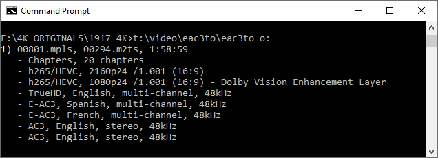

kws53 wrote: Mon Oct 26, 2020 2:16 pm It is a dual track, dual layer m2ts file from the original - see Image 1. How can I tell whether it is a profile 7 file?
Specifically: \BDMV\STREAM\00294.m2ts from the 1917 ISO [US]
Indeed - see Image 2.
I didn't use any switches other than the "-skip_hdr10plus" for my comparison.

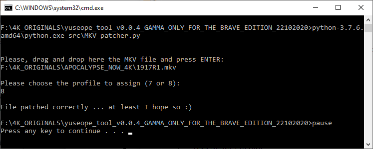

The input file must be a dual track dual layer profile 7 file (e.g. an m2ts file inside the decrypted folder of a UHD-BD)
The mkv file obtained after the program has finished is not recognized as a file with DoVi!
Needs to be patched!
Did you use the mkv patcher as indicated in the third step (HERE)?
I don't understand what you mean when you talk about FEL or MEL: if in the first command line you used "-mode 2" then, when the patcher asks you, type 8 otherwise your file (FEL or MEL, it doesn't matter) will be a profile 7 and you will have to type 7 when prompted by the patcher!

1) GAMMA ran flawlessly. ALL operations including the PATCH. NOTE: each file was run independently of the other - no patches on patches...
2) Since I didn't know whether I was dealing with an FEL or MEL file, and didn't know whether I needed profile 7 or profile 8, I ran multiple trials:
  1. NO additional switches, profile 7, strictly default settings and then patch. Result was HDR+ file (SMPTE ST 2094 App 4, Version 1, HDR10+ Profile B compatible)
  2. Adding the <-skip_hdr10plus> switch and then patch. As expected, the result was HDR file (SMPTE ST 2086, HDR10 compatible)
  3. <-mode 2> switch, profile 8, and then patch. Result was HDR+ file (SMPTE ST 2094 App 4, Version 1, HDR10+ Profile B compatible)
The original M2TS is indeed Dual Layer DolbyVision (see attachment below). BUT I cannot determine if the ORIGINAL M2TS has MEL or FEL. What software will determine that?
Showing Dual Layer DolbyVision
Dual Layer.png (10.85 KiB) Viewed 52682 times

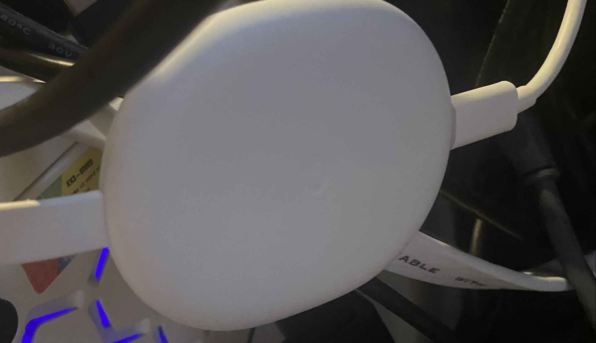

Manixx2020beyound wrote: Tue Oct 27, 2020 9:22 am I also have the google chromecast 4K dv
Is that the one with the remote? The latest one?
EDIT:
Ok, the image clear up any doubts!
