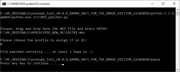

My question is: if you say you didn't use the "-mode 2" switch (which is used to generate files with profile 8 ) but only the one to discard HDR10+ metadata then why did you patch the file by assigning a profile 8?
The file cannot be patched multiple times - I recommend starting from scratch!
Use my GAMMA version and at the third and last step assign the correct profile as I explained in the previous post.
The characteristics of the final MKV file depend on the switches used in the first step.

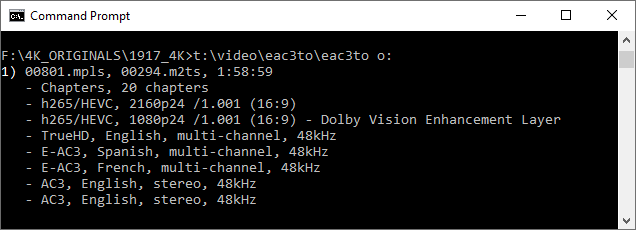

1917 is a FEL movie so you can get:
  • 1917 FEL profile 7
  • 1917 MEL profile 7
  • 1917 profile 8 (profile 8 has no enhancement layer)
All previous variants may or may not have HDR10+ (depends on whether you used or didn't use -skip_hdr10plus)

My response and yours crossed paths. (see my post immediately above).
To your questions:
  • I did use -mode 2 when producing profile 8
  • I never patched multiple times
  • I assigned correct profile depending on the switch and Title length (everything worked...)
  • I check all of the MKV files with MediaInfo - hence I was able to provide you with the results
My issue right now is that I can produce an HDR+ profile 7 or profile 8 version. I can't produce a DolbyVideo profile version at all. Am I confusing HDR+ and DolbyVision, because EAC3TO says DolbyVision on the original video, but MediaInfo says HDR+ on the original M2TS file.

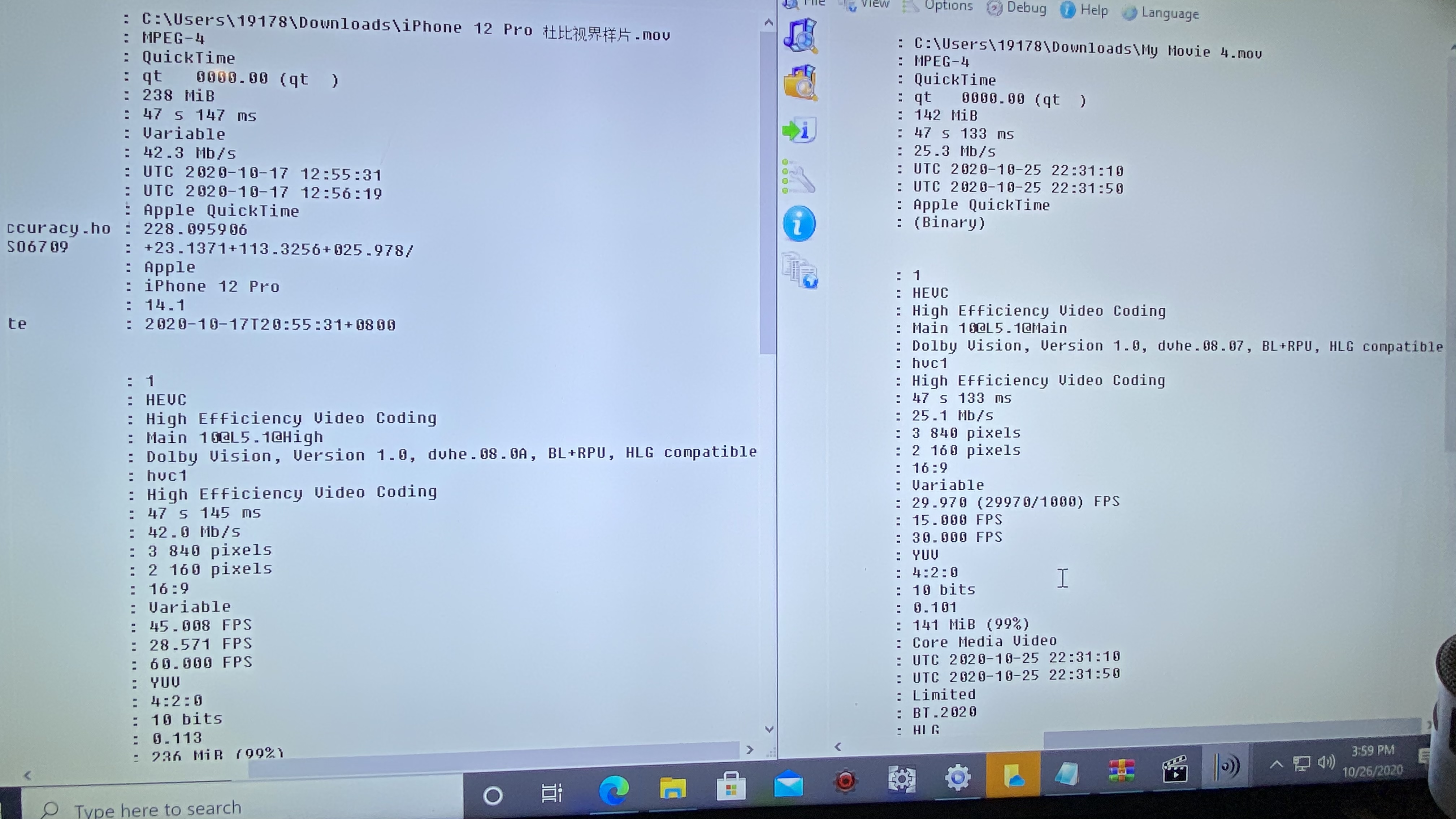

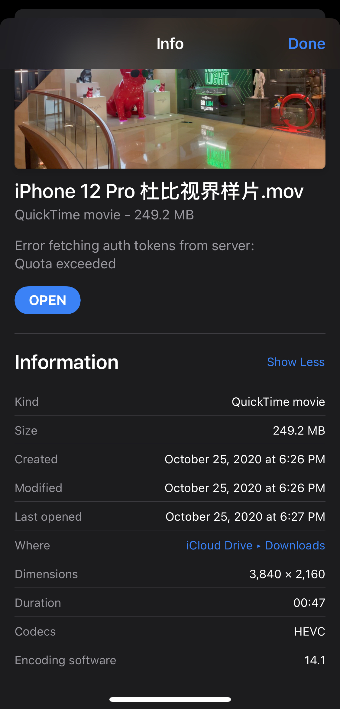

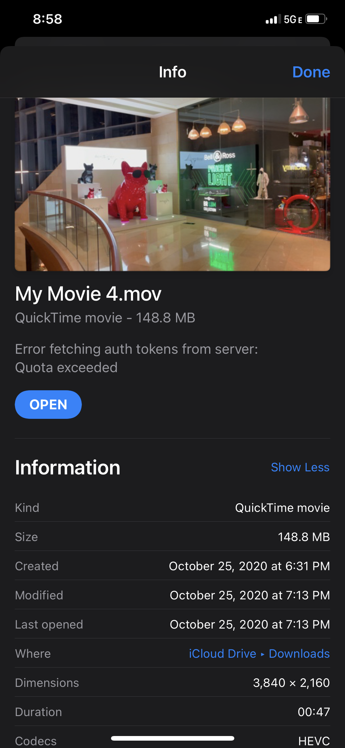

Manixx2020beyound wrote: Mon Oct 26, 2020 12:54 pm My second test is to use uhbd dual to single layer mp4 in I move to encode in doblyvision
HongyuS wrote: Mon Oct 26, 2020 3:29 pm Any iOS/iPadOS device later than iPhone 8 / iPad Pro 2017 should be able to encode and play DoVi (requires latest iOS and iMovie for iOS)
And yes, the file should be slightly different in size. Because iMovie re-encodes the base-layer and also re-calibrates the DoVi RPU.
And for further info, which @yusesope might also be interested in, iMovie re-encodes any HDR into Dolby Vision (HDR10, HLG, HLG+DoVi). I guess iMovie only generates new RPU. Old RPU data only used when decoding.
At the moment it seems to be the only correct way to encode a UHD-BD with DoVi (we should then evaluate the quality of the file obtained ... I expressed my personal opinion HERE)
Keep experimenting and if you find anything unusual, post it here.
