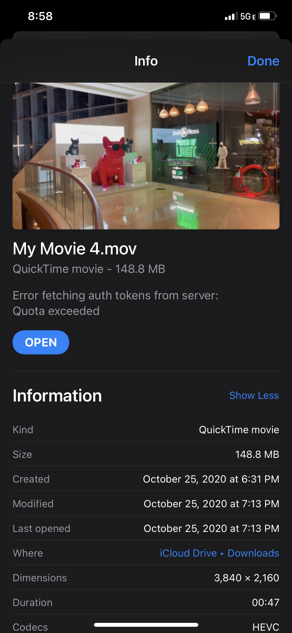

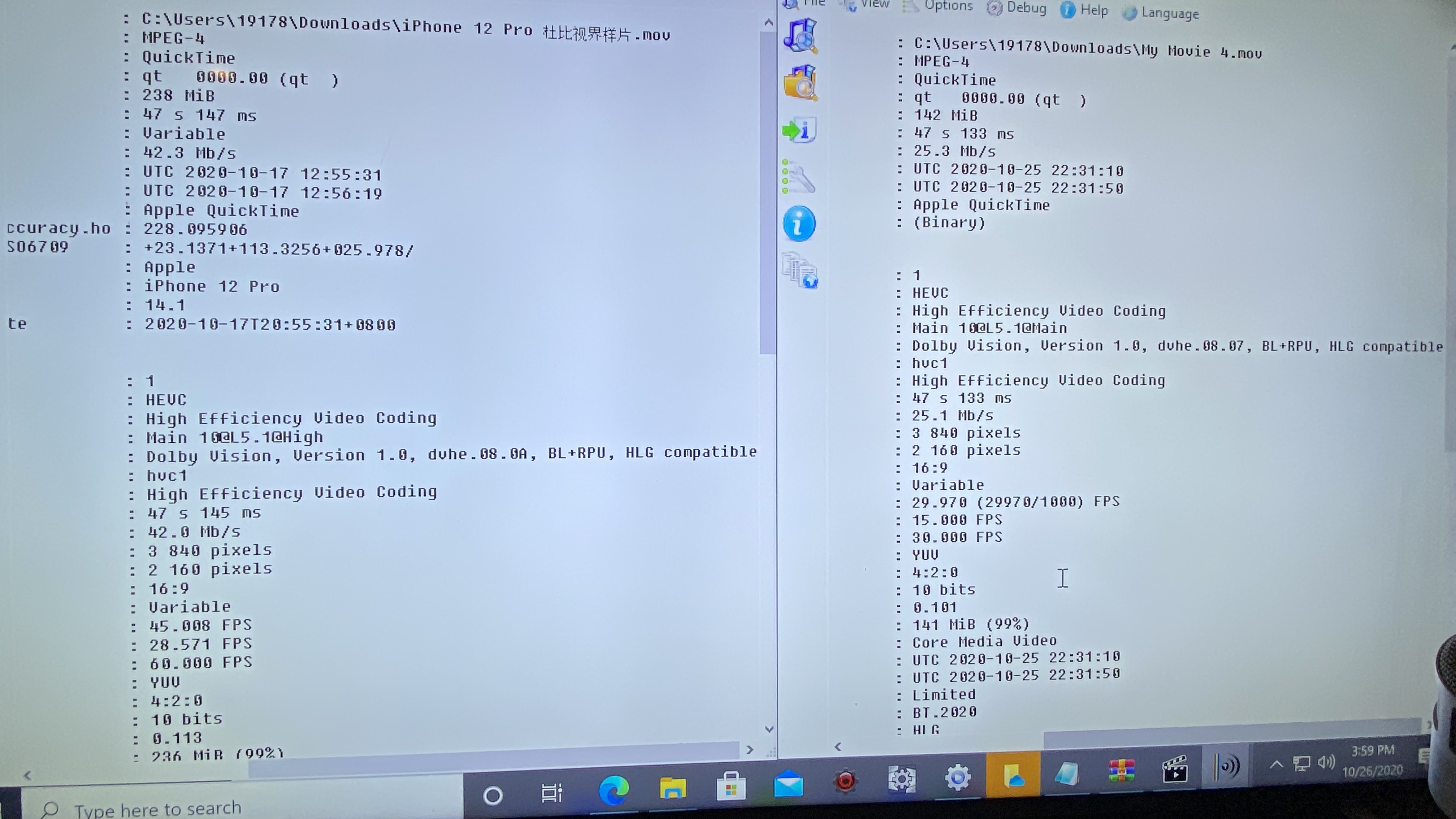

Manixx2020beyound wrote: Mon Oct 26, 2020 12:54 pm And I movie on the 11 produce a doblyvision
File slightly different from the original.
Produced an profile 8 id36 doblyvision hlg.
So I phone 11pro can encode dovi/rpu/bl
Which played in doblyvision on my dv devices.
Any iOS/iPadOS device later than iPhone 8 / iPad Pro 2017 should be able to encode and play DoVi (requires latest iOS and iMovie for iOS)
And yes, the file should be slightly different in size. Because iMovie re-encodes the base-layer and also re-calibrates the DoVi RPU.
And for further info, which @yusesope might also be interested in, iMovie re-encodes any HDR into Dolby Vision (HDR10, HLG, HLG+DoVi). I guess iMovie only generates new RPU. Old RPU data only used when decoding.

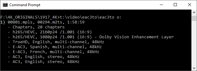

kws53 wrote: Mon Oct 26, 2020 2:16 pm It is a dual track, dual layer m2ts file from the original - see Image 1. How can I tell whether it is a profile 7 file?
Specifically: \BDMV\STREAM\00294.m2ts from the 1917 ISO [US]
Indeed - see Image 2.
I didn't use any switches other than the "-skip_hdr10plus" for my comparison.
If the m2ts file with those characteristics comes from a UHD-BD then it is a profile 7.

The input file must be a dual track dual layer profile 7 file (e.g. an m2ts file inside the decrypted folder of a UHD-BD)

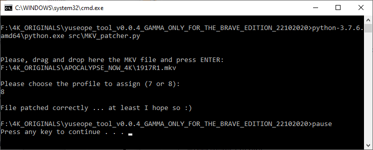

Did you use the mkv patcher as indicated in the third step (HERE)?

1) GAMMA ran flawlessly. ALL operations including the PATCH. NOTE: each file was run independently of the other - no patches on patches...
2) Since I didn't know whether I was dealing with an FEL or MEL file, and didn't know whether I needed profile 7 or profile 8, I ran multiple trials:
  1. NO additional switches, profile 7, strictly default settings and then patch. Result was HDR+ file (SMPTE ST 2094 App 4, Version 1, HDR10+ Profile B compatible)
  2. Adding the <-skip_hdr10plus> switch and then patch. As expected, the result was HDR file (SMPTE ST 2086, HDR10 compatible)
  3. <-mode 2> switch, profile 8, and then patch. Result was HDR+ file (SMPTE ST 2094 App 4, Version 1, HDR10+ Profile B compatible)
The original M2TS is indeed Dual Layer DolbyVision (see attachment below). BUT I cannot determine if the ORIGINAL M2TS has MEL or FEL. What software will determine that?
Showing Dual Layer DolbyVision
Dual Layer.png (10.85 KiB) Viewed 52612 times

  • I assigned correct profile depending on the switch and Title length (everything worked...)
  • I check all of the MKV files with MediaInfo - hence I was able to provide you with the results
My issue right now is that I can produce an HDR+ profile 7 or profile 8 version. I can't produce a DolbyVideo profile version at all. Am I confusing HDR+ and DolbyVision, because EAC3TO says DolbyVision on the original video, but MediaInfo says HDR+ on the original M2TS file.

Manixx2020beyound wrote: Mon Oct 26, 2020 12:54 pm My second test is to use uhbd dual to single layer mp4 in I move to encode in doblyvision
HongyuS wrote: Mon Oct 26, 2020 3:29 pm Any iOS/iPadOS device later than iPhone 8 / iPad Pro 2017 should be able to encode and play DoVi (requires latest iOS and iMovie for iOS)
At the moment it seems to be the only correct way to encode a UHD-BD with DoVi (we should then evaluate the quality of the file obtained ... I expressed my personal opinion HERE)
Keep experimenting and if you find anything unusual, post it here.
kws53 wrote: Mon Oct 26, 2020 8:32 pm GAMMA ran flawlessly. ALL operations including the PATCH
kws53 wrote: Mon Oct 26, 2020 8:47 pm I can't produce a DolbyVideo profile version at all
Only the latest version of Mediainfo (Version 20.09, 2020-10-09) is capable of detecting DV in a MKV container.
I sincerely hope your version of Mediainfo is up to date...
