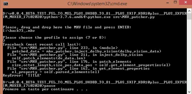

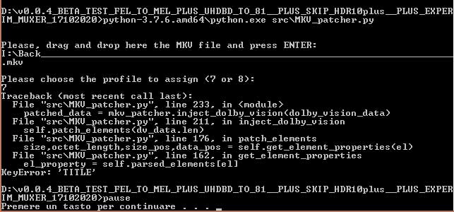

OK I got hold of your 0.0.4 beta package and did the following
  • Ran MUX_EXPERIMENTAL.bat adding in the main M2TS file from the movie 1917. I updated the script within the .bat file to
    python-3.7.6.amd64\python.exe src\app.py -mode_exp 2 -skip_hdr10plus -mux_exp
  • Imported the resultant HEVC file into latest version of MKVToolNix and added film title followed by 37 underscores. I added the M2TS file from 1917 into MKVToolNix excluding everything except Atmos audio and one subtitle track.
  • ran MKV_Patcher.bat dropping in the MKV file created and typed 8.
Unfortunately the end result MKV file does not play at all. It freezes with black screen
mediainfo below. What am I doing wrong?

blenky wrote:
Sat Oct 17, 2020 10:11 pm
No, you didn't do anything wrong!
I'm just looking for a way to save you time!
I can't directly test what I write that's why your feedback is important!
We are in a testing phase, it is normal for something not to work.
If you want a playable file, you can find the latest operating instructions HERE.
Now, I'm more than sure the experimental muxer works ...
If you feed the broken MKV file to MakeMKV (version> = 1.15.3), do you get a playable MKV?
The more practical ones could also try to use the experimental muxer by replacing the first steps of the instructions (always this POST) with it.

I am glad that both the experimental muxer and the Patcher are working correctly!
The second is still not perfect: in case it returns an error, attach the first 20 seconds of the mkv to your post so I can improve it!
