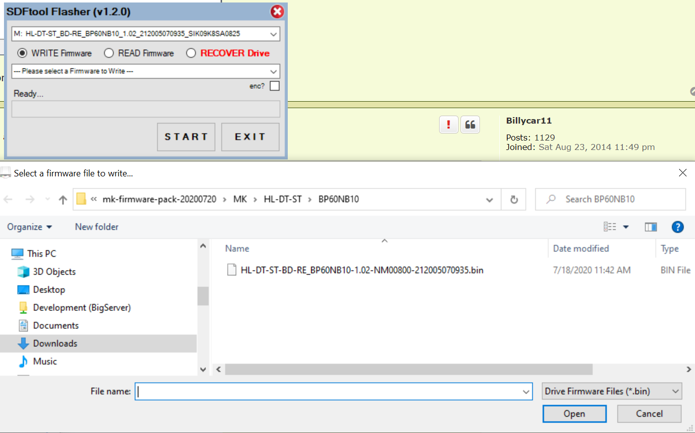

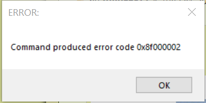

Sorry to have to bother with another trouble shooting question. I'm trying to flash my HL-DT-ST BD-RE BP60NB10. When I select the `HL-DT-ST-BD-RE_BP60NB10-1.02-NM00800-212005070935.bin` from the mk-firmware-pack-20200720/MK/HL-DT-ST/BP60NB10 folder and select the enc option (not shown in screenshot)
I'll get the following error
I tried the bin files for BP60NB10 in the old folder, but they too give me an error. Any suggestions on what I can or should do?
Below is my device information. I appreciate any help or advice any one has to offer.
OS device name: M:
Product: BD-RE BP60NB10
Revision: 1.02
Serial number:
Firmware date: 2120-05-07 09:35
Harware support: Yes
Firmware support: No
Firmware version: 1.02
