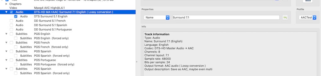

Also, I was able to hack a conversion profile for MakeMKV 1.15.3 that seems to have converted a multichannel DTS track into a multichannel AAC track (using FFmpeg) while creating the MKV file. I've tested it a single time and verified the output using mediainfo.
I created a file with the contents below named aactest.mmcp.xml and put it in ~/Library/MakeMKV/aactest.mmcp.xml
This does what seems to be some undocumented things, so there's no reason to think it'll work into the future. That said, since Sonos has made the unfortunate decision not to support DTS on the ARC, it'd be nice if a conversion profile like this became a default option in MakeMKV.
Source: Output (audio #2 has the AAC):
mkvtoolnix is available for Mac, as I have used it on mine. It is standalone and doesn't require anything else to be installed. https://mkvtoolnix.download/downloads.html Scroll down to macOS.

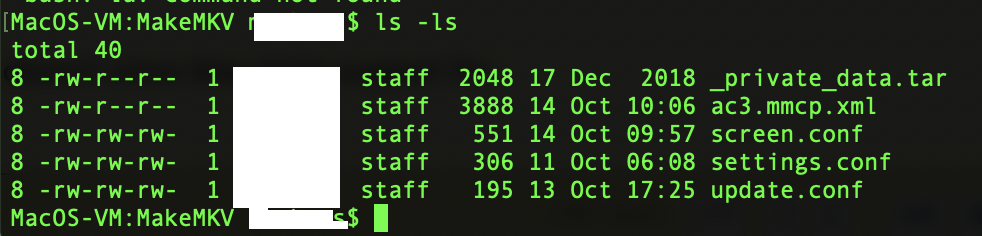

OK, so I tried this method, but I cannot select the profile aactest from MakeMKV. It just shows the default, AAC-Stereo, FLAC, WDTV. I was expecting aactest to show there.dcoke22 wrote: Tue Oct 13, 2020 3:22 pm
The file is in: ~/Library/MakeMKV/aactest.mmcp.xml

I assume you found other files in ~/Library/MakeMKV ? It is the default data directory on Mac, but the file goes in wherever the MakeMKV data directory is in MakeMKV's preferences.
Also, Finder thinks the file is a XML Document.
And the permissions are at least you get to Read & Write, staff is read, everyone is read.
And you restarted MakeMKV after dropping the file in place.
And Expert mode is turned on in MakeMKV's preferences.
Are there any interesting messages about conversion profiles in the log?

Just to add, I had a fiddle with FLAC. Look at where that profile resides: /Applications/MakeMKV.app/Contents/MacOS/../Resources/appdata.tar:flac.mmcp.xmldcoke22 wrote: Tue Oct 13, 2020 11:02 pm @Larrikin
It also shows on my screen before I click the button to make the MKV that its clearly going to change the DTS to Flac on the conversion. When I had the AC3 one loaded, it didn't

OK, so I stuffed up. My default data directory in MakeMKV's preferences was wrong and had changed from the default. The profile now shows. I'm about to go again and create the MKV. mate, really appreciate all your helpdcoke22 wrote: Tue Oct 13, 2020 11:02 pm @Larrikin
