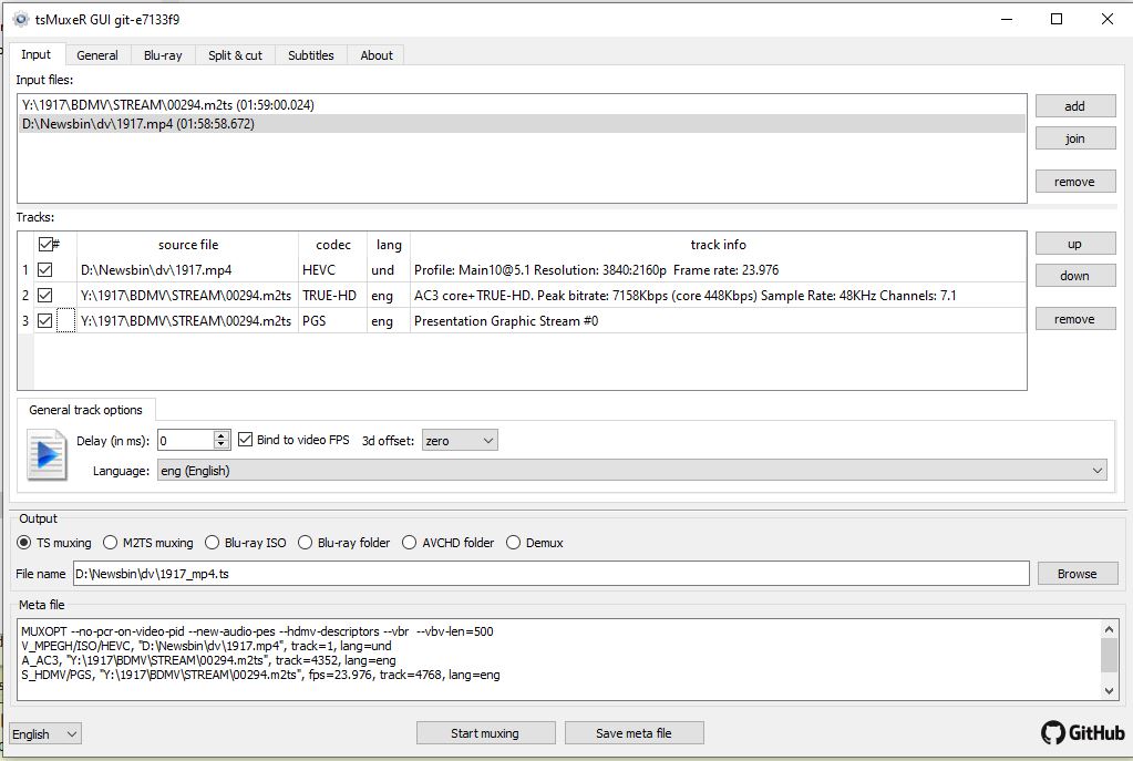

I'm testing this on my Zidoo z9X with the UHD of 1917. If I create the file as per instructions using Mp4muxer (by using Tsmuxer it only plays in HDR10) the resultant video file plays in DV. However if I then use tsmuxer to add that file and the audio stream from 1917 the output only plays in HDR10.
What am doing wrong?
Screen shot of tsmuxer attached and media info on resultant file

Hi, if you want to do .TS to play DV you have to have a modified TS muxer. If you want, I can throw it at you. Otherwise, I did an ISO Blu-ray and then made an mkv in makeMKV and I played DV on Zidoo z9x.
I have the version of tsmuxer linked in the instructions. Is that not the correct one?

Please I wanted to ask there no longer need to be used after MUX_AND_CONVERT_TO_PROFILE_81, use DEMUX step?
Thank you for the advice.
