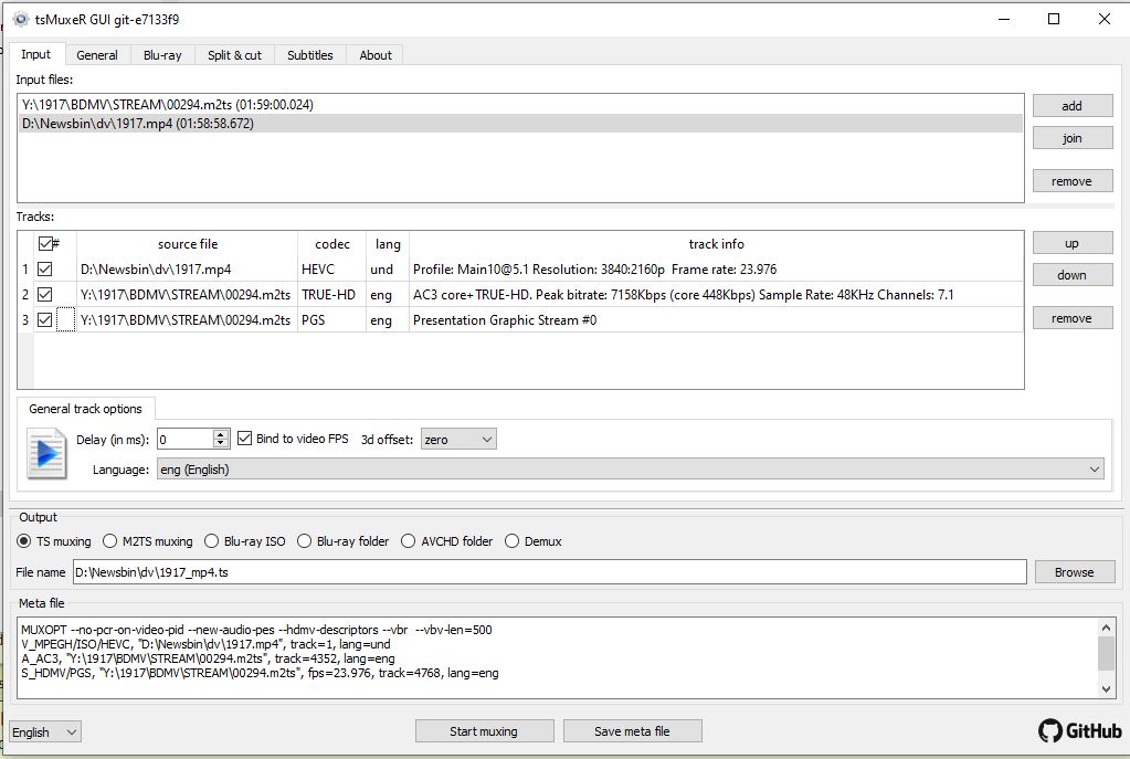

I'm testing this on my Zidoo z9X with the UHD of 1917. If I create the file as per instructions using Mp4muxer (by using Tsmuxer it only plays in HDR10) the resultant video file plays in DV. However if I then use tsmuxer to add that file and the audio stream from 1917 the output only plays in HDR10.
What am doing wrong?
Screen shot of tsmuxer attached and media info on resultant file

Hi, if you want to do .TS to play DV you have to have a modified TS muxer. If you want, I can throw it at you. Otherwise, I did an ISO Blu-ray and then made an mkv in makeMKV and I played DV on Zidoo z9x.
I have the version of tsmuxer linked in the instructions. Is that not the correct one?

Managed to get 8.1 working on Zidoo z9X by using tsmuxer to combine with Atmos audio from UHD to create ISO. Then created MKV with MakeMKV. Only thing is audio is out of sync. Need to offset audio ahead by about half a second.
Playback gets juddery after about 5 minutes - unwatchable at that point

blenky wrote: Fri Oct 02, 2020 6:32 pm Managed to get 8.1 working on Zidoo z9X by using tsmuxer to combine with Atmos audio from UHD to create ISO. Then created MKV with MakeMKV. Only thing is audio is out of sync. Need to offset audio ahead by about half a second.
hello, in your mediainfo in your audio track you have:
Delay relative to video : -2 s 836 ms
