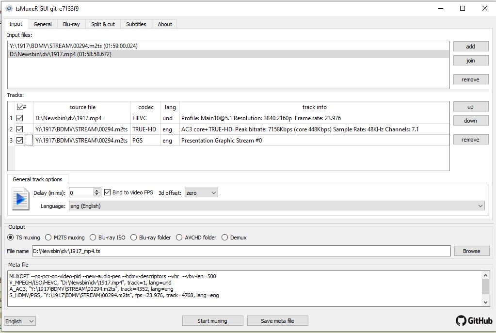

blenky
Posts: 24
Joined: Fri Oct 02, 2020 12:29 am
Post by blenky »
ghostshadow wrote: Fri Oct 02, 2020 9:55 am
blenky wrote: Fri Oct 02, 2020 12:32 am Excuse a newbie question! Do I understand correctly that the instruction in post 176 are to create the DV video file only. This would then need to be muxed with an audio track? If so what method should be used? Thanks
Hello, you can use TsMuxer
I'm testing this on my Zidoo z9X with the UHD of 1917. If I create the file as per instructions using Mp4muxer (by using Tsmuxer it only plays in HDR10) the resultant video file plays in DV. However if I then use tsmuxer to add that file and the audio stream from 1917 the output only plays in HDR10.
What am doing wrong?
Screen shot of tsmuxer attached and media info on resultant file

ghostshadow
Posts: 55
Joined: Sun Sep 13, 2020 10:25 am
Post by ghostshadow »
essaye de faire un iso avec TsMuxer et apres avec MakeMKV 1.15.3 tu fais un mkv et tu test sur ton zidoo z9x
try to do an iso with TsMuxer and after with MakeMKV 1.15.3 you do an mkv and you test on your zidoo z9x
