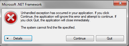

I am attempting to flash an LG WH16NS40 with 1.05 using the SDFtool flasher. When I run the .exe I get the following error:
If I hit continue, the flasher will open, but it will not recognize any drives. I have the LG hooked up via an external USB enclosure and have the latest .net framework. Any help would be very much appreciated!

rayians wrote: Sun Sep 27, 2020 2:51 pm
Do you have MakeMKV installed?
Do you have .net Framework 4.7.2 installed?

Very strange situation with my PC. I checked the .NET framework version using the cmd prompt and it shows up as 4.0.0. I tried to install 4.7.2 and it would not allow me to because it says I have 4.7.2 or later already installed.

rayians wrote: Mon Sep 28, 2020 4:31 pm
Not sure what to say here.....
You could try using the modified ASUS flasher, as long as your drive does not have an encrypted firmware on it.
