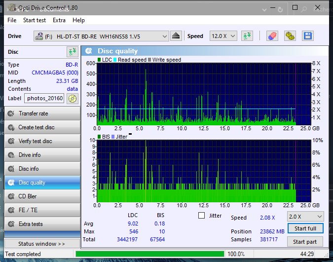

Alright, answering to myself: it works!
I received my BH16NS55 today, with fw 1.04 as expected. I flashed 1.04-MK over it, successfully, then crossflashed WH16NS58-1.V5-MK. I can now successfully scan BD-R discs!

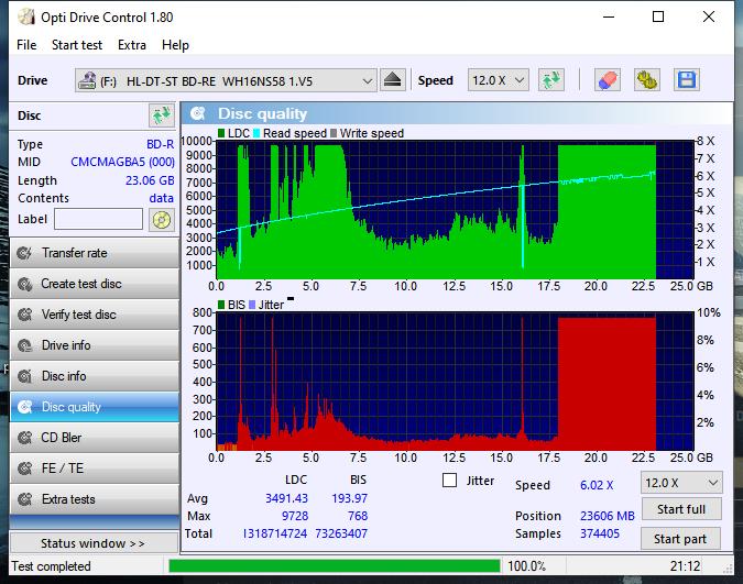

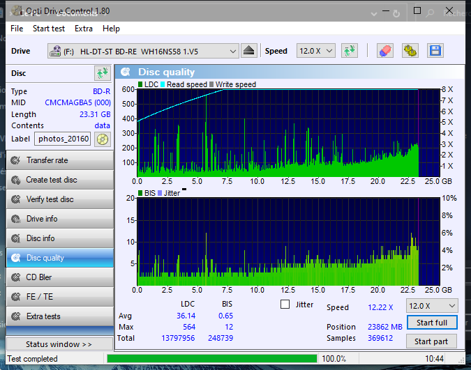

Here is a scan at normal (max) speed:
A scan at low speed (2x):
And a scan of a (badly) damaged disc:
Note that as a cool bonus feature, it does also support DVD quality scanning (PIE/PIF/POF).

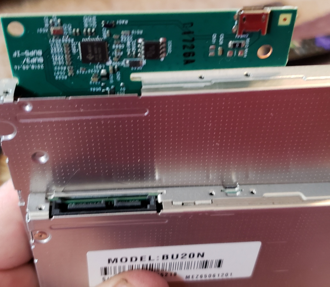

Well I thought this might be a usb bottleneck issue so I learned how to disassemble my new drive by taking apart my old drive. Once I got both apart I was faced with a drive that has an extended pcb to the charging port. Never seen that before.
Now I cannot even direct connect to my PC to try and flash the drive as the BP60NB10 does not have the SATA power or data plug present in the back.
I have tried flashing on my laptop and then my PC to no avail. I guess there is a chipset that is keeping me from flashing back.
I truly appreciate the help I have recieved. I'm going to buy a 5.25 desktop drive and an enclosure and return this junk to Newegg.
Thank you to all that helped.

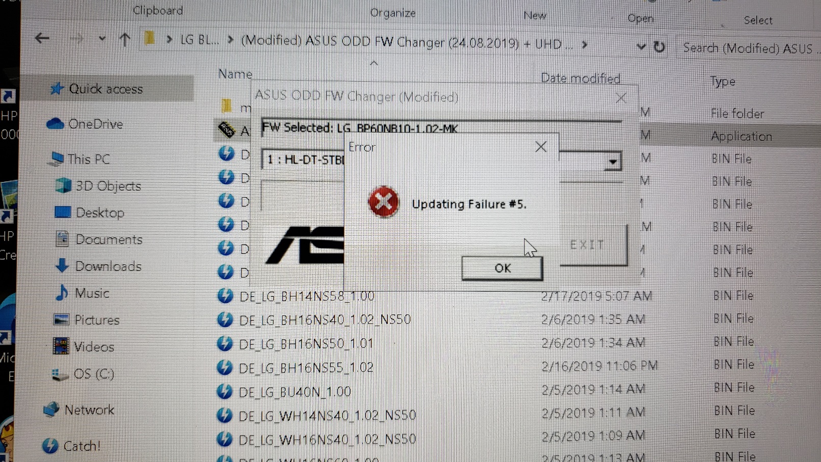

I'm lost as to why it is not flashing properly. Do you have both USB's plugged in. Make sure you do.
Also as a last ditch attempt, can you try the ASUS flasher using the same steps (1.02 MK then 1.00 MK).

Yup both plugs are always in. It's a failure number 5 when trying the modified ASUS. I'm going in order like you showed and even deleted all the files from the link and then re-downloaded them just to be sure they weren't corrupted.
The drive was manufactured in July of this year. Like I said in my previous post I think the pcb being custom and the unit not having a sata hookup is one of the issues.

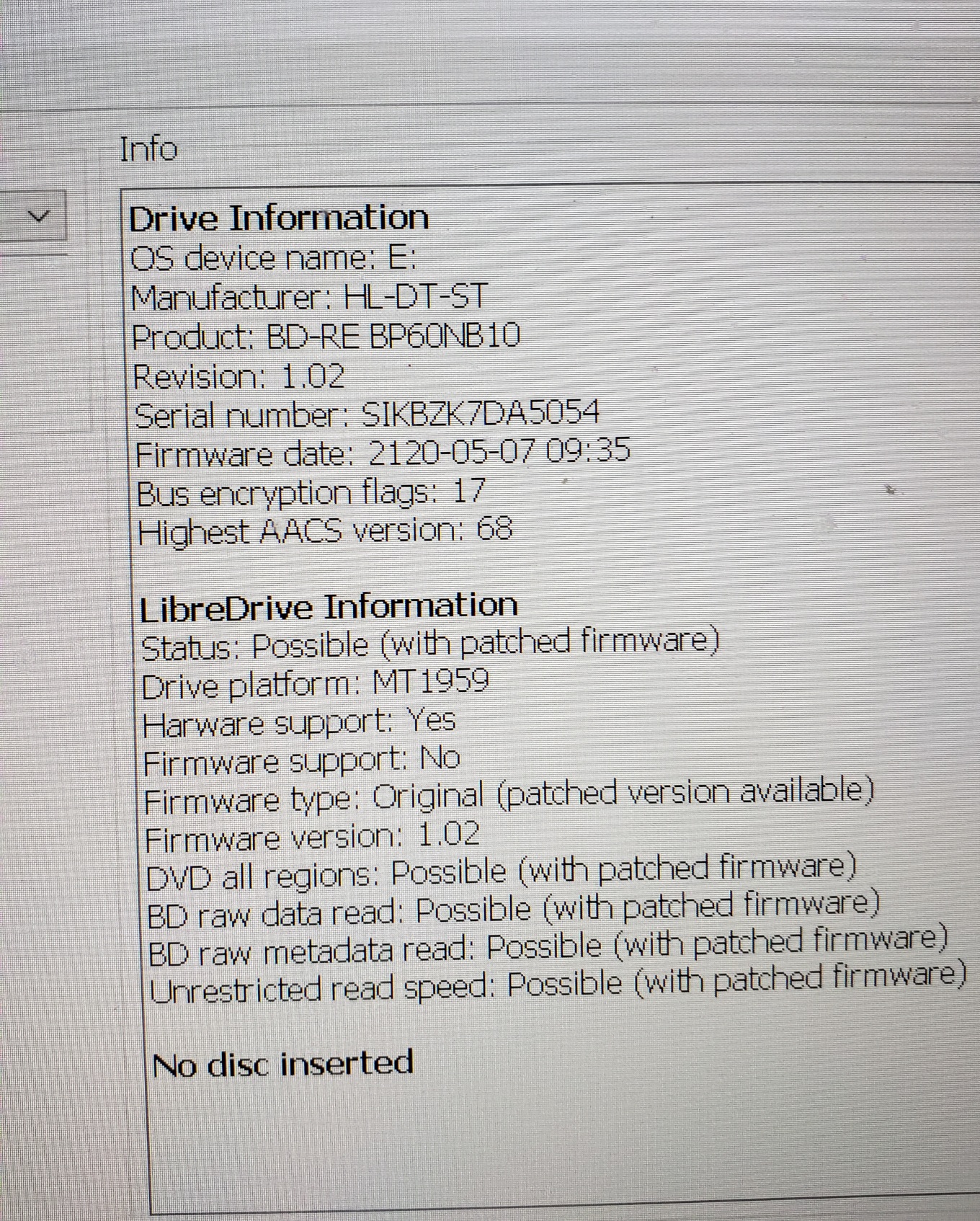

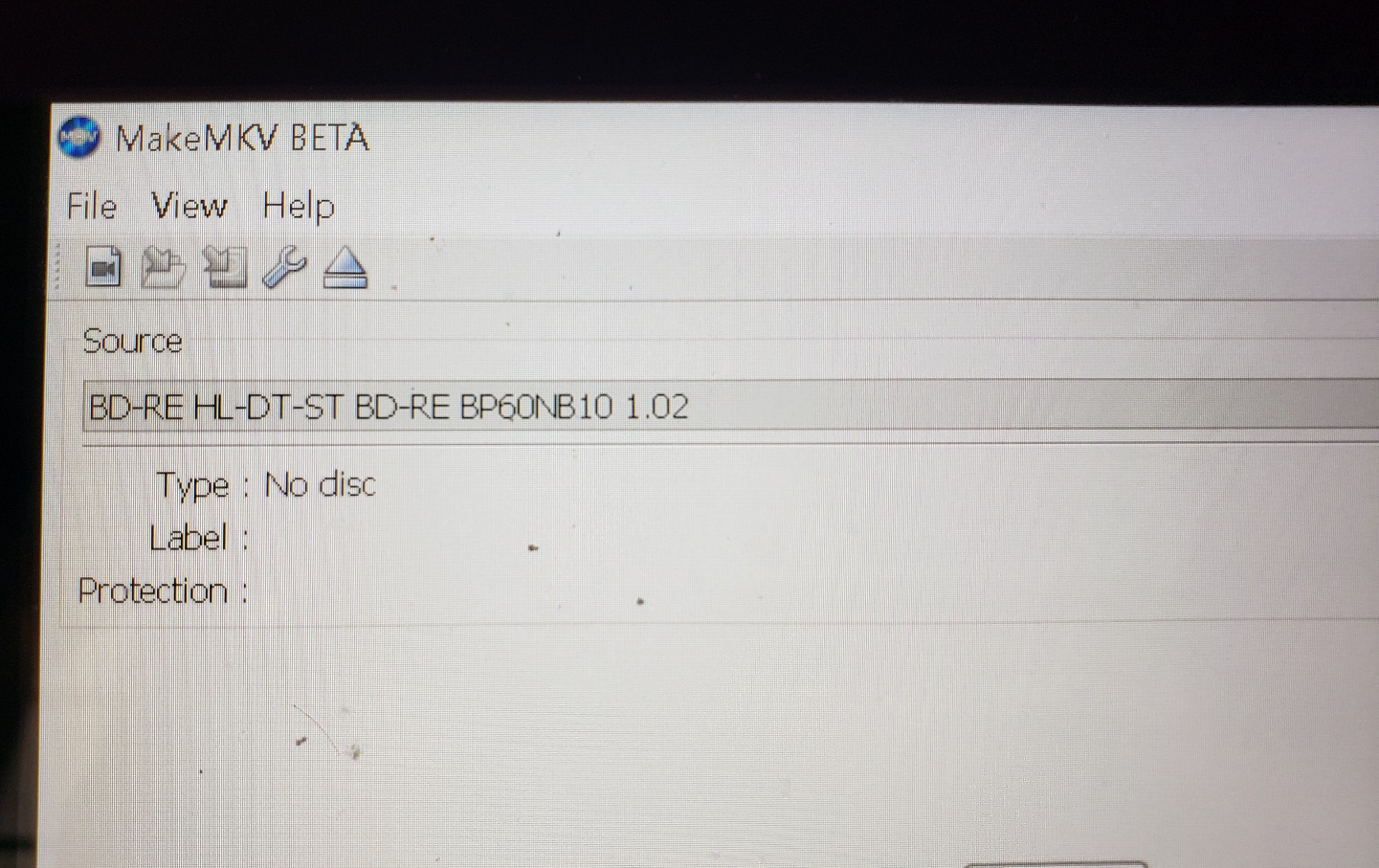

Here is the MakeMKV pics.
And again thank you for the help.
MakeMKV screen
MakeMKV screen
MakeMKV Screenshot
MakeMKV Screenshot
Posts: 2787
Post by SamuriHL »

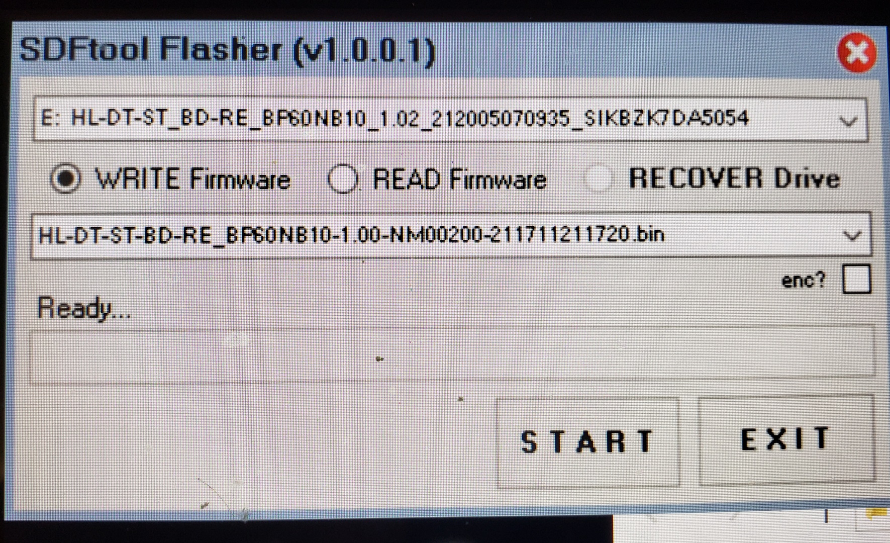

Because you have not read enough. You can't go directly to 1.00 from 1.02.

SamuriHL wrote: Fri Sep 11, 2020 11:56 pm Because you have not read enough. You can't go directly to 1.00 from 1.02.
I've followed the directions given by the OP. And it still doesn't change the fact that it will not flash at all. It fails even when attempting to go from the stock 1.02 to the 1.02 mk. Maybe you need to read a bit more.
Posts: 2787
Post by SamuriHL »
GregoryV wrote: Sat Sep 12, 2020 12:39 am
Your picture shows that your drive is on 1.02 and you selected 1.00. So, good luck.

Ok, I think I know why it hasn't worked. I just realized that your drive's stock 1.02 firmware is an encrypted firmware.
Here are the new steps for you:
1. Using the SDFtool Flasher, select firmware 1.02 MK and check the "enc" box.
2. Once this has flashed successfully, select firmware 1.00 MK and make sure "enc" is not checked.
This should do the trick and you should be on 1.00 MK.
