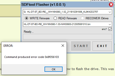

When trying to update my drive for the first time I am getting the error in the attached file. I can dump the firmware. I've tried with and without enc enabled.

Ok. Please don't flash your drive to NS60 1.03. if it came with 1.02 flash NS60 1.02 MK. 1.03 is not better in any way. Also, "enc" is not required since your drive did not come with encrypted firmware.melkore wrote: Wed Sep 09, 2020 3:06 am When trying to update my drive for the first time I am getting the error in the attached file. I can dump the firmware. I've tried with and without enc enabled.

That did it. I didn't know that the older firmware was in a different location than the latest. I only found 1.03 and figured that's what I needed. It is now flashed and currently ripping a 4k bluray. Thanks!MartyMcNuts wrote: Wed Sep 09, 2020 1:23 pm
