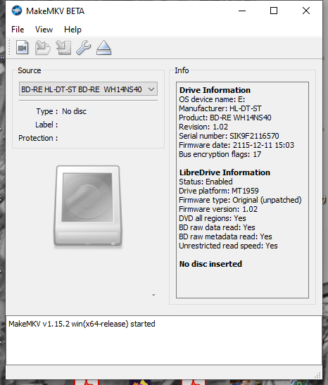

I recently bought a new LG WH14NS40, SVC code: NS50, manufactured May 29, 2020. It's connected to a SATA port on my motherboard and I'm running Windows 10 version 1909:
OS device name: F:
Product: BD-RE WH14NS40
Revision: 1.04
Serial number:
Firmware date: 2119-01-04 13:51
Highest AACS version: 66
Harware support: Yes
Firmware support: No
Firmware version: 1.04
I've downloaded the "(Modified) ASUS ODD FW Changer (24.08.2019) + UHD Friendly Firmwares + Latest MK Pack (20.07.2020)" file from the opening post in this thread, and from looking at the files in it, it looks like my options are:
DE_LG_WH14NS40_1.02_NS50.bin
Or:
HL-DT-ST-BD-RE_WH14NS40-NS50-1.05-NM00900-212005061444.bin
Or:
First HL-DT-ST-BD-RE_WH14NS40-NS50-1.05-NM00900-212005061444.bin, then DE_LG_WH14NS40_1.02_NS50.bin
Is that correct? If so, is there a consensus on which is the best way to go?
Also, are there any downsides to changing the firmware compared to leaving it as-is? UHD functionality isn't particularly important to me (though I do like the idea of LibreDrive functionality), though it would be nice to have if there are no downsides. I don't see myself buying any UHD Blu-rays unless I encounter an instance where a good transfer of a movie I want only exists on UHD, in which case I'd buy it, rip it, and re-encode it to 1080p (and de-HDR it during the re-encoding process).

Is that the "HL-DT-ST-BD-RE_WH16NS60-1.02-NM00100-211810291936.bin" file from the "old" folder? And that's better than the "HL-DT-ST-BD-RE_WH16NS60-1.03-NM00600-212005081010.bin" file in the "HL-DT-ST" folder?
By the way, I already flashed my drive with the "HL-DT-ST-BD-RE_WH14NS40-NS50-1.05-NM00900-212005061444.bin" file:
OS device name: F:
Revision: 1.05
Serial number:
Firmware version: 1.05
And it's working fine. Can it be flashed again with the WH16NS60 firmware?

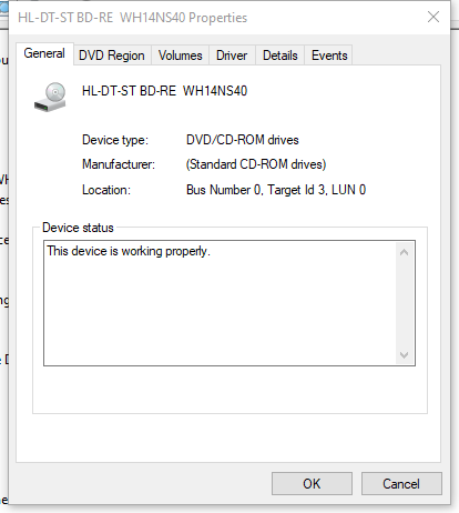

Well..... I (think I) followed the instructions. Used the video and paused it at each step as I flashed the firmware. Now, no matter what disc I through at it, it says "No disc inserted". It will control the drive. So I flashed back to the original LG firmware. Same result. Searched here to find solution but didn't see anything specific to my dilema.
Do I now have a brick? Let me know if you need more details. Jerry.

Post by MartyMcNuts » Fri Sep 04, 2020 11:32 pm
stegenga wrote: Fri Sep 04, 2020 9:50 pm Well..... I (think I) followed the instructions. Used the video and paused it at each step as I flashed the firmware. Now, no matter what disc I through at it, it says "No disc inserted". It will control the drive. So I flashed back to the original LG firmware. Same result. Searched here to find solution but didn't see anything specific to my dilema.

How old is the drive?
What SVC code does the sticker on the top of the drive say?

Thank you for your quick response. I purchased it on July 23, 2014. The case is rackmounted so I will need a gap to get into the enclosure and check the label. Will get that info to you when I do. Thank you again, Jerry.

Post by Billycar11 » Sun Sep 06, 2020 12:56 am
stegenga wrote: Sat Sep 05, 2020 8:20 pm Thank you for your quick response. I purchased it on July 23, 2014. The case is rackmounted so I will need a gap to get into the enclosure and check the label. Will get that info to you when I do. Thank you again, Jerry.
that already answers the question dont waste your time your drive was to old needed to be 2015+you didnt follow the guide requirements here: viewtopic.php?f=16&t=19634

Post by stegenga » Sun Sep 06, 2020 4:08 am
OK.Got it.
"IMPORTANT Before you flash:
1. Make sure your Drive was built after 2015"
The devil is in the details. Guess I am down to ordering a pre-flashed drive.
Thank you. Jerry.
