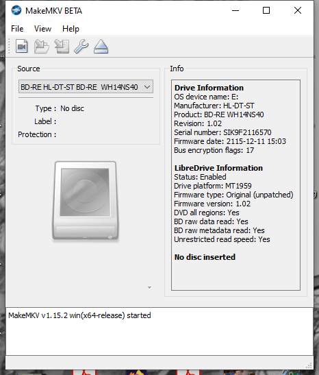

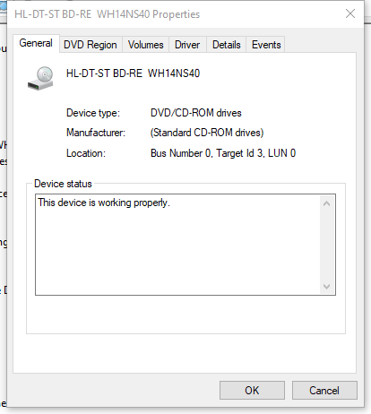

Well..... I (think I) followed the instructions. Used the video and paused it at each step as I flashed the firmware. Now, no matter what disc I through at it, it says "No disc inserted". It will control the drive. So I flashed back to the original LG firmware. Same result. Searched here to find solution but didn't see anything specific to my dilema.
Do I now have a brick? Let me know if you need more details. Jerry.
LG WH14NS40
flashed - DE_flash_HL-DT-ST_BD-RE_WH14NS40_1.02_NS50.bin 2/5/2019 6:11 PM
-after flash-
Posts: 4903
stegenga wrote:
Fri Sep 04, 2020 9:50 pm
LG WH14NS40
-after flash-
How old is the drive?
What SVC code does the sticker on the top of the drive say?
stegenga
Joined: Fri Sep 04, 2020 9:33 pm
Post by stegenga »
Thank you for your quick response. I purchased it on July 23, 2014. The case is rackmounted so I will need a gap to get into the enclosure and check the label. Will get that info to you when I do. Thank you again, Jerry.
Posts: 5803
stegenga wrote:
Sat Sep 05, 2020 8:20 pm
that already answers the question dont waste your time your drive was to old needed to be 2015+you didnt follow the guide requirements here: viewtopic.php?f=16&t=19634
stegenga
Post by stegenga »
OK.Got it.
"IMPORTANT Before you flash:
1. Make sure your Drive was built after 2015"
The devil is in the details. Guess I am down to ordering a pre-flashed drive.
Thank you. Jerry.
