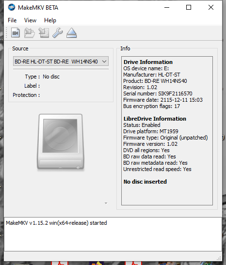

Well..... I (think I) followed the instructions. Used the video and paused it at each step as I flashed the firmware. Now, no matter what disc I through at it, it says "No disc inserted". It will control the drive. So I flashed back to the original LG firmware. Same result. Searched here to find solution but didn't see anything specific to my dilema.
Do I now have a brick? Let me know if you need more details. Jerry.

How old is the drive?stegenga wrote: Fri Sep 04, 2020 9:50 pm Well..... I (think I) followed the instructions. Used the video and paused it at each step as I flashed the firmware. Now, no matter what disc I through at it, it says "No disc inserted". It will control the drive. So I flashed back to the original LG firmware. Same result. Searched here to find solution but didn't see anything specific to my dilema.

What SVC code does the sticker on the top of the drive say?
Thank you for your quick response. I purchased it on July 23, 2014. The case is rackmounted so I will need a gap to get into the enclosure and check the label. Will get that info to you when I do. Thank you again, Jerry.

that already answers the question dont waste your time your drive was to old needed to be 2015+you didnt follow the guide requirements here: viewtopic.php?f=16&t=19634stegenga wrote: Sat Sep 05, 2020 8:20 pm Thank you for your quick response. I purchased it on July 23, 2014. The case is rackmounted so I will need a gap to get into the enclosure and check the label. Will get that info to you when I do. Thank you again, Jerry.
OK.Got it.
"IMPORTANT Before you flash:
1. Make sure your Drive was built after 2015"
The devil is in the details. Guess I am down to ordering a pre-flashed drive.
