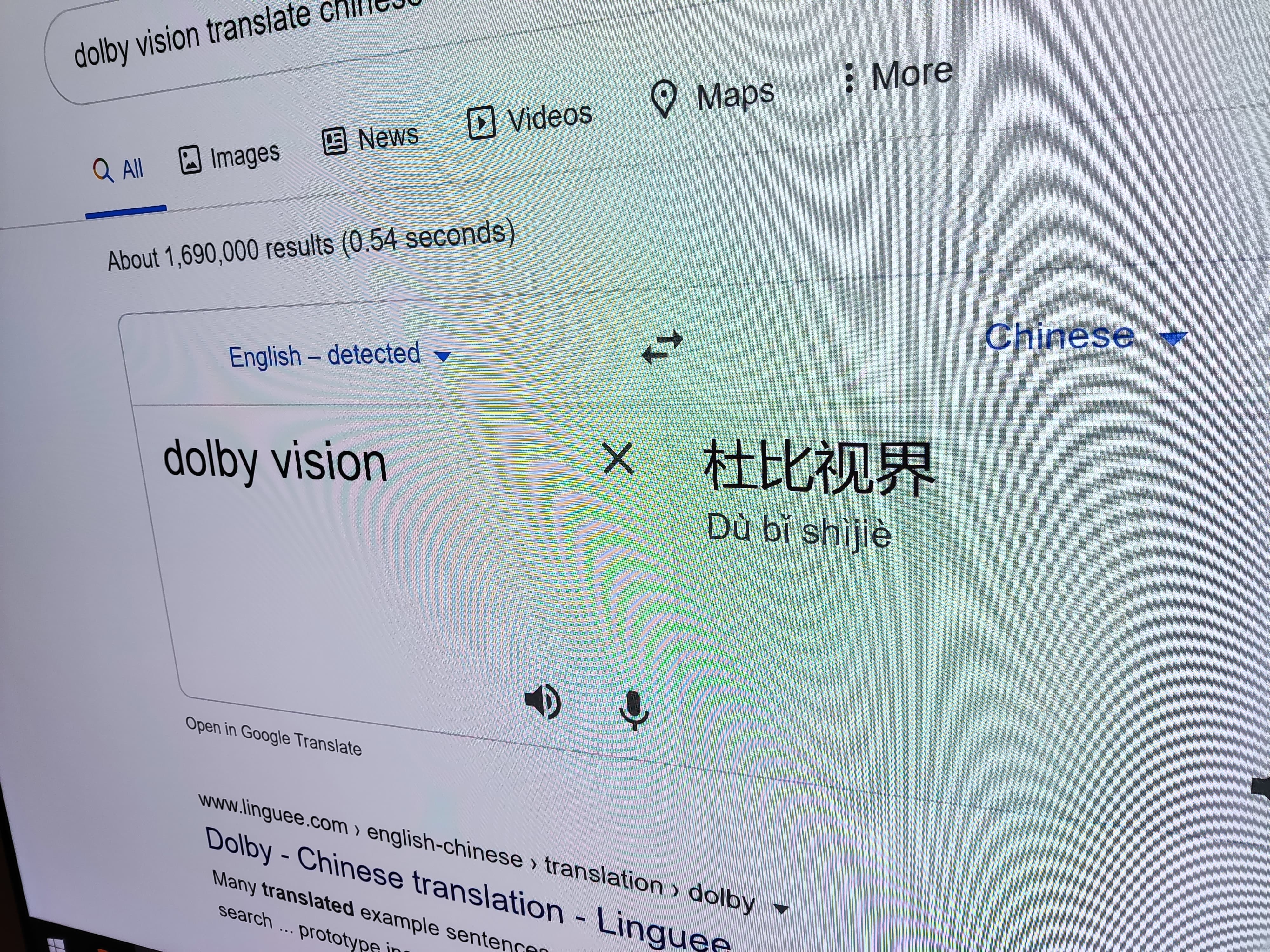

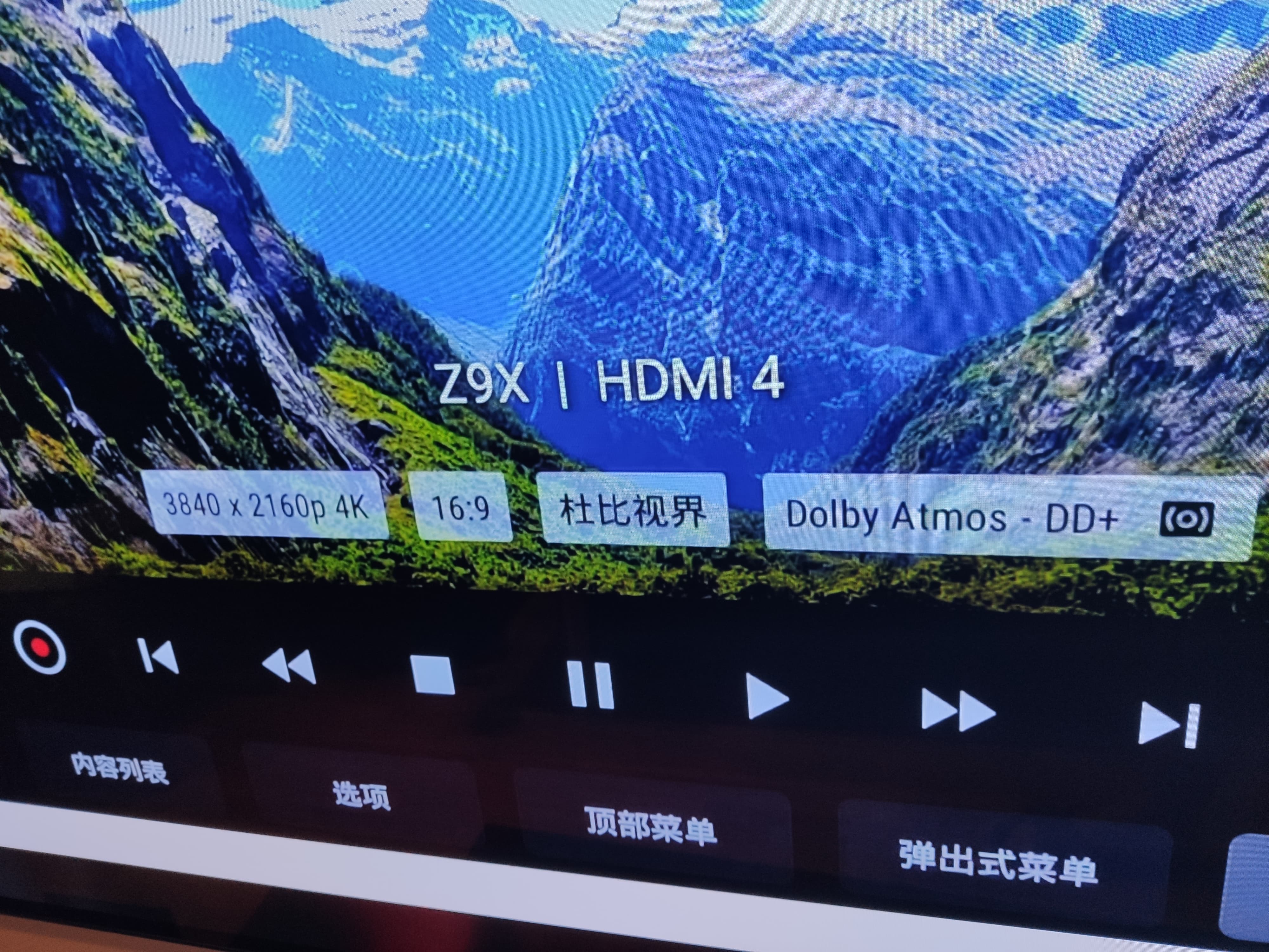

This is from the chinesse review of Zidoo Z9X
